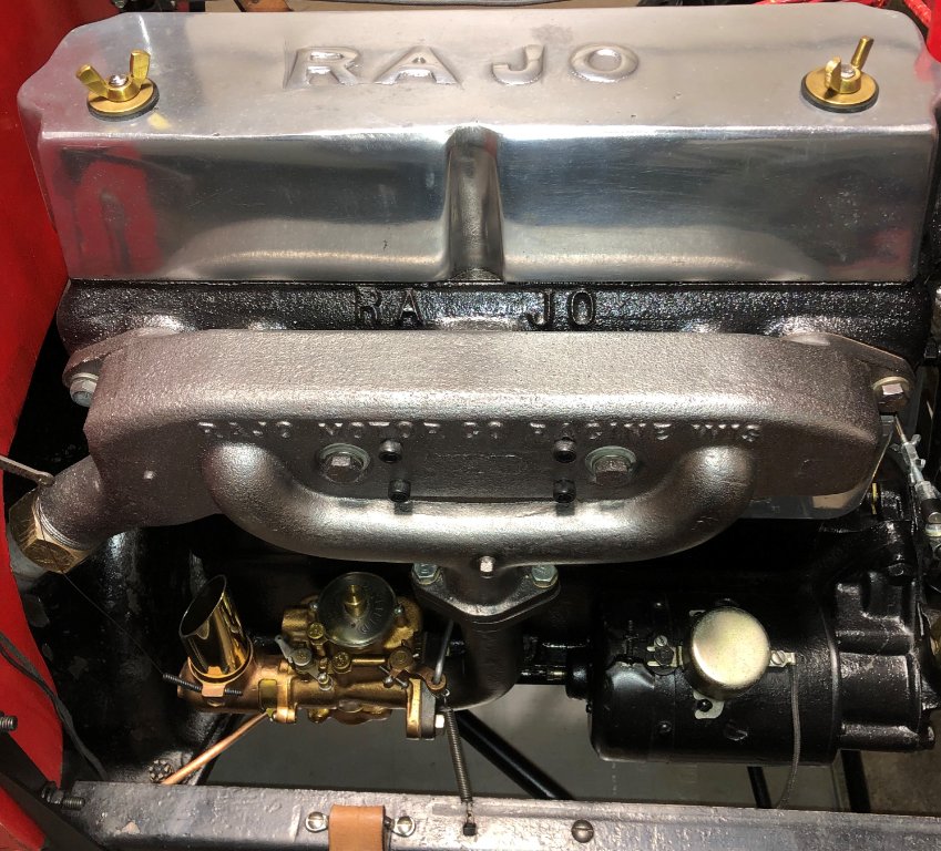

Re: Rajo B carburetor selection
We have had excellent performance from the Zenith L-6 bronze carb that is on  #2. The carb and manifold was on one of the Rajo racing engines on display at the Harrah's auto museum back in the 1960s. Somehow I ended up with that engine and as we were constructing #2 it had a B head on it and so I robbed the manifold and Zenith carb off of that engine and it has performed flawlessly with probably 7 to 10,000 miles on it. And speeds up to 100 MPH (tall gear ratio) The only hitch is starting on a warm engine, sometimes you have to crank multiple times (no starter) to get it started. Could be the design of the manifold. Zenith manual states " no Y type manifold you need a log type", and this has an aluminum Y type.

Zenith's are very good carbs and if you have the right one I'd use it. Have worked with quite a few of them on client's cars over the years and once you get them jetted correctly they work great.Reno Speedster wrote: ↑Fri Mar 04, 2022 6:46 pmThanks. I have a couple Zeniths on hand. Good advice about the log style intake.
I have an aluminum Zenith with a bolt on aluminum velocity stack, no choke, and a bronze float bowl cover that the Co. made in low production runs for racing cars in the teens. Will share photos of it here in the future.
Your typical model M or possibly an L ? Zenith bronze updraft carb as pictured on the #2 Car above. I don't know much about the model letters or sizes offered but typically are IE: 1 2 3 4 and larger.Reno Speedster wrote: ↑Sat Mar 05, 2022 2:41 pmDavid, any recommendations on which zenith would be the best choice?

While we are talking about Zenith's this is a very rare aluminum Zenith L6 carb on the engine in the photo. I purchased it from friend Josh Houlton in 2009 for use on a T racing engine I was planning to build with a Rajo BB head I took off a client's Mercury Speedster engine and later bought the head from him in 1986.
After quite a bit of research it was found to be a racing car carb, as it is different than bronze L's, and never had any provision for a choke or hot air tube and has its original large bolt-on velocity stack, and a 1.625" throat. There was a similar aviation version that had a choke flap and a provision for a hot air tube.
It was taken apart and inspected and cleaned and found not to need any other work. I'm now planning on using it on a racing engine in an un-restored 1913 "T" racing car. That engine has Fronty S-R head and a Fronty DOHC crankshaft.
