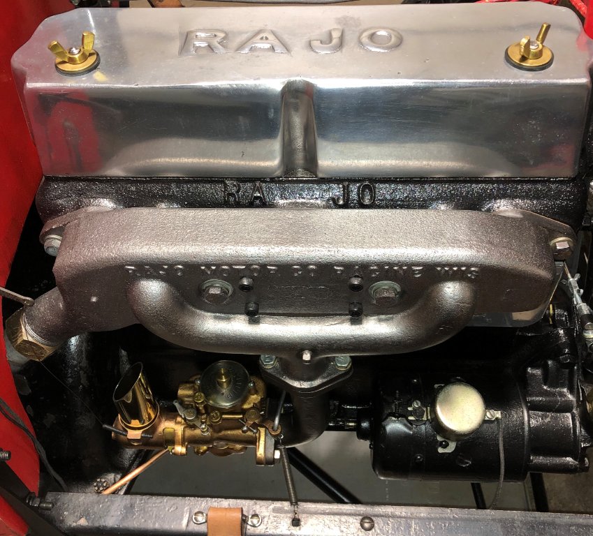

I did a search of the forum for this but didn’t really get an answer. So here goes.
Now that my Rajo B head is at the shop getting rebuilt (they confirmed yesterday that it had no cracks and are getting to work on it), I need to figure out what carb(s) to run on it.
I will need to make the intake and want to stick with 1927 and earlier equipment. I have some Zenith 04 carbs around that would need to be rebuilt and I have thought it might be cool to run a pair of them with a foot throttle. But, I don’t know if that would be a good approach.
What I am interested in finding is a setup that will run well, will not cost a fortune, or take a years long quest to find. I know this may be an impossible set of conditions but living in Alaska, it’s hard for me to find the exotic bits.
What are people running and does anyone have a solution that might fit my bill?

Here’s another nice Zenith O4 with a parts carb...
viewtopic.php?f=5&t=27030

I have one of the zeniths that was built for use on the T with the throttle body turned 90 degrees from standard, along with a cast iron zenith manifold. It’s a nice setup, but won’t work on the B. I have a couple of normal 04s that would look good as a pair (if the would fit).

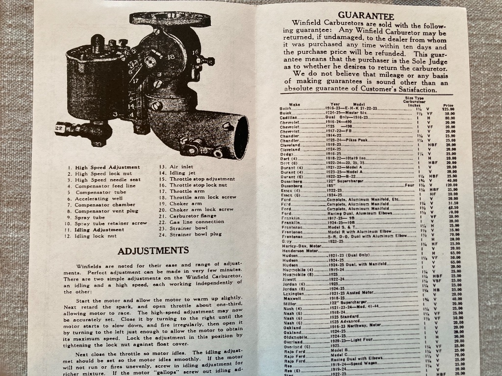

Here is a shot of a ‘25 Winfield catalog showing a 1-1/4” (5V) carb for use on a B RAJO. Or if racing and want 2 carbs, you get a pair of 1-1/2” (6V) carbs

Might look for a winfield model M, not as hard to find as the V or H, typically they are cracked due to the weight of the choke but that just gives you the option to use a simpler choke. You are probably going to want a larger single but it might be easier to find a pair of smaller.

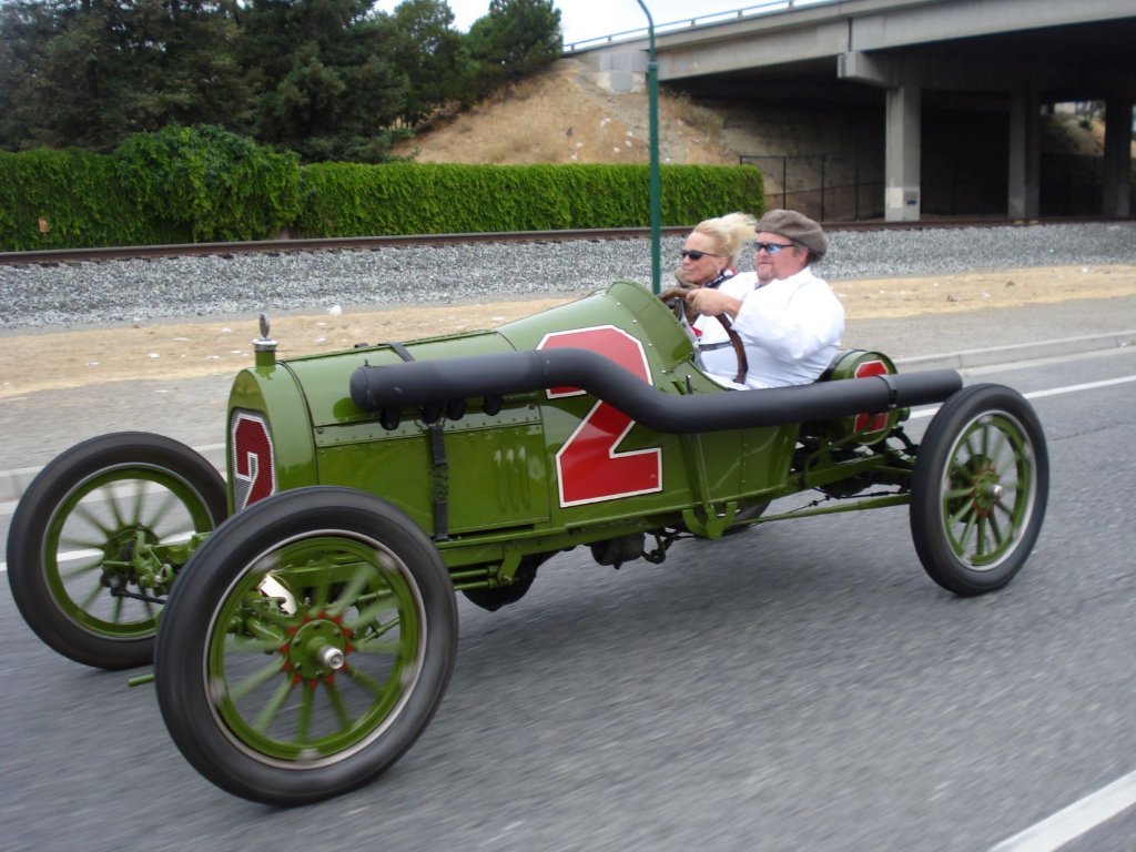

We have had excellent performance from the Zenith L-6 bronze carb that is on #2. The carb and manifold was on one of the Rajo racing engines on display at the Harrah's auto museum back in the 1960s. Somehow I ended up with that engine and as we were constructing #2 it had a B head on it and so I robbed the manifold and Zenith carb off of that engine and it has performed flawlessly with probably 7 to 10,000 miles on it. And speeds up to 100 MPH (tall gear ratio) The only hitch is starting on a warm engine, sometimes you have to crank multiple times (no starter) to get it started. Could be the design of the manifold. Zenith manual states " no Y type manifold you need a log type", and this has an aluminum Y type.
Ed aka #4

I am interested that Ed Archer indicates he runs a Zenith L-6 on his #2 car. I have checked out a couple of L-6's, and the main throat diameter measures 1.660". I have thought that likely is too much for most Model T motors, though I also recall reading somewhere that the Indianapolis car in 1923(?) ran a pair of L-6 carbs. I have also checked out several L-5 Zeniths, which have throat diameter of 1.440", and O-4's which have throat diameter of 1.180".
Certainly it depends on an bunch of other factors as to how the particular engine breathes, but wouldn't a smaller carb be easier to manage for street use? I am intrigued with how a pair of O-4's would work on a custom manifold. I am sure they would LOOK great!

While we are talking about Zenith's this is a very rare aluminum Zenith L6 carb on the engine in the photo. I purchased it from friend Josh Houlton in 2009 for use on a T racing engine I was planning to build with a Rajo BB head I took off a client's Mercury Speedster engine and later bought the head from him in 1986.
After quite a bit of research it was found to be a racing car carb, as it is different than bronze L's, and never had any provision for a choke or hot air tube and has its original large bolt-on velocity stack, and a 1.625" throat. There was a similar aviation version that had a choke flap and a provision for a hot air tube.
It was taken apart and inspected and cleaned and found not to need any other work. I'm now planning on using it on a racing engine in an un-restored 1913 "T" racing car. That engine has Fronty S-R head and a Fronty DOHC crankshaft.

Tim I think Ed was refering to the #2 car running a L-6. If I remember correctly that car used to run twin side draft linkert Or shebler carbs with a
1 1/4" or so bore. All I know is it realy runs well.

That #2 racer has always been a favorite of mine. Is it still being run?
