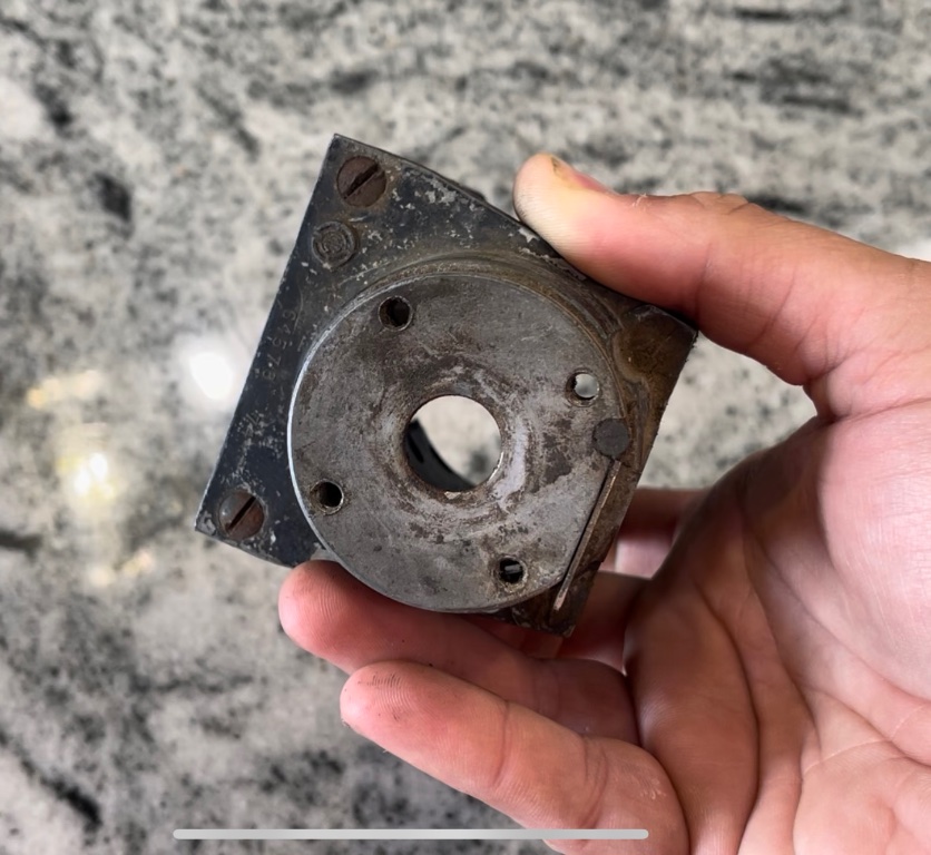

Currently disassembling the Bosch DU4 magneto and came up with some questions.
The instructions all over the internet don’t include this info it seems; but when reassembling, how do you align the gears? I notice there’s an A and C which I assume is clockwise and anti clockwise, and there’s an A and C on the interrupter housing. I’m guessing when the cutout on the interrupter is over the A or C that’s the alignment there, but where do I turn the distributor gear so that they correlate?

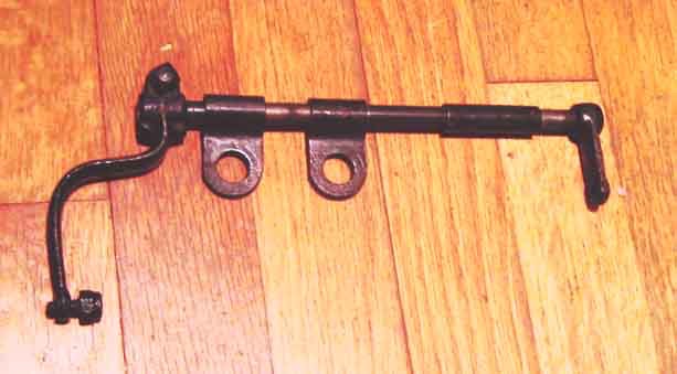

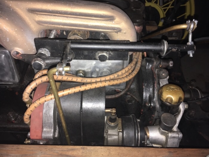

Also here are some pics of linkages and such I found searching for reference. Also, I’m curious how I will run wires with my headers in building

Idk how I will get a linkage for the timing advance though, especially with race headers, not mention I may need longer spark plug wires. Perhaps I can reroute throttle to over the block like the adaptor for a model A to use NH, and use the hole in block for the timing somehow.

I believe your timing rod still come around the front of the block, similar to the
conventional Model T timer. There should be no need to re-route that.

Indeed, I think I can make something relatively easy after looking at a lot of pictures with some bolt on parts! First thing is to get the mag working well lol.
