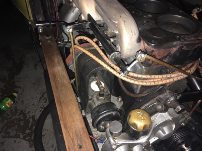

Also here are some pics of linkages and such I found searching for reference. Also, I’m curious how I will run wires with my headers in building

Idk how I will get a linkage for the timing advance though, especially with race headers, not mention I may need longer spark plug wires. Perhaps I can reroute throttle to over the block like the adaptor for a model A to use NH, and use the hole in block for the timing somehow.

I believe your timing rod still come around the front of the block, similar to the
conventional Model T timer. There should be no need to re-route that.

Indeed, I think I can make something relatively easy after looking at a lot of pictures with some bolt on parts! First thing is to get the mag working well lol.
