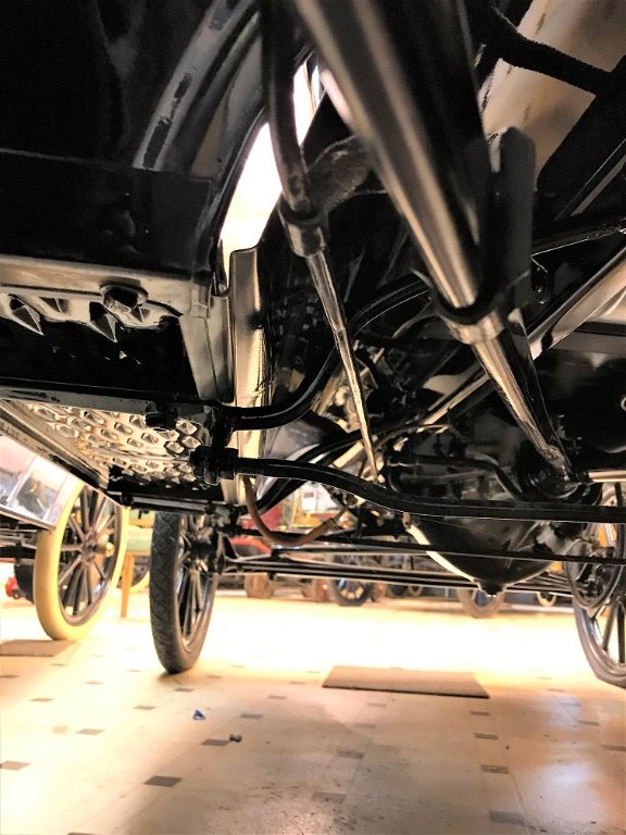

Post by TRDxB2 » Thu Jan 26, 2023 6:46 pm
Would it be possible for you to take a photo from this angle. Interested in seeing what position the brake rod support is in. If you look at the picture it looks like the hook of the brake rod support it almost positioned near where your' having the rattle.
brk rod rattle.png (395.97 KiB) Viewed 3970 times
Also it look like there is scraping in several places. If I looking at the what I think is he floorboard support rod there is an awful amount of side to side movement on it

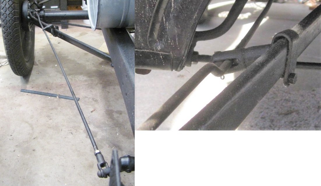

Post by TRDxB2 » Tue Feb 14, 2023 6:31 pm
Took some photos of the brake rod & running board truss rod. My immediate reaction from viewing these photos makes me think that Bryon's 14 has the wrong truss rod in the rear. The front is straight and the rear is curved to clear the brake rod. These photos show an abundance of space around the rod where it goes passes over under the running board brackets. Another possibility is how the brake rod is fitted to its support on the radius rod
There is room to spare
In this photo you can also see the front having a straight truss rod
Position of the support on the radius rod is also necessary ti keep it in place

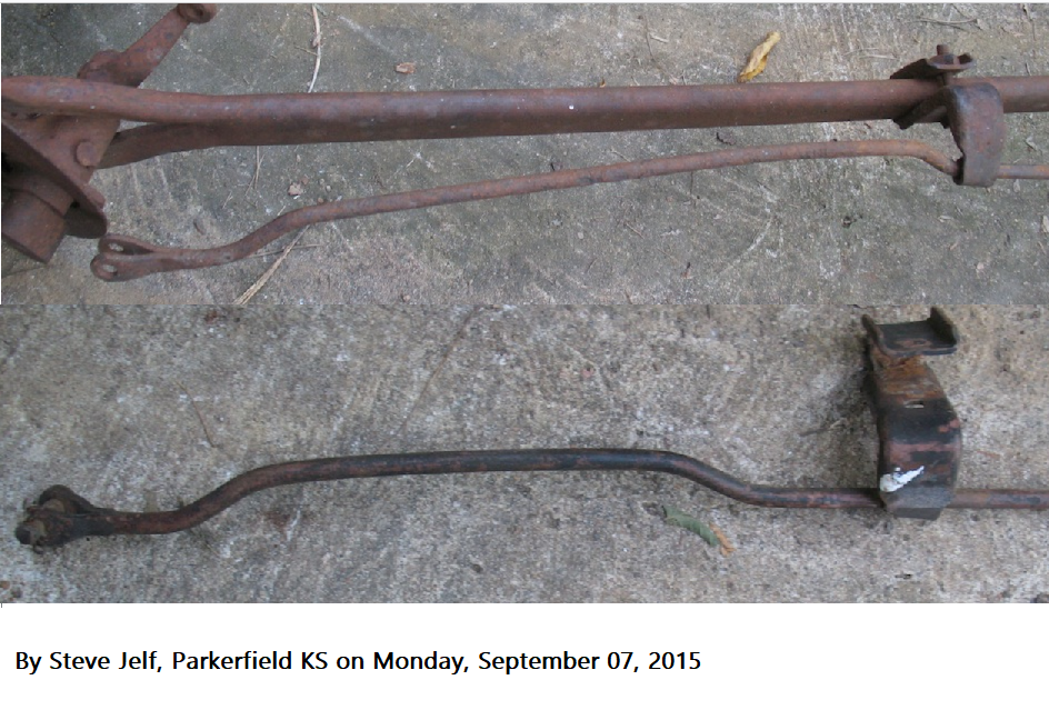

More info.... what's the brake rod look like

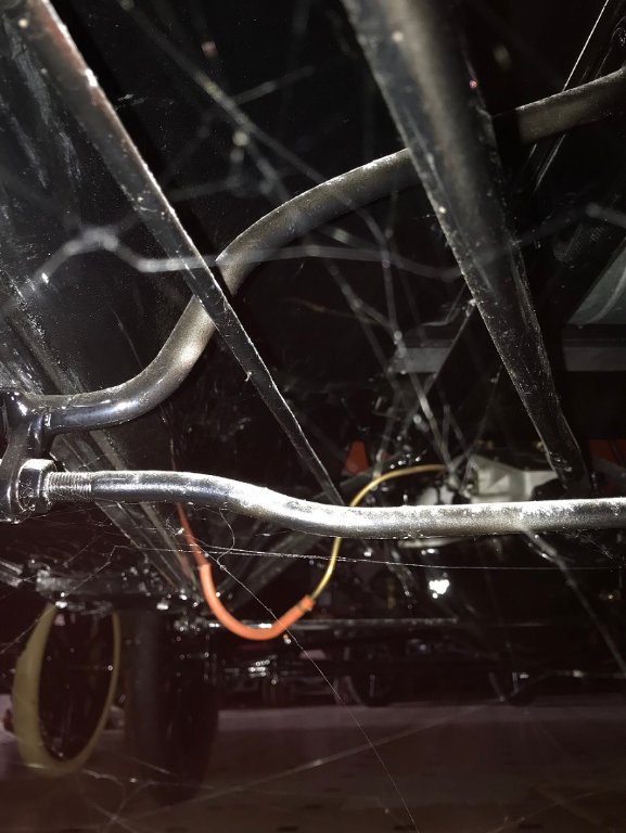

What is rattling is the Rocky Mountain brake rods against the front brace between the running boards. I have lots of clearance in the back. Here is a photo.

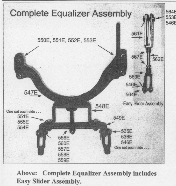

Brian, might you be able to turn the cross piece up the other way, so the eye is on top rather than underneath? That will raise the rods somewhat.

Post by bdtutton » Sat Feb 18, 2023 10:01 pm
I went back to the instructions and verified that I installed everything correctly and I did....
I tried flipping over bracket 549E per Allan's suggestion and the rods seem to clear everything and probably will not rattle anymore. I will need to adjust the brakes a little and do some real life driving to see how well this works. Will post results after I do some testing.
