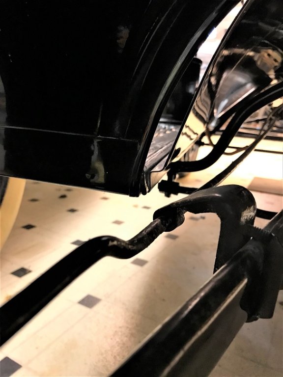

This didn't photograph very well but it is a piece of leather laced to the running board bracket where most of my rattle was. There is still some on the truss rod but not that bad. I thought it might look like something tried years ago.

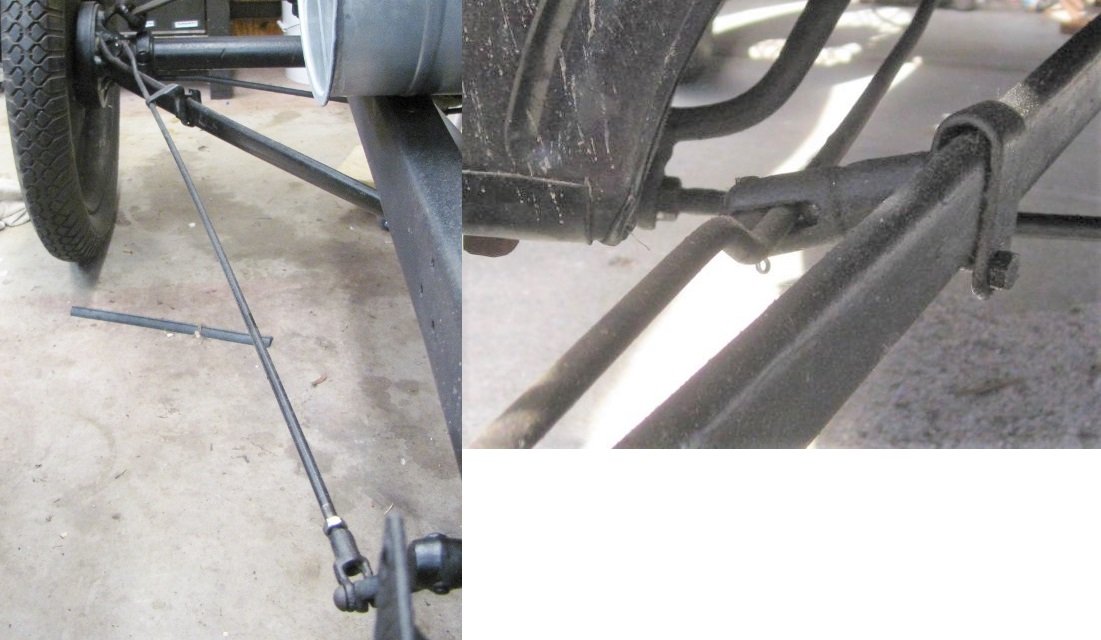

Would it be possible for you to take a photo from this angle. Interested in seeing what position the brake rod support is in. If you look at the picture it looks like the hook of the brake rod support it almost positioned near where your' having the rattle.
Also it look like there is scraping in several places. If I looking at the what I think is he floorboard support rod there is an awful amount of side to side movement on it

Frank asked, "Would it be possible for you to take a photo from this angle?" Again, it doesn't want to photograph clearly, but you can see it is closer to the running board bracket than the truss rod. When the snow melts, I'll try for a better picture.

What I am trying to see where the brake rod support bracket is and how much clearance there is when its rapped around the brake rod. The lateral wear pattern on the truss rod just seems to excessive if the rod was properly secured. Now they sold accessories to minimize the rattle in the stock bracket.

Re: Anti-rattle ideas for brake rods
Took some photos of the brake rod & running board truss rod. My immediate reaction from viewing these photos makes me think that Bryon's 14  has the wrong truss rod  in the rear. The front is straight and the rear is curved to clear the brake rod. These photos show an abundance of space around the rod where it goes passes over under the running board brackets. Another possibility is how the brake rod is fitted to its support on the radius rod
There is room to spare --
In this photo you can also see the front having a straight truss rod --
Position of the support on the radius rod is also necessary ti keep it in place

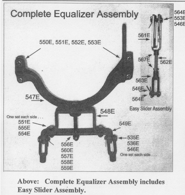

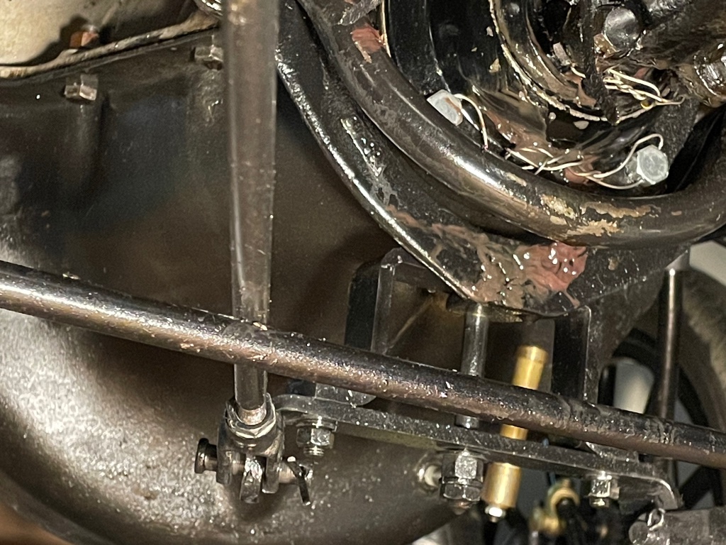

What is rattling is the Rocky Mountain brake rods against the front brace between the running boards.  I have lots of clearance in the back.  Here is a photo.
- Posts: 6947
Brian, might you be able to turn the cross piece up the other way, so the eye is on top rather than underneath? That will raise the rods somewhat.
I went back to the instructions and verified that I installed everything correctly and I did....
I tried flipping over bracket 549E per Allan's suggestion and the rods seem to clear everything and probably will not rattle anymore. I will need to adjust the brakes a little and do some real life driving to see how well this works. Will post results after I do some testing.
