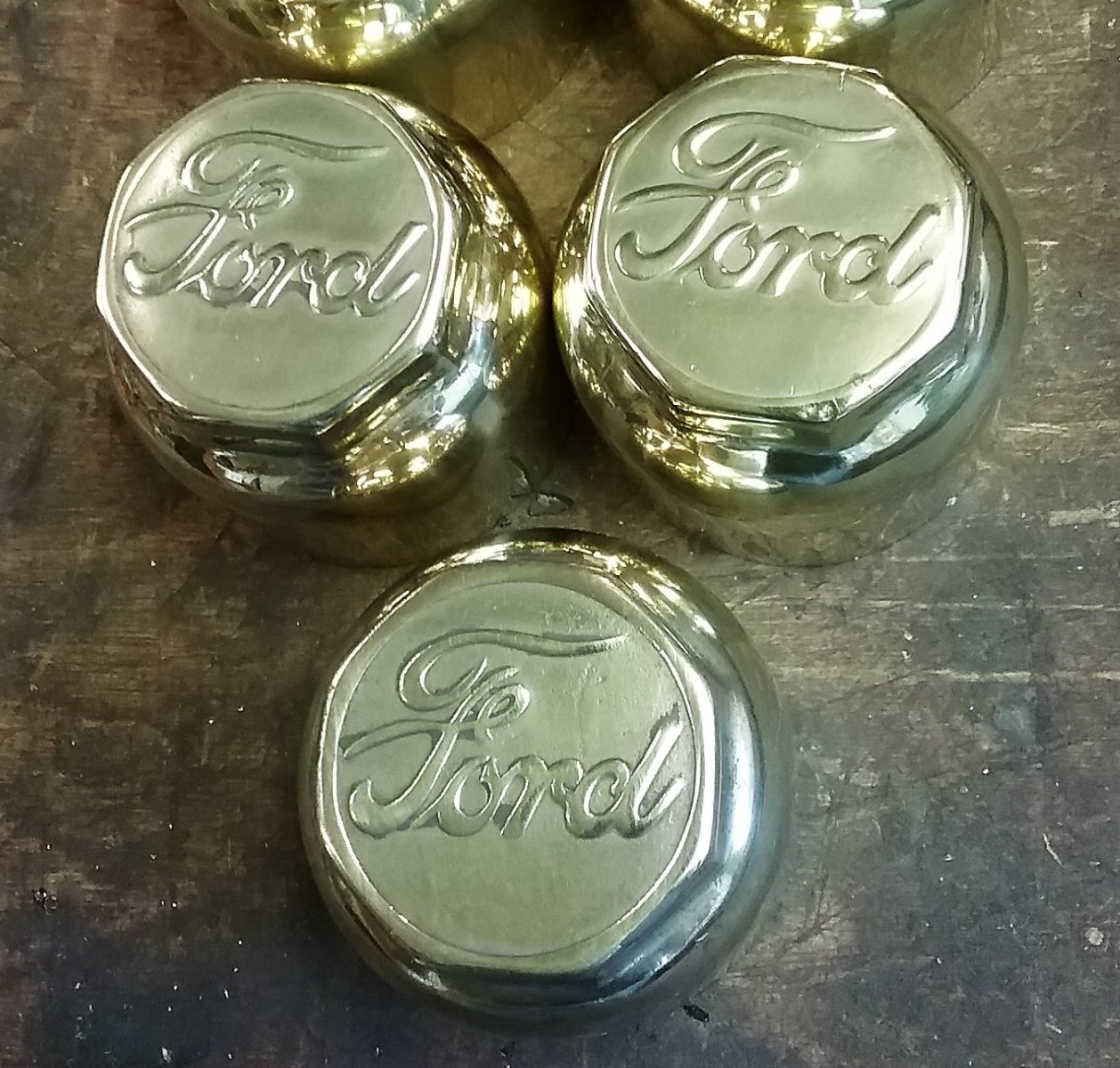

Post by KWTownsend » Sat May 04, 2019 12:23 pm
Art-
These are the hubcaps that Tim is talking about:
I have a set of these for my Oct-Nov 1911. The background will be black oxidized, not painted.
If you look at original photos from the era it is hard to identify what type are on the cars. I have seen many late 1911s (like Phil Mino's) that have the early 1911 style hubcap.
You mileage may vary.
Keith
