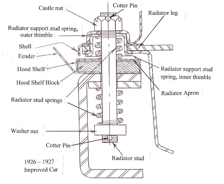

Good job. Front fender, splash shield, running board, rear fender. Do you have the original screws that secured the fenders to the splash shield? If not, You can see pictures of the original bolts, washers and nuts in this old thread I posted in 2010.
www.mtfca.com/discus/messages/118802/17 ... 1289527358
Bolt loosely or clamp until everything is lined up and when positioned properly, tighten. There should be holes in the upper flat portion of the splash shield to screw the splash shield to the wooden blocks with wood screws. Secure this after everything else is secured.
Here is a diagram of the sequence of installation of the front fender, radiator, radiator shell, hood shelf, etc. Jim Patrick
