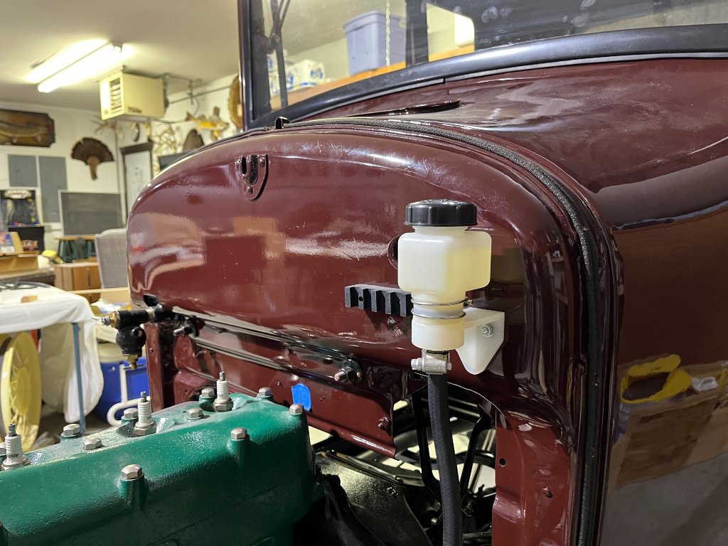

The body and frame are finally back together. One big step in the restoration of my coupe.
What sequence do the plash panels, fenders, and running boards go back on?

NYJohn T has a good idea that I did on 24 Coupe rebuild. Getting the engine put together, radiator on, fitting the hood, and the running gear completed. Laying in the headlight and tail light wiring, ignition wiring and etc. Then get it running. All that getting taken care first and installing the splash shields, any interior work and then the fenders. Your done!
- Posts: 7279
Re: Body and Frame Back Together
What a beautiful job! I love the paint colour. You should be proud of it. Except for the plastic thingy on the firewall.
