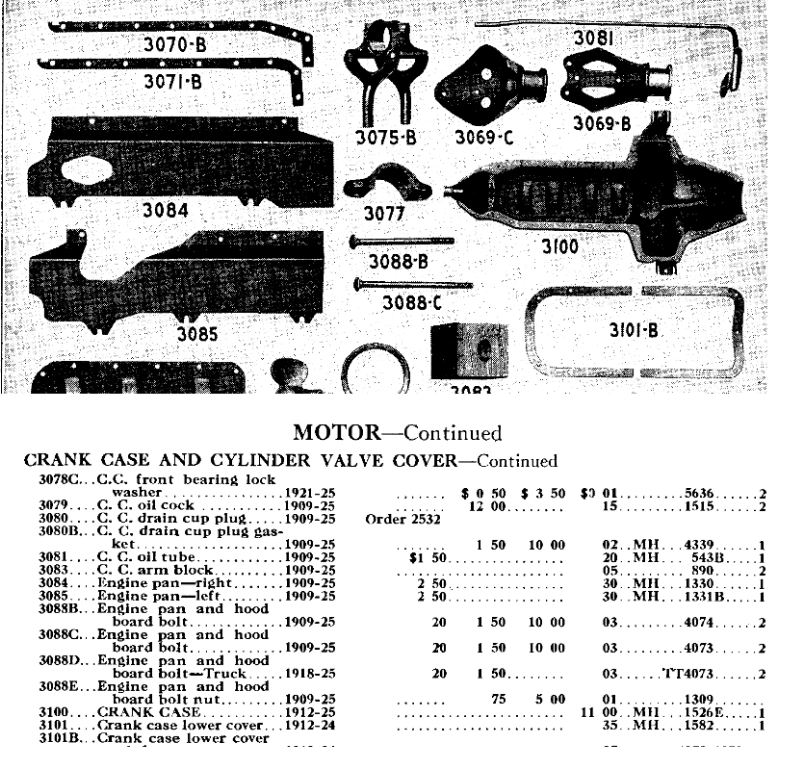

I have a pair of engine splash pans that have been laying around in the shop that I am going to put on my 22. But, I can’t find any pictures of how they mount on the frame. Can anyone show pictures or give advice on how they mount? Thanks.
- Posts: 5268
Re: Mounting engine splash pans
Hold them in place. There are 2 outer tabs that mount to the hood shelf bolts under the frame.
Mounting should be obvious. They are a PITA to mount to the pan bolts. You will need a friend to help.
You will soon learn why "everybody" left them off after the first engine pull.

They sit flat. Hold them up to the bolts where the pan connects to the block and line up with the curve of the pan at the front of the engine. The chassis side should line up with holes made for the splash pans inside the channel of the frame. Again. They sit perfectly flat. Jim Patrick

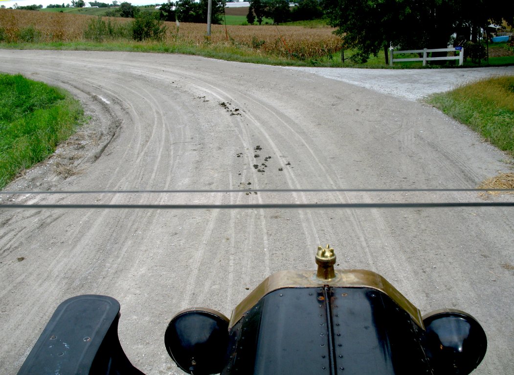

They might have been helpful on the old muddy dirt roads with puddles etc. Between the carburetor air pipe and the splash aprons less likely to get mud or water in the carb. They don't seem to be necessary on our modern roads. And if you are like me, i try not to drive in rain unless I happen to get caught in a quick storm unexpectedly.
OK, explain this to me...by 1930 major high ways with macadam or concrete are being constructed as a result of lobbyist wanting better roads. Most towns and cities have paved streets.
And just from observation a majority of finer automobiles have engine splash pans, for their engine compartment. As an example our 1931 Packard Coupe and the 1939,1940, and 1941 Packard touring sedans have engine splash pans.
Was the removal and aversion of the Model T engine splash pan the result of lazy mechanics?
The family 1922 Coupe, over 50 years ownership, has a set of pans with no issues to repairs and adjustments.

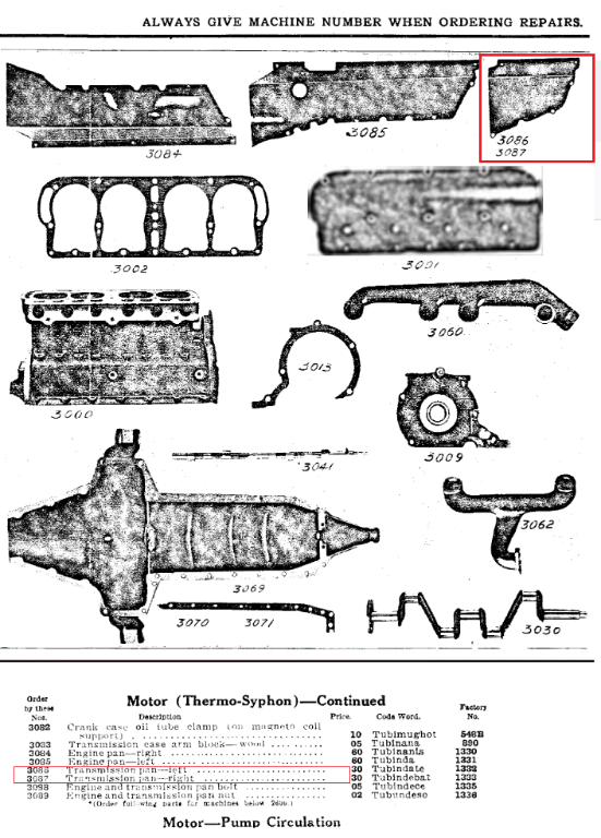

- Posts: 6805
using the title of a parts page as evidence of what a thermosystem is comprised of, then I suppose the crankshaft is part of the system, tooThe pan are part of the thermo-syphon system!!
FWIW - the parts circled are transmission pans and were dropped from production with the introduction of the 1915 model year...a very uncommon part to find in the wild.

Rich P. Bingham
- Posts: 1814
- First Name: Rich
- Last Name: Bingham
- Location: Blackfoot, Idaho
Scott_Conger wrote: ↑Tue Feb 28, 2023 11:19 am. . .
I learn a lot from these kinds of discussions; nothing about Model T's, but still, lots.![]()
I'll bet the owner of this car was glad it had splash pans ! (he probably wore goggles, too !)

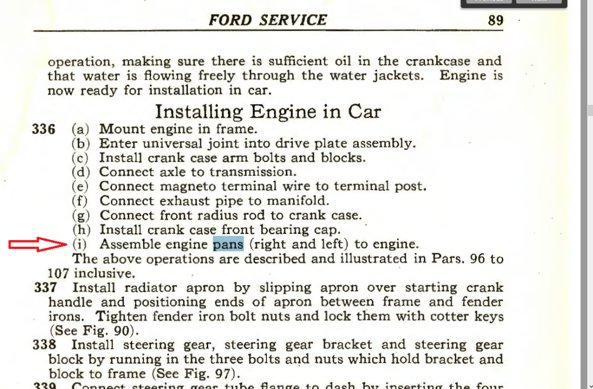

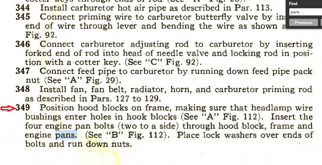

"The Ford service manual in paragraphs 23 and 24 refer to the pans as engine pan left and engine pan right. If there is any mention of the pans besides these I overlooked it. I didn’t find any reference to reinstalling them so I guess it was a non issue for Ford. If it was it would have been in the manual."
See Ford Service Manual "Installing Engine in Car: Paragraph 336 (i) Assemble engine pans (right and left) to engine."

jab35 wrote: ↑Tue Feb 28, 2023 9:33 pm"The Ford service manual in paragraphs 23 and 24 refer to the pans as engine pan left and engine pan right. If there is any mention of the pans besides these I overlooked it. I didn’t find any reference to reinstalling them so I guess it was a non issue for Ford. If it was it would have been in the manual."
Yes, Ford Service notes to install the engine pans on overhaul of the motor!
See Chapter III, Major Engine Overhaul
para. 326 Installing Engine in Car
And also:
Check out Chapter XLII, the Improved Car, removing front fenders para. 1134 run off nuts on engine pan bolts (Fig. 524 "C") and then to install fenders, para. 1143, insert two engine pan bolts in hood block, frame, and engine pan (Fig. 524 "C"), so the pans are to be in place, even if changing out the front fenders.
Improved Car right pan, later double hole, for either NH drain bowl or Vaporizer drain bowl.
Here is a copy of that page --
and further down the page - note the number of bolts to be used
