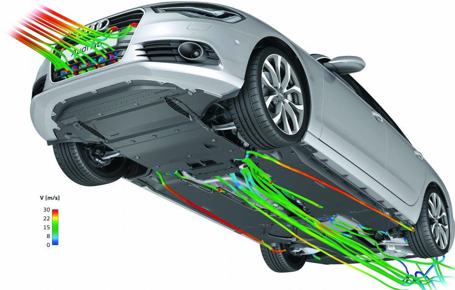

The engine splash pans can be considered part of the cooling system. By enclosing the engine compartment a negative pressure zone is created while driving . As air passes through the radiator the air flow over the top of the hood's louvers creates a vacuum and air is pulled out from the enclosed compartment allowing more air to flow through the radiator. When they are remove the air is pulled from under engine and less from through the radiator. I often wonder how many T's with heating issues have the pans removed vs on.

Posts: 6581
Re: Mounting engine splash pans
Post by TRDxB2 » Sun Feb 26, 2023 12:18 pm
TXGOAT2 wrote:
Sun Feb 26, 2023 11:43 am
Model As also came with splash pans. I don't think Ford would have gone to the trouble and expense of manufacturing, handling, and installing them if they had no function other than to annoy mechanics.
You are absolutely correct. I explained it above as being part of the cooling system. That explanation goes along with why Hot Roders louvered their hoods and why modern cars have pans under their engines now. Without the pans air turbulents result and the the negative pressure zone is defeated

Post by John Codman » Mon Feb 27, 2023 11:54 am
I would seriously doubt that the splash pans have much to do with our 35 mph 20 hp Model T underhood aerodynamics. In a modern car I would agree with that premise, but in the case of the T I think that the splash pans are exactly that - splash pans to keep water out of the timer, coils, and cloth-insulated wires.
Taking the opposite side with modern cars, there is considerable thought given to airflow under the hood. When I lived in Massachusetts, I got a huge kick watching the state troopers (natives call them "staties") sitting in their cruisers in the summer watching the construction site - excuse me, insuring the safety of the motorists and construction workers - with the AC on and the hood open a couple of inches. This of course means that all of the cooling air doesn't have to flow through the radiator. The trooper is exacerbating the very problem that he/she is trying to prevent.

The term "splash pans" is not what Ford called their engine pans. Perhaps the same jargon being applied to the running board shields as "splash aprons". As what people observed what their visual effect was. and nicknamed them.
For those who support the purpose of keeping the engine clean are indirectly supporting the argument that they were intended to prevent turbulents in the engine compartment that would disrupt the intended air flow. The engine pan design was continued through the Model A V8 era

35 MPH is easily enough airspeed to affect airflow over and through the Model T. Any speed over 8 to10 MPH has a substantial effect, even on a calm day. If you are moving into a headwind, which I always seem to be, the effects are even more pronounced. Ford would have eliminated the pans entirely if they had been found to be redundant. I don't know why anyone would need to remove and re-install them except on very rare occasions, if ever. I've driven my car around 12,000 miles without removing the pans or being inconvenienced by them in any significant way.

I couldn't find a "period literature" with respect to engine pans but I did find one. It all has to do with Bernoulli's principle that states that an increase in the speed of a fluid (air) occurs simultaneously with a decrease in pressure or a decrease in the fluid's potential energy.
Also you will notice the increase in engine hood louvers over the years from none to lots
Engine Compartment air flow
https://omgpham.com/aerodynamics-of-eng ... ing-part-1
When air hits the front of a car it causes a stagnation point, high pressure. So for air to flow across the radiator, there must be an area of relative low pressure on the engine side. The larger the difference in pressures, the more air will flow across. To increase this movement of air across the radiator, it's very important to shroud all edges so that air MUST flow through the radiator instead of around it.
After air passes through the radiator, what happens to it all? Well some of it quickly exits through the under-body, but not much because air flow under a car is slow from all the drag caused by the gearbox, exhaust, suspension, etc... The rest of it stays inside the engine bay and creates a lot of turbulence as it collides with the engine and other components. This is therefore the limiting factor as it creates a high pressure, slow moving air (turbulent), so now the difference between pressures in front and behind the radiator is dramatically reduced. Air flow across the radiator decreases as a result...
Read the link.....

The area beneath the moving car has low pressure. The area between the hood and fenders, behind the headlights, has low pressure. If you park a Model T that has just been on a run of several miles inside a shop, leaving the shop door open, and place a large shop fan in front of the car and facing it, you will find that the majority of the warm air coming off the radiator and engine will pass under the car and out behind it. Some will exit the hood louvers, but most will go down, under, and out behind the car. A 48" drum fan will move a lot of air, but it is nowhere near as much as will pass over and under a Model T going 15-20 MPH on a calm day.
(Concrete floor, 1927 roadster with pans in place and fan in place, engine off, 48" Chinese drum fan 3' in front of car, car parked about 7' inside a 12'X12' open overhead door.)

The Ford Models NRS that preceded the Model T had a belly pan under the engine crankcase. I don’t, however, think its purpose was to provide better cooling. In the sales brochures where it describes the components of the car it states: “Dust Pan – protects all machinery from mud and grit”. Since most the roads in the Model T era were likely as muddy and gritty as in the NRS days, I’d guess the engine pans on our T’s were included for that purpose.
That said, one could build a computer model of a T engine compartment with radiator in a CFD (computational fluid dynamics) program and see where the air and heat flows. Do this with and without the engine pans and under different driving conditions. It would be a fun project. As a chemical engineer I did lots of fluid flow and thermal simulations using CFD modeling, but I am now retired and don’t have access to this expensive software. Maybe someone reading this has CFD experience and the opportunity to try and model this scenario.
Rich C.

You can get a fair idea of where the hot air flows while underway without a laboratory.

Aero drag coefficients for each year and type of Model T body configuration would be interesting and useful information.
Been Here Before
Posts: 654
First Name: George John
Last Name: Drobnock
Post by Been Here Before » Tue Feb 28, 2023 5:53 pm
See: https://www.academia.edu/6471009/CFD_An ... rd_Model_T
