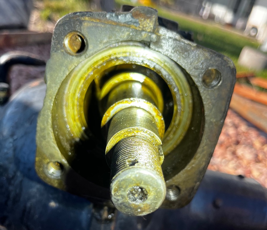

Here’s where I’m at now.
Driveshaft side bearing is in but I cannot seem to get the other one quite in all the way.

Was able to get both bearing back in with an extra set of hands.
