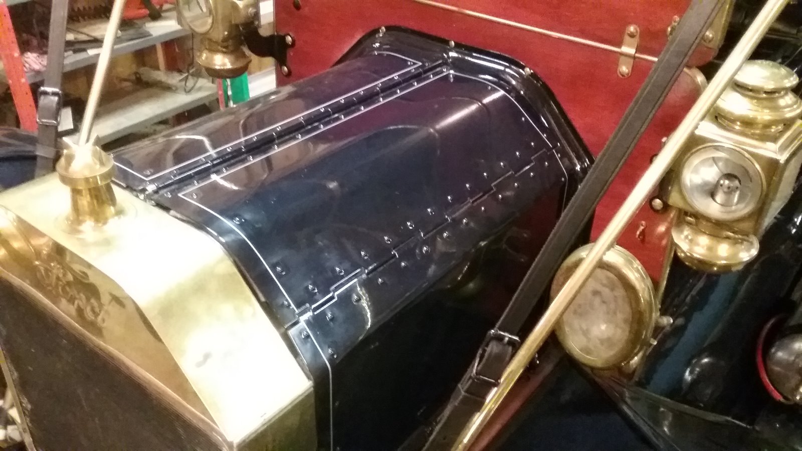

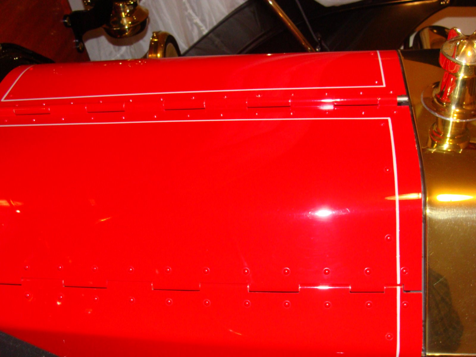

I see the hood is not pinstriped yet. Although Phip and Mark probably know (or knew ar one time) when you get to pinstriping the hood, there are no "boxes."
Just a stripe up the front, along the center hinge and down to the bottom on the back.
Thanks for the restoration updates.

Yes that is how it will be. Wheels fenders and springs and axles yet to go. It was too cold to do it when we did the body. Thanks for the good comments.
