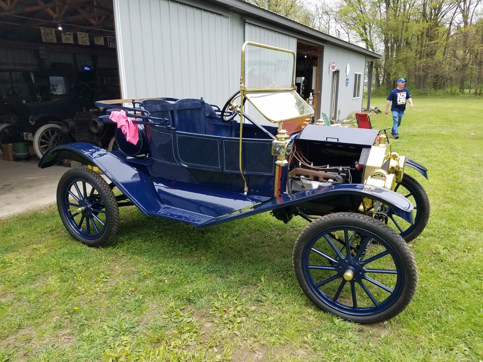

About 30 years ago Phil and Mark Eyre responded to an ad for a Model T Speedster. While they were not looking for another project, they thought the car could be a source for some parts. As they began looking over the disassembled collection of parts it became clear they were looking at many parts from an authentic 1911 Torpedo. They underestimated the car considerably. When they got the parts home it became obvious that the car was indeed a real Torpedo.
Time went on and other restoration projects took priority, including no less than five Stynoski awarded restorations, multiple AACA award winners and some fantastic tour cars. As Mark began approaching his 50th birthday, both Mark and Phil felt it was high time the Torpedo moved to the head of the line.
Here is the car as it appeared yesterday. There is a lot of striping, upholstery and final assembly to complete but the hope is to complete the car in time for it to debut at the Old Car Festival in Greenfield Village in 2020.

Beautiful car! That's great that they have moved it from the "work on later" project list to the "work on now" project list.
Do you know if it was old enough to be included in the shipping documents that are available (basically before Oct 5, 1911 engine serial number 70,750 -- and that was an engine only on the shipping documents)?
And do you know if it still had the original seat frame with the body maker and body number stamped into the front edge of the wood seat frame? And if so, which body maker produced the body? Please See Trent's page at: http://jupiter.plymouth.edu/~trentb/Mod ... 16Y2K.html and scroll down where he compares his Wilson body Torpedo with an original Torpedo but unknown body maker. He specifically notes the difference in how the "seat section is attached to the door jam by a wood "biscuit" " on one body and by "a flat head wood screw" on his Wilson bodied car.
Again, it already is a beautiful and great running car and will only become better as it is finished! If possible please keep posting progress photos in the future.

I has a b and then a number under the seat. I’d have to go look at it to see the exact number. It’s in the early 60000 and I do have the build sheet. We have it all including the pedals. It’s pretty much as it’s invoiced but I can’t read the carbide tank maker. It should have brown side lamps and a brown tail lamp but the lamps with it are e and j and I didn’t have the others so I restored them and I’ll change back to browns as I get them collected. The only piece it was missing was the steering shaft and it was probably with it and we missed it collecting all the pieces when we bought it back in 1987.

Mark,
That's great! I you get a chance to compare how your "seat section is attached to the door jam compared to the two cars on Trent's site, please let us know if it matches one of those or if per chance Beaudett (also spelled Beaudette and referred to as Pontiac on the shipping documents) use a third way of joining the wood pieces. (Again, located at: http://jupiter.plymouth.edu/~trentb/Mod ... 16Y2K.html ).
I sure wish the old cars could talk. I'm sure they have some great stories they could share. Again, beautiful car!

The body number is b 6433 and it doesn’t have the biscuit joint just a screw like in one of the pictures on Trents website. Is post pictures but I’m not as tech savvy as my buddy Eric.

I see the hood is not pinstriped yet. Although Phip and Mark probably know (or knew ar one time) when you get to pinstriping the hood, there are no "boxes."
Just a stripe up the front, along the center hinge and down to the bottom on the back.

Yes that is how it will be. Wheels fenders and springs and axles yet to go. It was too cold to do it when we did the body. Thanks for the good comments.
