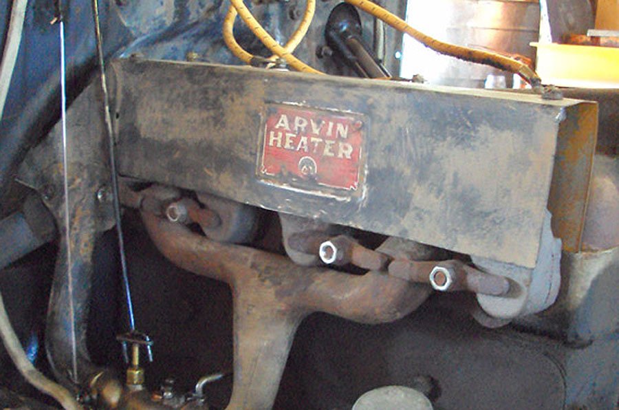

My T has an exhaust manifold that appears to be for an auxiliary heater:
The shroud is missing and there are no holes in the floor to duct the heat if the shroud was there. My question is: are there any advantages or disadvantages of running this exhaust manifold? I know it seems to radiate heat rather well under the hood.

Heater shroud

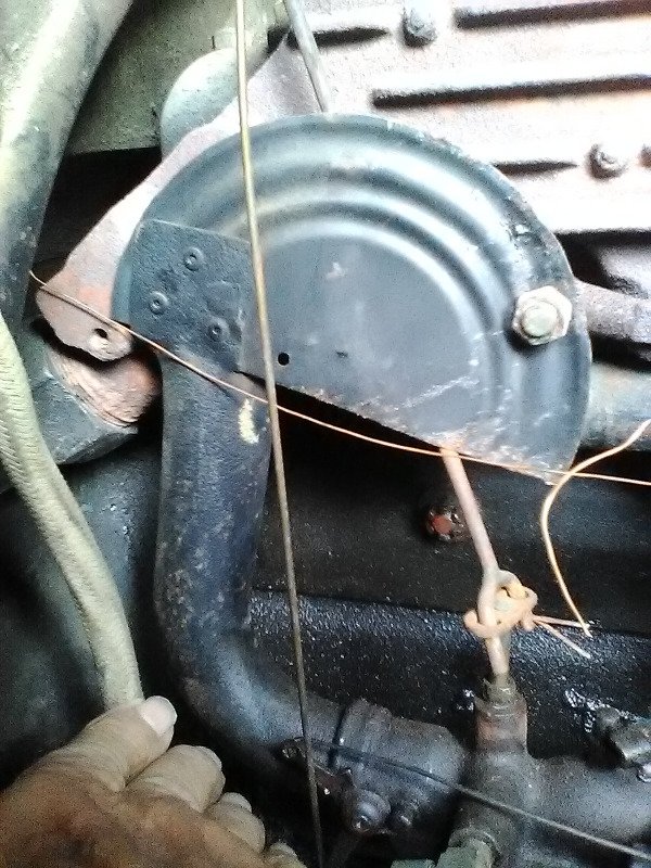

The carb and intake manifold on the touring routinely iced up from moderately to seriously. There seems to be no heat pipe (or stove) available for the exhaust manifolds we have, so I cobbled one up using an old heat pipe that had seen its better days. As you can see I also incorporated the lid off of a metal can. It was a cut, fit, and try job. It isn’t pretty but has been on the job since 1999.
I hope the photo show how I fashioned a heat pipe and if you have any questions I’d be glad to try and answer them.
Good luck. Tom in Taylor Mill, KY 41015

Thanks for posting the picture. That gives me an idea of what to make.
