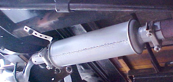

My muffler fell off and Dallas and were able to put it back on. It is an FO-11.
It is not clamped to the exhaust pipe. I had to open the front of the muffler with a file so
it would slide in place like it is suppose to. Then we installed a clamp like you see here that
I picked up at Autozone. Either one of these should work and it allows the muffler to swing a little bit back and forth
so it can move with the car.
