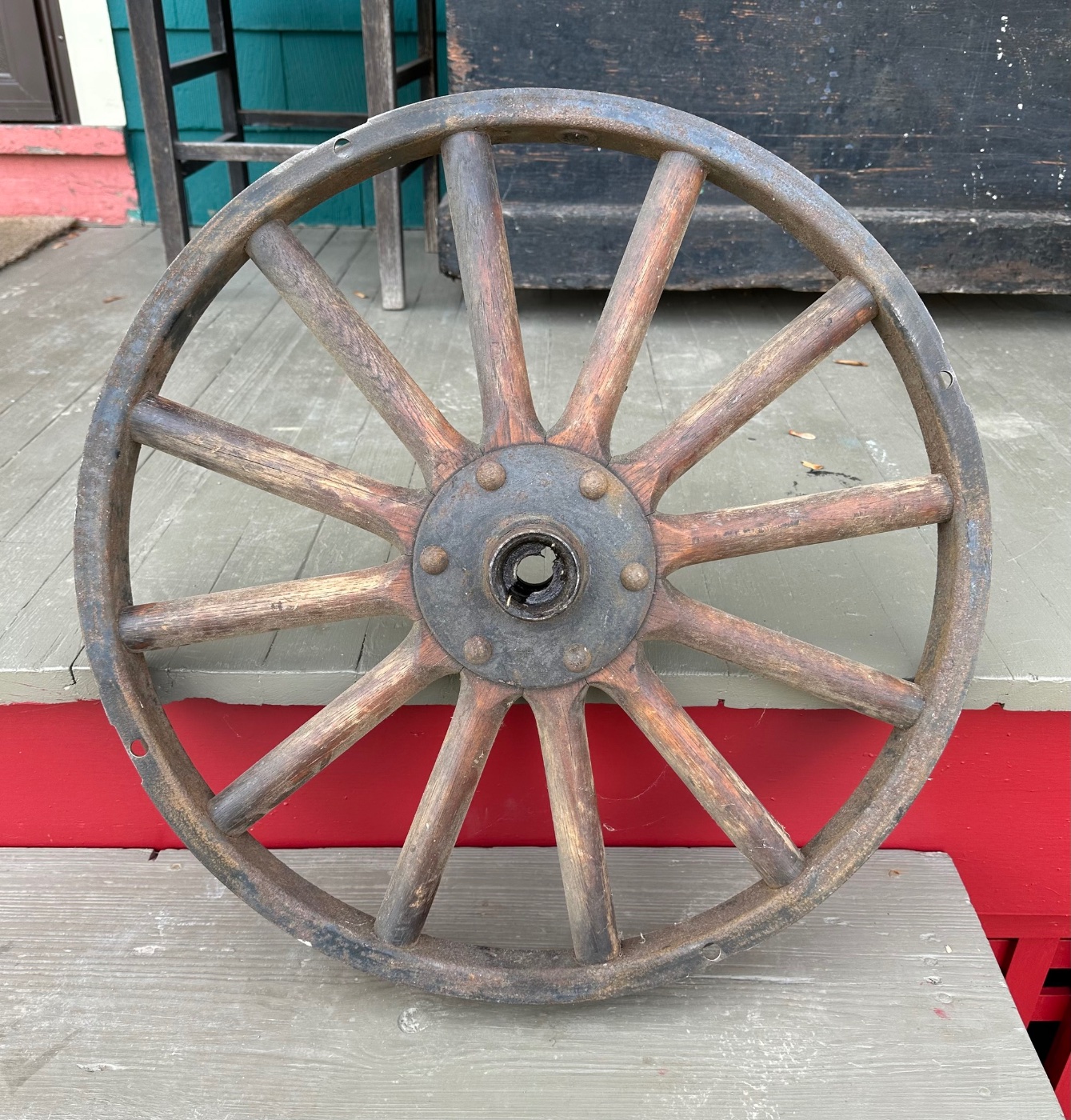

I’m looking for a Hayes demountable rim 30 x 3 1/2” wheel with the notches where the bolts install the rim.

Fellows. that felloe is different! The outside straight-up edge has no notches for the foot on a Hayes lug, so I doubt it is a Hayes felloe, this doubt being indicated by the sellers description Hayes or Ford. It also has a small raised rim around the outside of the straight-up outed edge that I have never seen on any T model felloe. It is for a fixed lug rim, having the wider rolled-out edge on the inside on which the rim wedges when fitted.
I would still be interested to see a Hayes brand stamped somewhere in a 23" felloe with the straight up outer edge.

Looks like a notch on my computer !

Steve, if you compare it with the notch shown in the original post, the Ebay one looks more like a register mark where a Hayes lug foot has been jammed on. It does not look like a deliberate machining. I seriously doubt it will take a Hayes rim, so it is most likely not a Hayes felloe.
