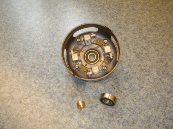

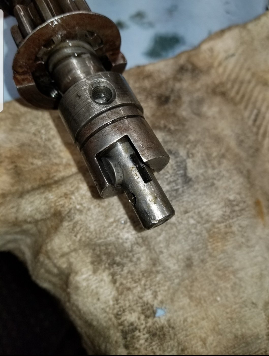

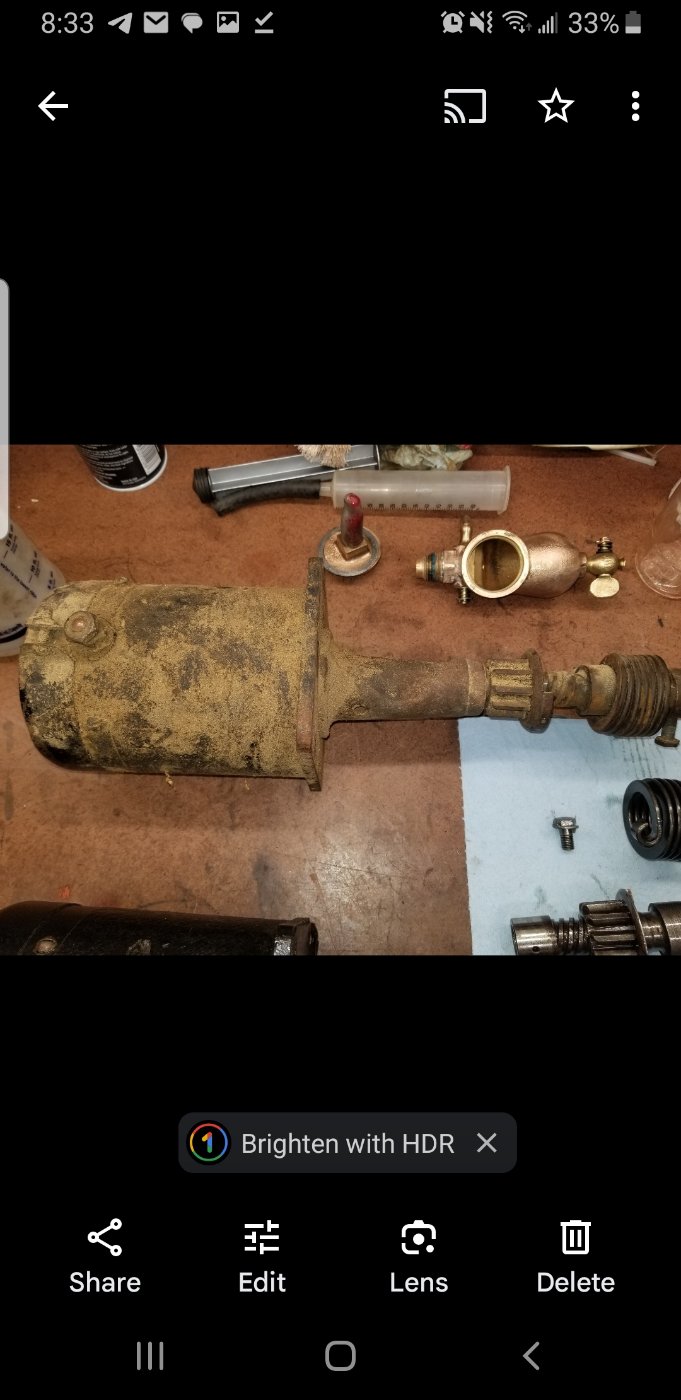

So here's the update. When I depress the starter button, volts drop from 6.3 to 5.0.
Ground strap is clean, clean and has continuity.

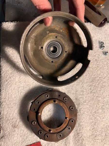

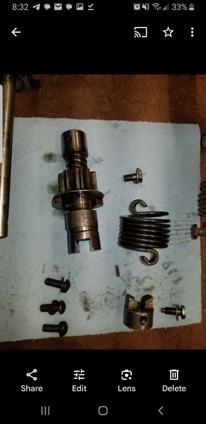

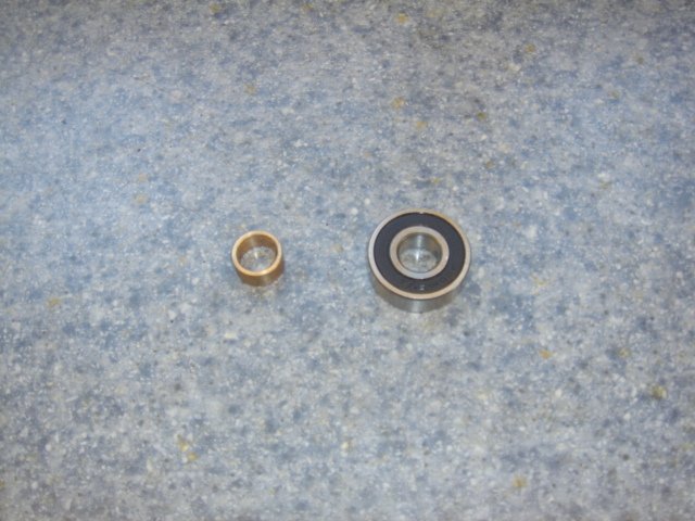

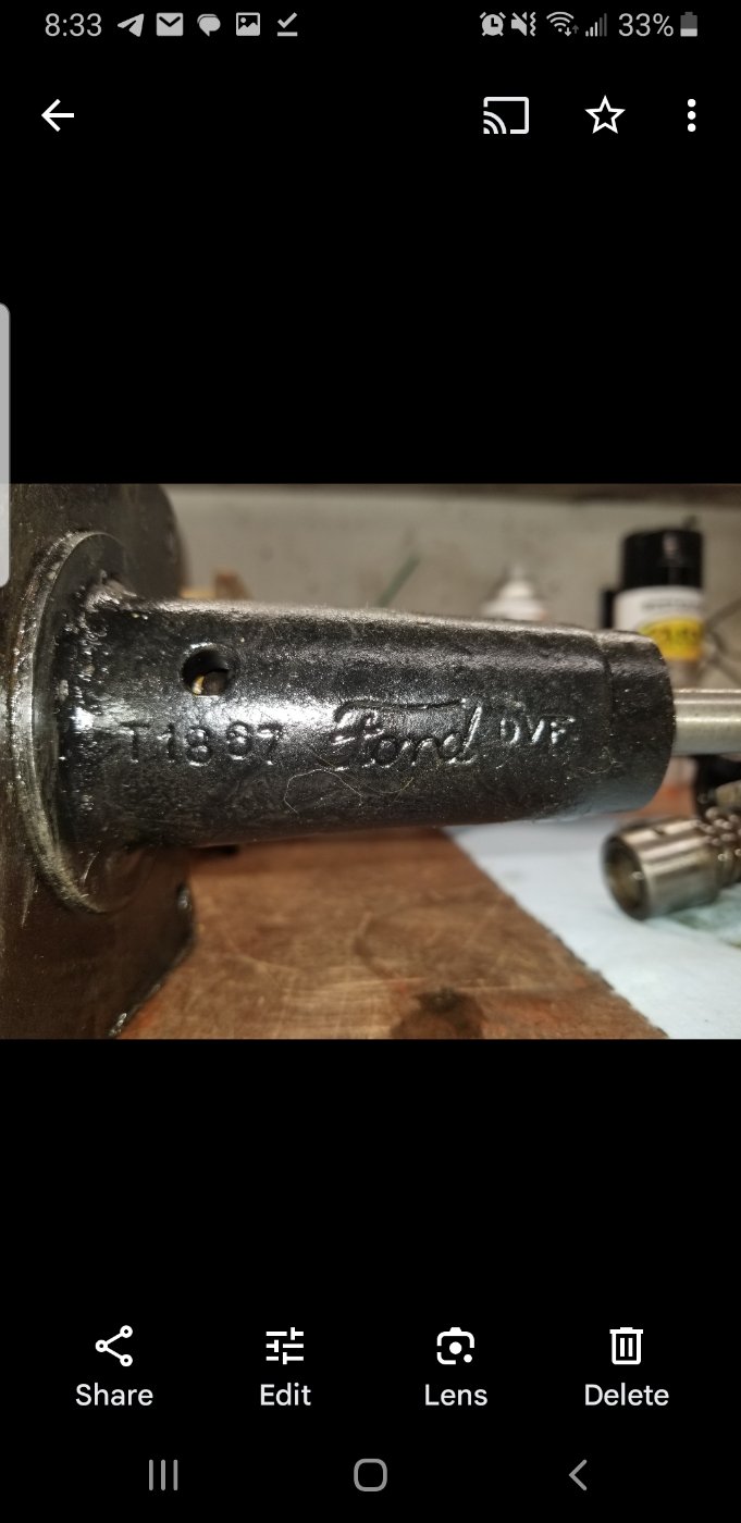

Starter has some issues but not sure what it means. Both bolts were loose and the lock tabs were not peened down. The key was just sitting loose on the shaft. Someone done messed up. Not sure this would cause slow start. See pics.
There must have been issues because everything is really clean and the car came with what looks like a spare starter. Perhaps the original.
Pics in next post.

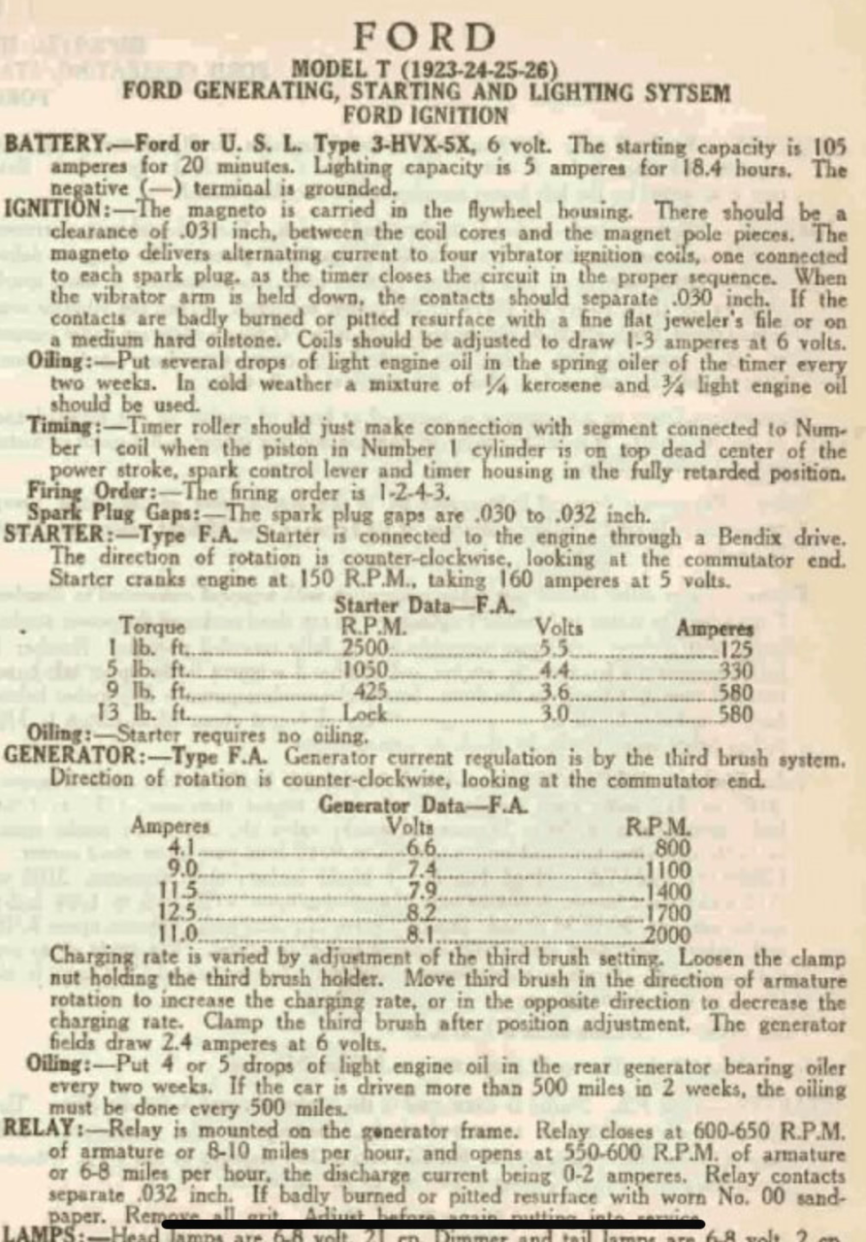

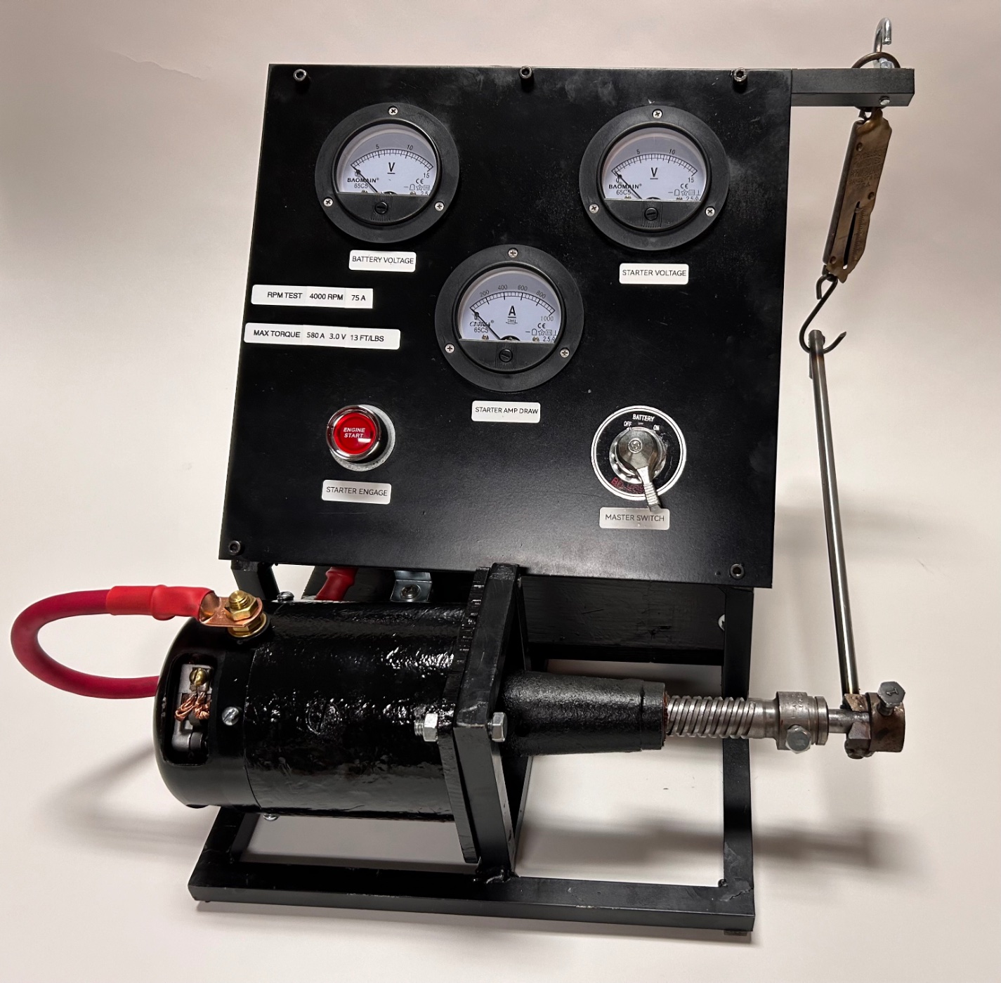

Happy to help if you like. I attached the Ford specs on the starter and a photo of my bench tester. This is a great tester to diagnose starter issues. Shoot me a message if I can help.
David

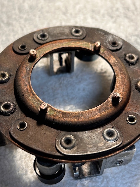

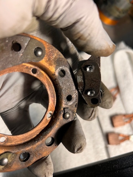

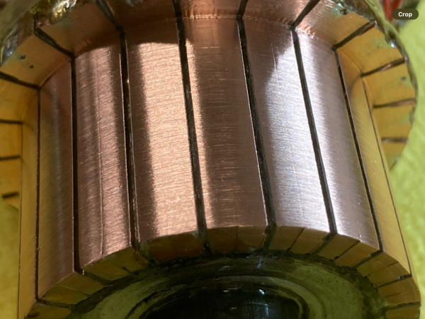

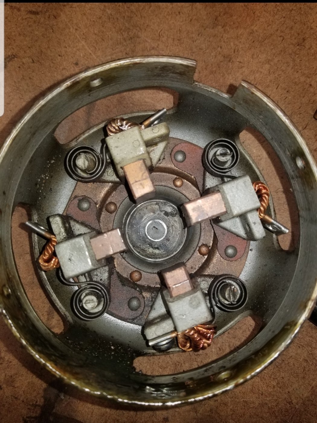

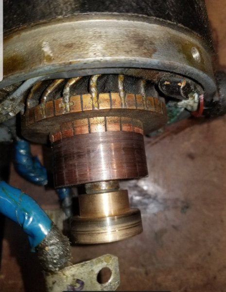

I took the starter apart and there's corrosion on the brushes and end of the commutator. Cleaned, reassembled and spun up nicely on the bench. Switch was also taken apart and it took was corroded. I put it all back together in the morning and should be able to fire it up.

Post by Woody23 » Sun Feb 11, 2024 9:04 am
Another thing to consider is the amount of resistance that has built up over time in the brush plate assembly. I typically find on every rebuild the max current is limited to 200 or 300 amps.
Max current should be around 580 A.
The only way to measure is with a shunt inline with the starter or a current sense clamp. You can also run the starter and feel the back of the brush cap it will be hot if the brush plate is resistive.
Not uncommon for a starter to just need the brush plate rebuilt.
See attached photos to see the amount of corrosion on the contact surfaces of the brush plate. Again remember 580 A are trying to get through.

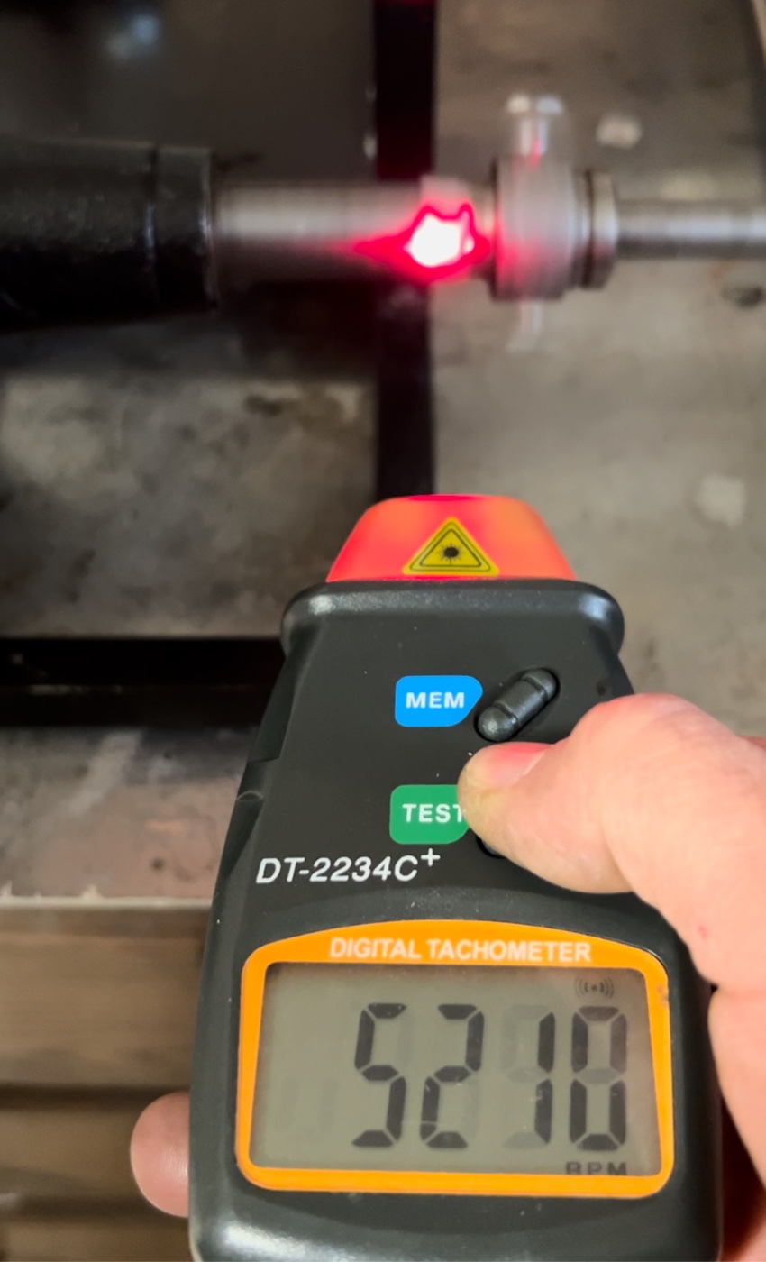

Post by vping » Sat Feb 17, 2024 10:25 am
Last week went well-ish. I put everything back together and it cranked strongly a few times and then it was back to really slowly. I took it all apart again and double checked everything in case I missed something. I checked the starter components for continuity and functionality and all seemed well. Back in the car and it was much better. I did also have to add an additional ground strap from trans to cross member.

I may look at taking the starter apart again and cleaning the brush plate.
Question, where can I get that bearing shown in your pic and is it plug and play or is there some modifications needed.
vping

My brush plate actually looks fairly clean.
Posts: 5359
Re: Slow starter
Post by RajoRacer » Sat Feb 17, 2024 10:40 am
Doesn't appear to be much left of that rear bushing !

Vince: What if anything remains of the brush end bearing? Originally, they were Babbitt, but this modern ball bearing and spacer is a drop in replacement. Do NOT machine the armature shaft! https://www.modeltford.com/item/5106RB.aspx
The only 'fitting' needed when I installed this bearing was some cleaning and polishing the inside of the end cap recess for the modern bearing. Mine was a snug slip fit, not a press fit, but the bearing needs to bottom out in the endcap. This is a fully lubricated sealed ball bearing that is fully seated in the end cap. The spacer goes on the shaft between the commutator and bearing to take up endplay. Good luck with your repair, jb

Just so y'all know the bushing is stepped bronze.

The bushing should be in the brush holder - not stuck to the armature !

I personally see a MAJOR problem with the commutator on your armature. Here's a closeup pic of what my finished and rehabbed commutators look like on a generator, and the starters are treated exactly the same, no different. They should look like this once rebuilt. This is ultimately where ALL the energy is delivered from the battery to turn the armature and it's a critical part of the rebuild. If you don't have a lathe and a way to cut the mica on your armature, youre better off having someone do it for you or just buy a rebuilt one. Your armature in its current condition is one of the worst I've seen, and like Ron, I've seen 100's. Bad armatures account for many problems on both starters and generators and one symptom is slow/erratic turning.
Ron is also spot on. there's a lot of specialized tooling and processes & techniques that go into doing this right. Get one thing wrong and it can have a cascading effect... and then you're not a happy T camper.

Vp's armature has been turned several times, and all the commutator bars look to be shorted together by copper residue. I don't see much solder left where the windings attach to the commutator bars, either.
An armature in that condition will allow a lot of current to flow right past the windings to ground. The reduced diameter of the commutator can affect how well the brushes function and will reduce the brush spring pressure.

I won't comment further on the points Jeff and Dave have made except to say they are exactly correct.
I would like to address the Brushcap Babbitt bushing problems depicted above which is one of the 7 or 8 discrete failures that must be addressed to rebuild (as opposed taking it apart and putting it back togather hoping it will work) a 100 year old Model T starter.
Fords selection of a Babbitt bushing in the brushcap was a cheap solution that was, in my opinion, not very well thought out though I doubt their horizon was for it to last a long time.
The main problem is during manufacture a dollop of something like Lubriplate was added to the bushing for lubrication and no easy provision to add more. That lube dried up and the bearing siezed to the armature shaft and started to spin inside the brushcap. You can see evidence of this in the photo above where the bushing has came out of the cap bore siezed to the armature end.
You will find many used starters with holes drilled into the brushcap for adding more bushing lubrication.
Babbitt is great for radial loads but Babbitt bushing and armature face were not set up for the axial force of the armature being pulled back and forth in the case during actual operation wearing the bushing face causing excessive armature end play. How many times have you seen excessive starter armaturer end play on a used Model T starter?
The Brass bushing sold by parts suppliers to correct this problem require some special tools to spot face the bushing to reset armature end play.
Another simple way to correct this problem requires no special tools, needs no lubrication and has no axial loading issues
Get a ball bearing bushing replacement kit form the parts suppliers consisting of a 6201 2 RS 1/2 ID bearing and spacer. The bearing is pre lubricated, has double lube shield, is well suited to the low duty cycle of the starting motor and will last another 100 years.
There are solutions like this described fix for each of the 7-8 discrete issues with worn our starters that are cumulative and ultimately cause starter failure.
If you dont adequately address each of them the first time you will be back at it again later. Good luck
Ron Patterson

Please excuse my ignorance for using the wrong ball bearing all these years & giving bad advice regarding its use. (6201 2 rs)
The bearing Ron suggests (6201 2 RS 1/2) with a spacer will make the conversion much simpler.

The commutator bars do need to be insulated one from another. The starter brushes have a higher copper content than the ones in the generator, and in normal, intermittent service will not bridge over the gaps between the commutator bars. When things start wearing out, longer duty cycles and higher loads due to bushing wear will act to increase current draw and overwork the commutator assembly leading to a condition like the one pictured above, where conductive copper residue has been smeared around the commutator, partially shorting the commutator bars to each other.
Batteries in poor condition cause more rapid starter wear and deterioration, as will junky cables and worn switches and engines that are difficult to start. Applying 12 volts to a stock 6 volt starter is not good practice.
If you're saying that the OP's commutator has been turned way undersize when compared to Jeff's, it's because, (I believe), Jeff has shown a generator commutator. I think starter commutators are smaller in diameter.
Posts: 7958
Re: Slow starter
Post by TXGOAT2 » Mon Feb 19, 2024 8:10 pm
Could well be.
