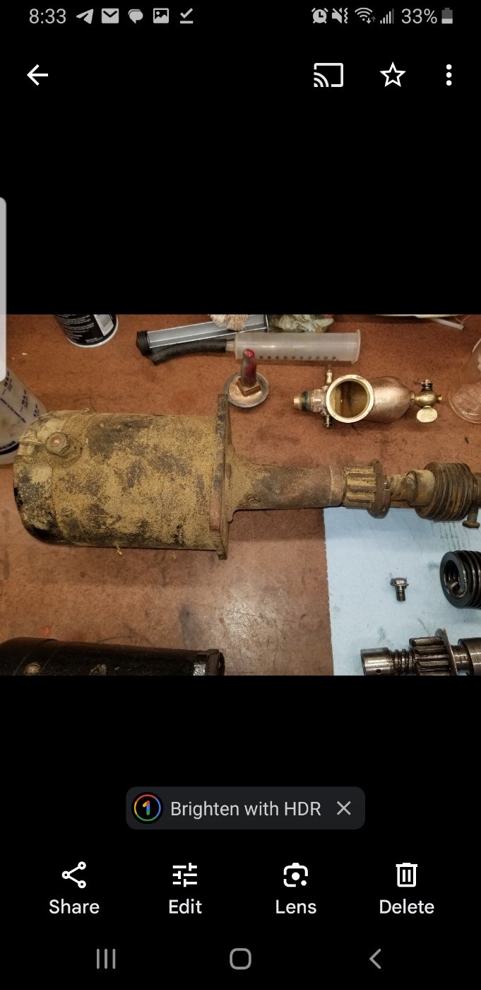

by vping » Wed Feb 07, 2024 8:30 pm
So here's the update. When I depress the starter button, volts drop from 6.3 to 5.0.
Ground strap is clean, clean and has continuity.
Starter has some issues but not sure what it means. Both bolts were loose and the lock tabs were not peened down. The key was just sitting loose on the shaft. Someone done messed up. Not sure this would cause slow start. See pics.
There must have been issues because everything is really clean and the car came with what looks like a spare starter. Perhaps the original.
Pics in next post.

vping

Post
by vping » Thu Feb 08, 2024 8:06 pm
Can I hook a battery to the starter directly and see if she spins on the bench?
- Posts: 5362
Post
by RajoRacer » Thu Feb 08, 2024 8:09 pm
Sure can - hang on to it or better yet, clamp it in your vice. I would suggest attaching the + to the post THEN touch the - to the case - it should spin like crazy ! Verify that the cable + post is solid as a rock - any movement there and you have "issues" !

Post
by vping » Thu Feb 08, 2024 9:07 pm
I'll put it in the vice.
I put a voltmeter across the terminals of the starter switch. When engaged, voltage drops from 6.3 to 5.0 of not less. Must be lots of resistance that and not putting full power to the starter.
Once I bench test the starter, I'll remove the switch.

by vping » Sat Feb 10, 2024 7:52 pm
I took the starter apart and there's corrosion on the brushes and end of the commutator. Cleaned, reassembled and spun up nicely on the bench. Switch was also taken apart and it took was corroded. I put it all back together in the morning and should be able to fire it up.

Last week went well-ish. I put everything back together and it cranked strongly a few times and then it was back to really slowly. I took it all apart again and double checked everything in case I missed something. I checked the starter components for continuity and functionality and all seemed well. Back in the car and it was much better. I did also have to add an additional ground strap from trans to cross member.
I am able to get the engine to pop off once with ether.
Today I'm going to check the grounds again and then work on fuel delivery.
I may look at taking the starter apart again and cleaning the brush plate.
Question, where can I get that bearing shown in your pic and is it plug and play or is there some modifications needed.

by vping » Sat Feb 17, 2024 10:27 am
My brush plate actually looks fairly clean.

by RajoRacer » Sat Feb 17, 2024 10:40 am
Doesn't appear to be much left of that rear bushing !

by speedytinc » Sat Feb 17, 2024 10:59 am
Looks like there is no bushing.
Converting to a ball bearing requires machining the shaft down some.

by jab35 » Sat Feb 17, 2024 11:23 am
Vince: What if anything remains of the brush end bearing? Originally, they were Babbitt, but this modern ball bearing and spacer is a drop in replacement. Do NOT machine the armature shaft!
https://www.modeltford.com/item/5106RB.aspx
The only 'fitting' needed when I installed this bearing was some cleaning and polishing the inside of the end cap recess for the modern bearing. Mine was a snug slip fit, not a press fit, but the bearing needs to bottom out in the endcap. This is a fully lubricated sealed ball bearing that is fully seated in the end cap. The spacer goes on the shaft between the commutator and bearing to take up endplay. Good luck with your repair, jb

by Ron Patterson » Sat Feb 17, 2024 12:08 pm
The problem with starter repair is that they usually have a combination of faults with the bushings, armature, brush cap, brushplate, field windings and Bendix drive. Some rebuilding steps require special tools.
As indicated above many faults occur on the side of the brushplate that is not visible. Suggest removing and completel;y rebuilding the brushplate too. Upon reinstallation use copper rivets and set with a pneumatic rivet setting tool and buck.
Unless you have the specialty tools required, don'try using a new bushing in the brush cap. Most parts suppliers sell a easy to install ball bearing replacement and spacer kit. Make sure it includes a 6201 2 RS 1/2 id ball bearing so you do not have to resize the armature shaft end.
Rebuilding starters is a slippery slope and EVERYTHING must be checked to get a properly working starter.

Post
by vping » Sat Feb 17, 2024 6:57 pm
Just so y'all know the bushing is stepped bronze.

Post
by vping » Sat Feb 17, 2024 6:58 pm
- Posts: 5362
Post
by RajoRacer » Sat Feb 17, 2024 10:31 pm
The bushing should be in the brush holder - not stuck to the armature !

by AdminJeff » Sun Feb 18, 2024 3:24 am
With 37 replies to this thread, I've been loathe to add my 2 cents but now I can't resist.
Listen to Ron Patterson. His word is gospel when it comes to starters on a Model T.
I personally see a MAJOR problem with the commutator on your armature. Here's a closeup pic of what my finished and rehabbed commutators look like on a generator, and the starters are treated exactly the same, no different. They should look like this once rebuilt. This is ultimately where ALL the energy is delivered from the battery to turn the armature and it's a critical part of the rebuild. If you don't have a lathe and a way to cut the mica on your armature, youre better off having someone do it for you or just buy a rebuilt one. Your armature in its current condition is one of the worst I've seen, and like Ron, I've seen 100's. Bad armatures account for many problems on both starters and generators and one symptom is slow/erratic turning.
Ron is also spot on. there's a lot of specialized tooling and processes & techniques that go into doing this right. Get one thing wrong and it can have a cascading effect... and then you're not a happy T camper.

by TXGOAT2 » Sun Feb 18, 2024 10:50 am
Vp's armature has been turned several times, and all the commutator bars look to be shorted together by copper residue. I don't see much solder left where the windings attach to the commutator bars, either.
An armature in that condition will allow a lot of current to flow right past the windings to ground. The reduced diameter of the commutator can affect how well the brushes function and will reduce the brush spring pressure.

by Ron Patterson » Sun Feb 18, 2024 10:58 am
I won't comment further on the points Jeff and Dave have made except to say they are exactly correct.
I would like to address the Brushcap Babbitt bushing problems depicted above which is one of the 7 or 8 discrete failures that must be addressed to rebuild (as opposed taking it apart and putting it back togather hoping it will work) a 100 year old Model T starter.
Fords selection of a Babbitt bushing in the brushcap was a cheap solution that was, in my opinion, not very well thought out though I doubt their horizon was for it to last a long time.
The main problem is during manufacture a dollop of something like Lubriplate was added to the bushing for lubrication and no easy provision to add more. That lube dried up and the bearing siezed to the armature shaft and started to spin inside the brushcap. You can see evidence of this in the photo above where the bushing has came out of the cap bore siezed to the armature end.
You will find many used starters with holes drilled into the brushcap for adding more bushing lubrication.
Babbitt is great for radial loads but Babbitt bushing and armature face were not set up for the axial force of the armature being pulled back and forth in the case during actual operation wearing the bushing face causing excessive armature end play. How many times have you seen excessive starter armaturer end play on a used Model T starter?
The Brass bushing sold by parts suppliers to correct this problem require some special tools to spot face the bushing to reset armature end play.
Another simple way to correct this problem requires no special tools, needs no lubrication and has no axial loading issues
Get a ball bearing bushing replacement kit form the parts suppliers consisting of a 6201 2 RS 1/2 ID bearing and spacer. The bearing is pre lubricated, has double lube shield, is well suited to the low duty cycle of the starting motor and will last another 100 years.
There are solutions like this described fix for each of the 7-8 discrete issues with worn our starters that are cumulative and ultimately cause starter failure.
If you dont adequately address each of them the first time you will be back at it again later. Good luck
