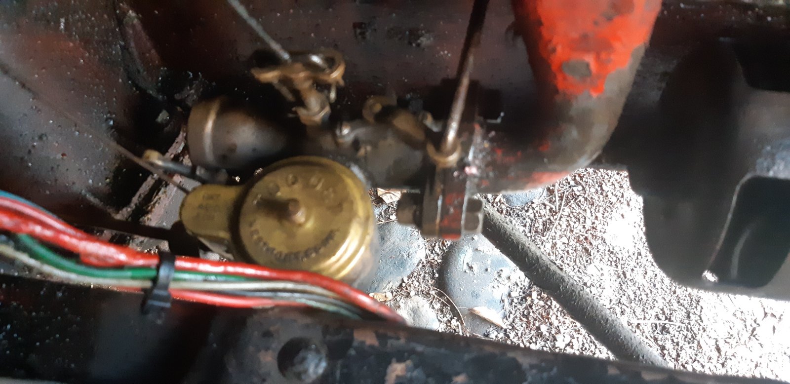

Last week helped a fellow T'er with a troublesome Vaporizer( I know, folks really like 'em) , but I tried without success to get the Ford to idle. Would run full out, but stumble and rough when throttled down.
Did change out the gaskets, thinking intake leaks, by spraying some starter fluid the engine picked up. But to no effect with new gaskets and some sealer too.
So today, back over to his place and Fred removed that Vaporizer and we installed a new exhaust manifold and a rebuilt Corey Walker NH.
The gas line needed work as the existing carb inlet nut was too small and had a compression fitting, so cut it off and installed the Ford style pack nut with a neoprene gasket. A bit of fitting up a new thru the block throttle rod to get full excursion, and the choke and stuff.
So with the carb needle valve set to 1.2 turns out from closed, we opened the gas valve, let gas flow to the bowl. Gave it a crankover with choke pulled out, and cranked and cranked til I told Fred to stop. Then asked him if the ignition was ON ! Oops.....forgot that in the excitement, since his '26 Pickup has a distrub-i-tor, knew I wouldn't be hearing a buzz from coils. Well that did it. Switch on and one touch of the starter button and the T roared to life, idled down great and runs strong now. Fun Day ;)
