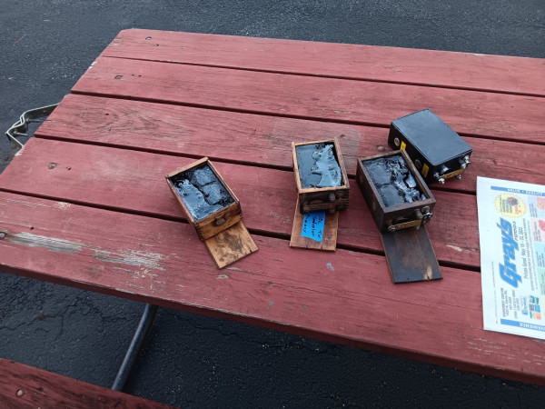

Worked on coils!
First time :)

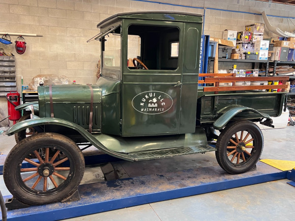

Just made it my official farm truck:-)

Nice. The T truck that never was, but should have been. Cracker box.

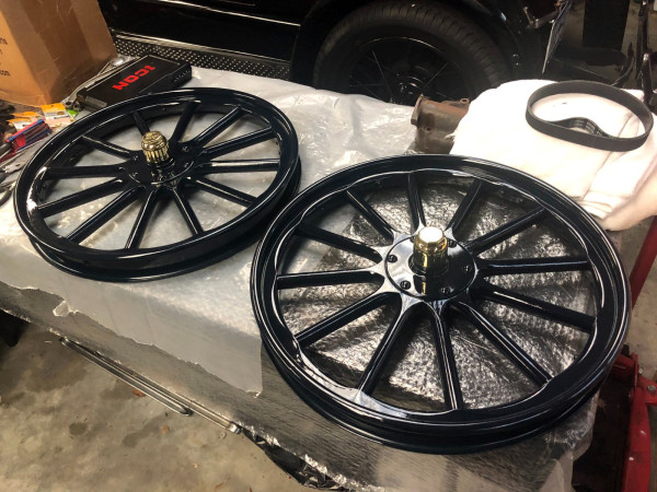

Got the rear wheels for my 1912 painted Midnite Blue. That sure is a dark blue! Now to get the front wheels out of the paint shop and mount some tires. The wheels were rebuilt by Stutzman, and looked beautiful in natural finish. I was tempted to finish them as "natural" but decided to paint them as original. (Maybe they'll start calling me "Original Jones.")

Yeah and it'll go faster than 18 mph too!! :lol:

Hey Original Jones! :lol: Yep those are gorgeous wheels and indeed "dark, all but black, blue"! Fit right in with the '11-'13 dark blue original paint color. Gonna look great on that '12 of yours. Stutzman does a heckuva job on wheels for sure. What kind/brand of paint did you use may I ask?

Tim, we used PPG Omni 2K urethane enamel. Paint code DB904, aka "Dark Blue" as used on 1985 Mercedes Benz. It is really a rich, dark color. Sometimes it looks a bit blue and to the casual observer looks black depending on what the lighting is. My painter loves that color and decided to paint his hot rod Model A roadster that color. Sealed the wood first with a two part epoxy sealant, then primer/sealer, then topcoat. Lots of work, those wood wheels.

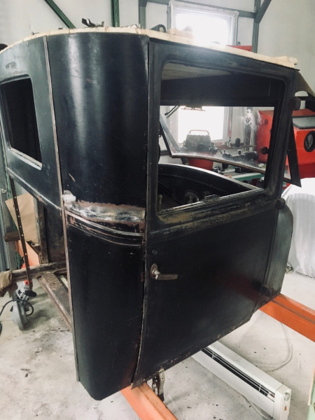

Continuing with the 26 Tudor pickup conversion. Working on forming cab corners using metal salvaged from the back half that was cut off.

Your pickup is looking good, Bryant. Don't feel bad about "repurposing" that Tudor-you are surely not the first to do something like that, and it allows it to live on as a cool pickup.

Thanks Greg! They did it way back then so I feel like it’s got a period correctness to it.

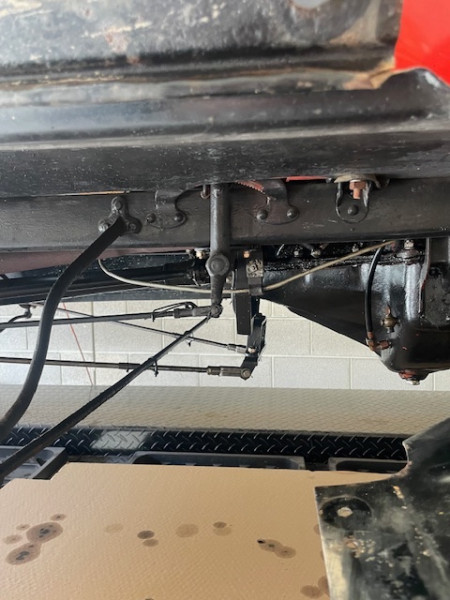

Post by abcarswell » Sat Feb 10, 2024 2:58 pm

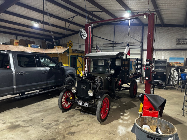

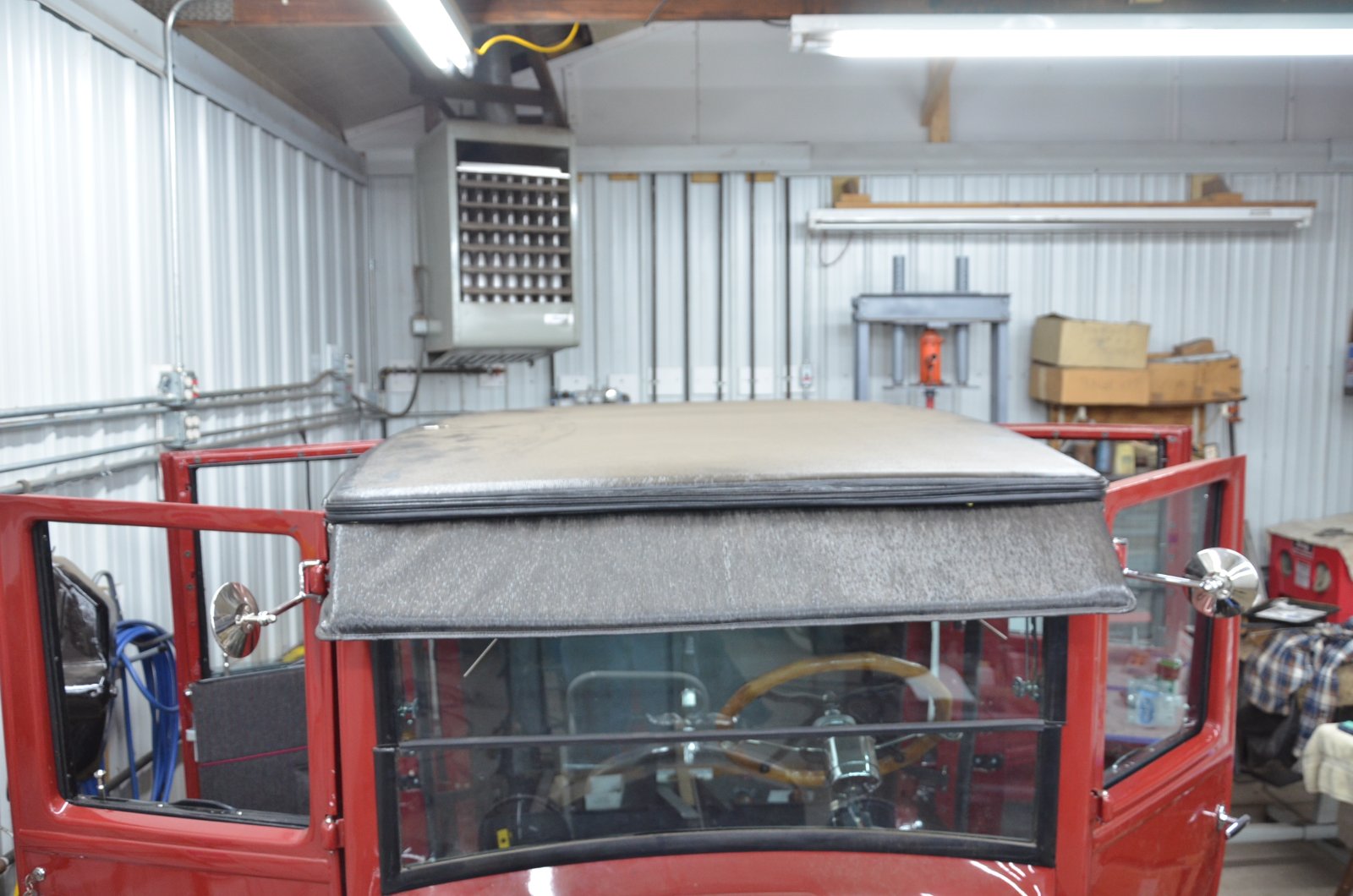

Spotted to the lift to start pre season service. Will likely tackle the top replacement when it warms up a bit.

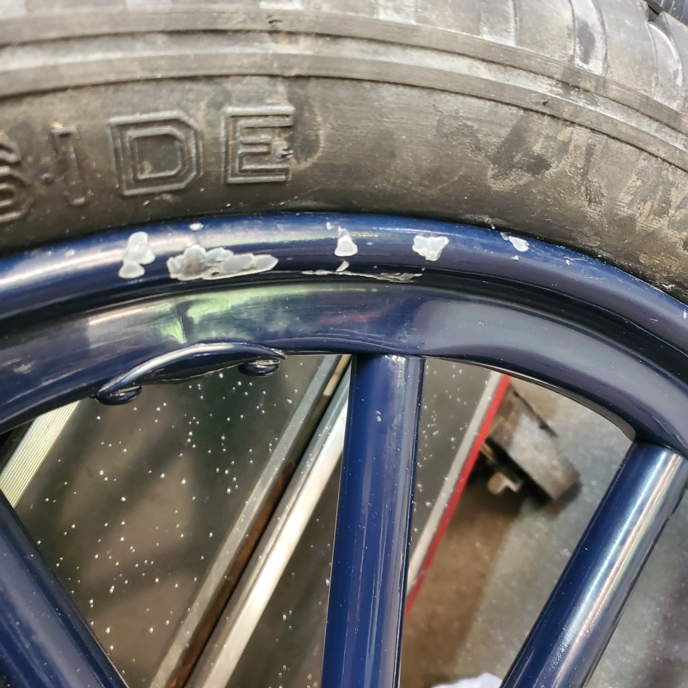

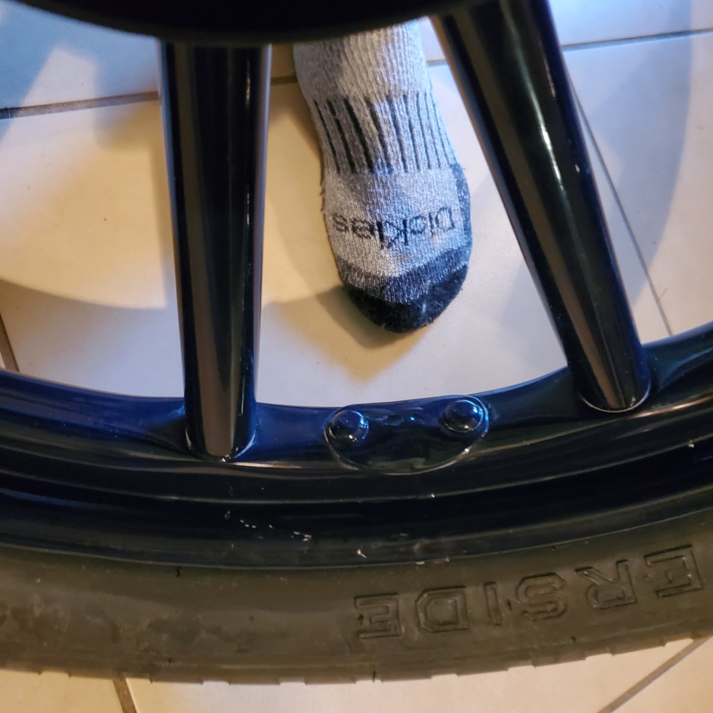

I balanced the front wheels on my 1923 Touring using duck decoy lead strip anchors.

John,
How did you attach the balancing weight to the wheels.

Nice looking wheels, Greg. I know how much work is involved sealing, priming, topcoating, cut and color sanding and finally buffing out. Takes forever but the result is worth it. When you mount the tubes and tires, mount them from the inside of the wheels. You'll invariably have scratches to touch up and nothing will show on the outside. Plenty of methods to try when mounting. I tried them all and still suffered scratching the paint. Thank heavens I got pretty good at touch up!

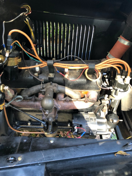

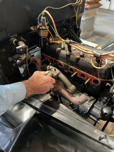

Last week helped a fellow T'er with a troublesome Vaporizer( I know, folks really like 'em) , but I tried without success to get the Ford to idle. Would run full out, but stumble and rough when throttled down.
Did change out the gaskets, thinking intake leaks, by spraying some starter fluid the engine picked up. But to no effect with new gaskets and some sealer too.
So today, back over to his place and Fred removed that Vaporizer and we installed a new exhaust manifold and a rebuilt Corey Walker NH.
The gas line needed work as the existing carb inlet nut was too small and had a compression fitting, so cut it off and installed the Ford style pack nut with a neoprene gasket. A bit of fitting up a new thru the block throttle rod to get full excursion, and the choke and stuff.
So with the carb needle valve set to 1.2 turns out from closed, we opened the gas valve, let gas flow to the bowl. Gave it a crankover with choke pulled out, and cranked and cranked til I told Fred to stop. Then asked him if the ignition was ON ! Oops.....forgot that in the excitement, since his '26 Pickup has a distrub-i-tor, knew I wouldn't be hearing a buzz from coils. Well that did it. Switch on and one touch of the starter button and the T roared to life, idled down great and runs strong now. Fun Day ;)

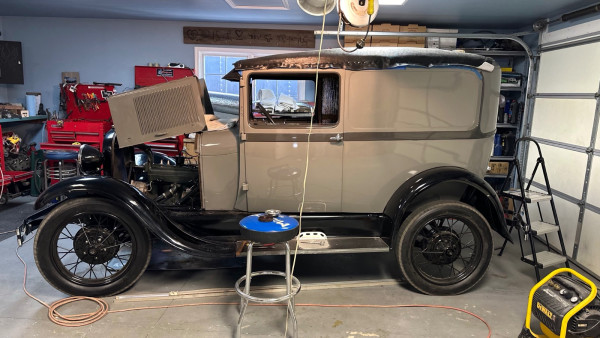

I put the ‘26 Touring in the trailer ,,so I could work on the ‘29….
I’m waiting for warm weather to install the top on the restored bows ..

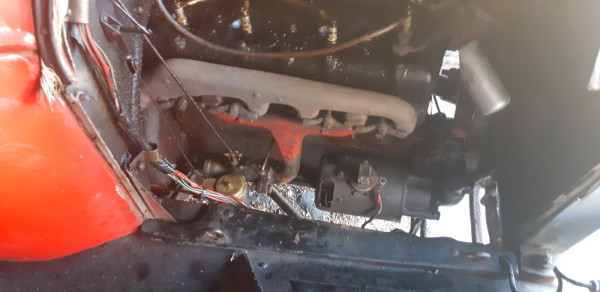

When I bought the 1914 touring, it was equipped with a TOQUET carburator. Doing some research I found out that they where marketed in the early 20's, so it wouldprobably fit better on my 1921 Roadster pick-up, which is the one I drive the most.
Today I swapped the Holley NH with the TOQUET and did a quick spin around the blocks to test it at it ran flawlesly. My biggest expectation was the idle, that was very smooth on the 1914 due to the fact that the TOQUET have some sort of idle system. Even that test was passed. When it becomes a little warmer a more thorough test and finetuning will be made.

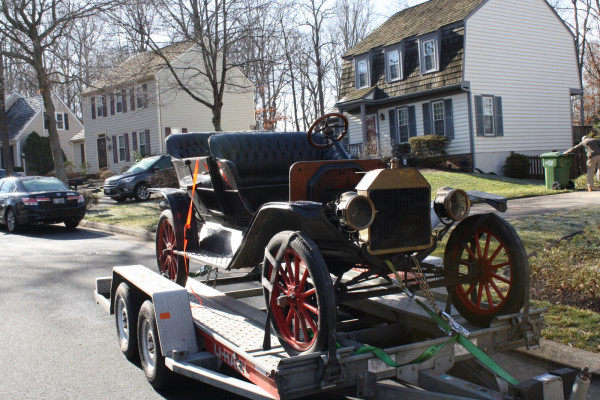

Post by MHSprecher » Tue Mar 05, 2024 12:50 pm
I brought my new to me 1910 touring to my garage. It's been stored since 1985 and in the same family since 1955.
