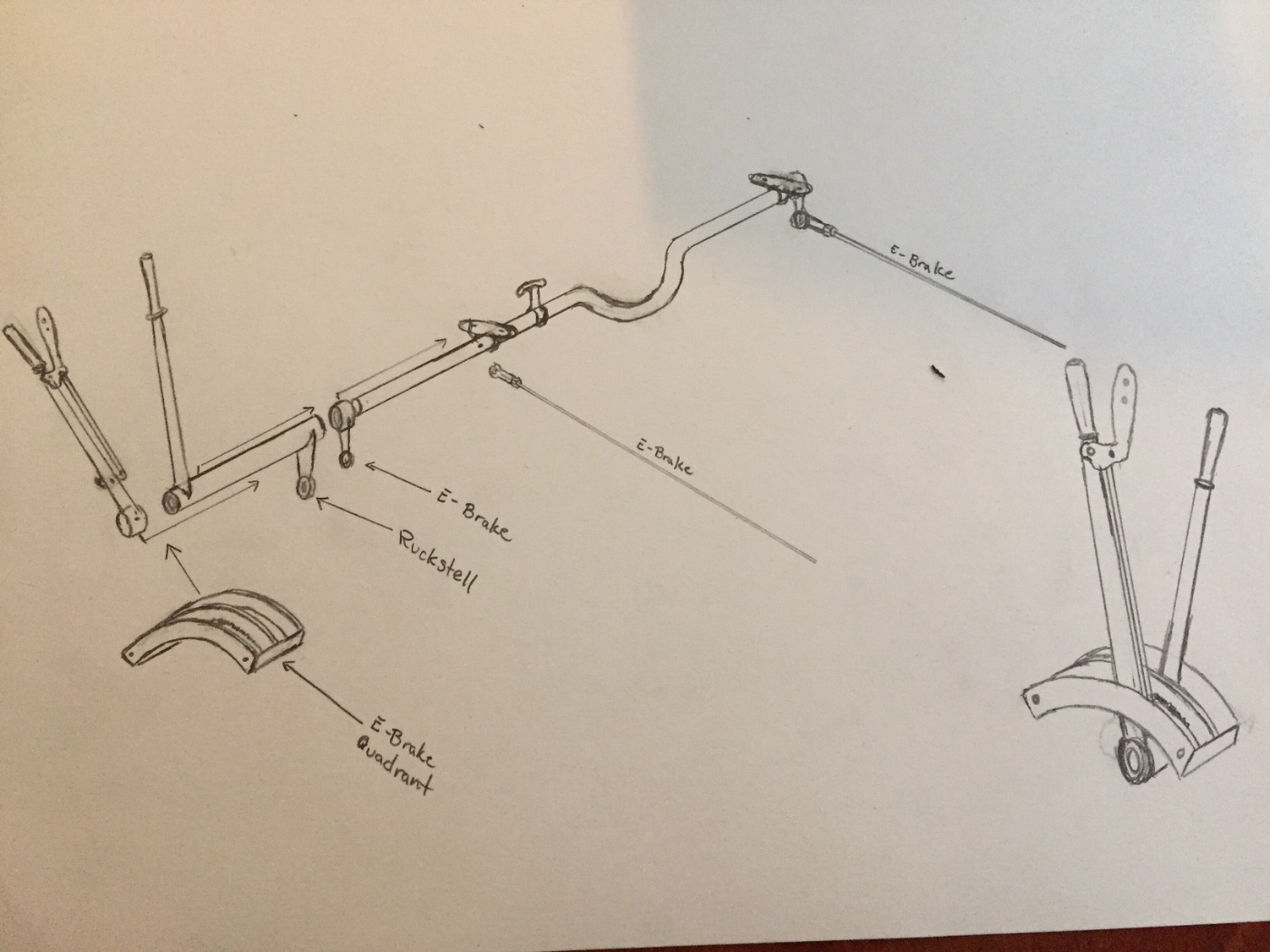

Well, I have not built this set-up but I have thought about it. It uses a factory parking brake shaft extended to the outside of the speedster body. A tube with a handle welded on slides over the extended section of the parking brake shaft. The factory emergency brake handle then goes on. For a speedster appearance, a “gate style” quadrant goes around the Ruckstell and emergency brake handles. It would require a clever Ruckstell shift rod to go from outside the frame to the shifter on the Ruckstell.
- Posts: 1983
- First Name: craig
- Last Name: leach
- Location: Laveen Az
Re: Anyone with a speedster and a Ruckstell and hand brake on the left outboard off the body?
Hi Chris,
Thanks for posting that drawing I will print & save that.
Craig.
Craig.

Thanks Chris and Craig. I was thinking of doing the gate but having the levers off set using a Model A brake lever for the Ruckstell and possibly taking the knee bend out of the T lever. But I may want the extra separation. But the tube over shaft single mount look would be a lot cleaner.
I am going to do like Craig and have them go in opposite directions. Also going to try and get another right-side e brake end to use where the stock lever would have been for the left-side connection of the OEM brake rod. I think that would be easier to use than trying to use the cut-off end from the lever after it goes outboard.
