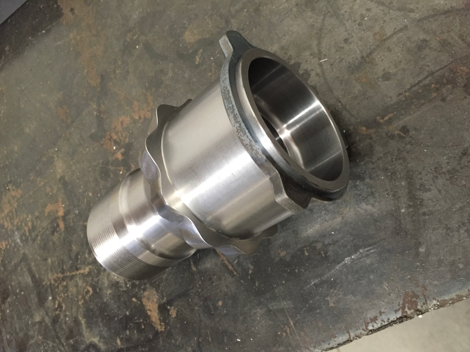

Those tabs really complicate the manufacturing of new hubs, so I leave them off. To add that capability I make a ring that shrinks on to the hub. Brazing or welding will likely cause distortion of the bearing bore, but I have found that a .002” shrink fit is enough to retain the speedometer gear without distorting the bearing bore

Thanks Kevin, that looks like a good way to go.  Maybe add some green loctite stud and bearing mount as well.
