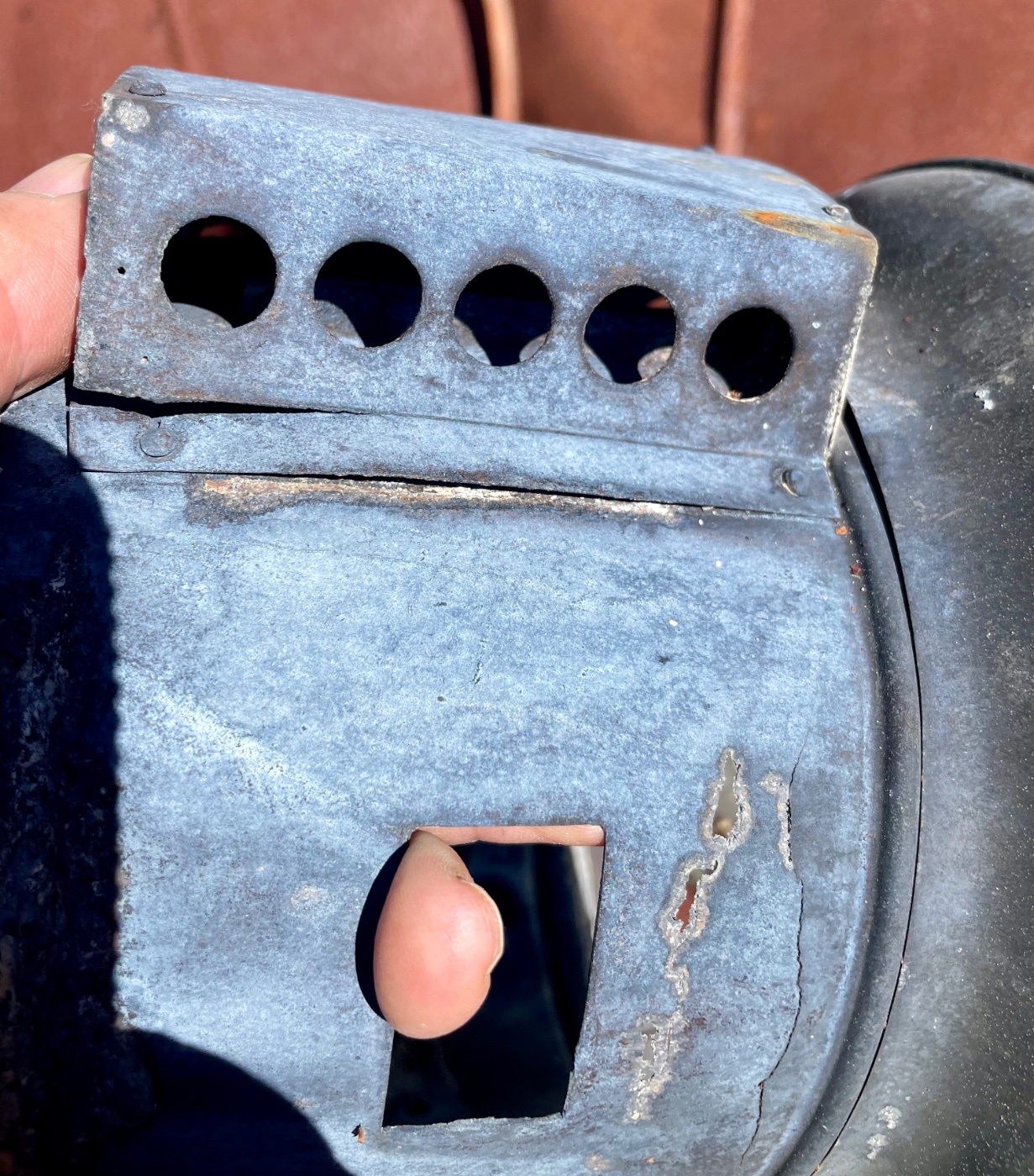

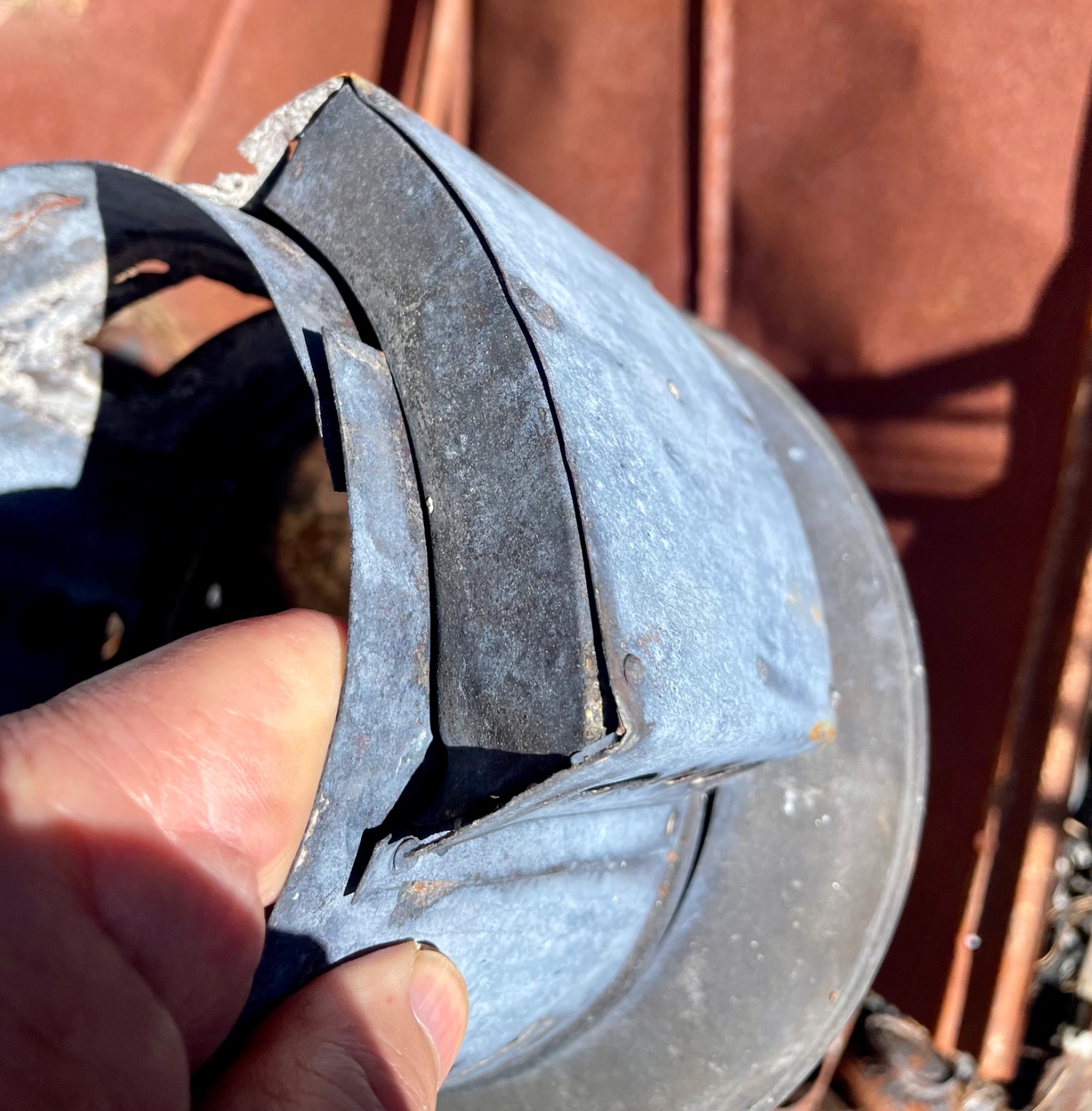

Some of the other knockoffs.

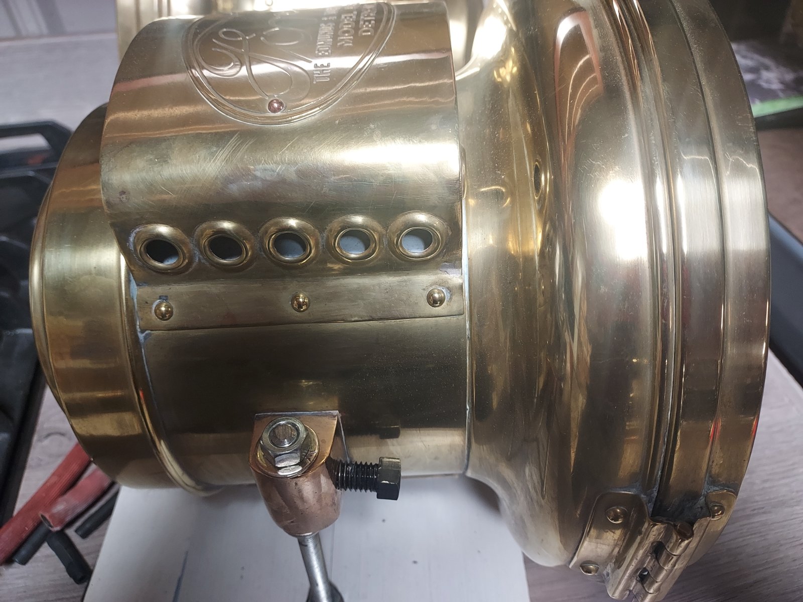

Here are a couple photos of mine. They have mirrors and the retainers are soldered in. attachment=2]20240310_131709.jpg[/attachment]
Posts: 1906
Last Name: Tannehill
Location: Hot Coffee, MS
Re: E&J 466 headlight question
Post by JTT3 » Sun Mar 10, 2024 6:29 pm
Your Legit
