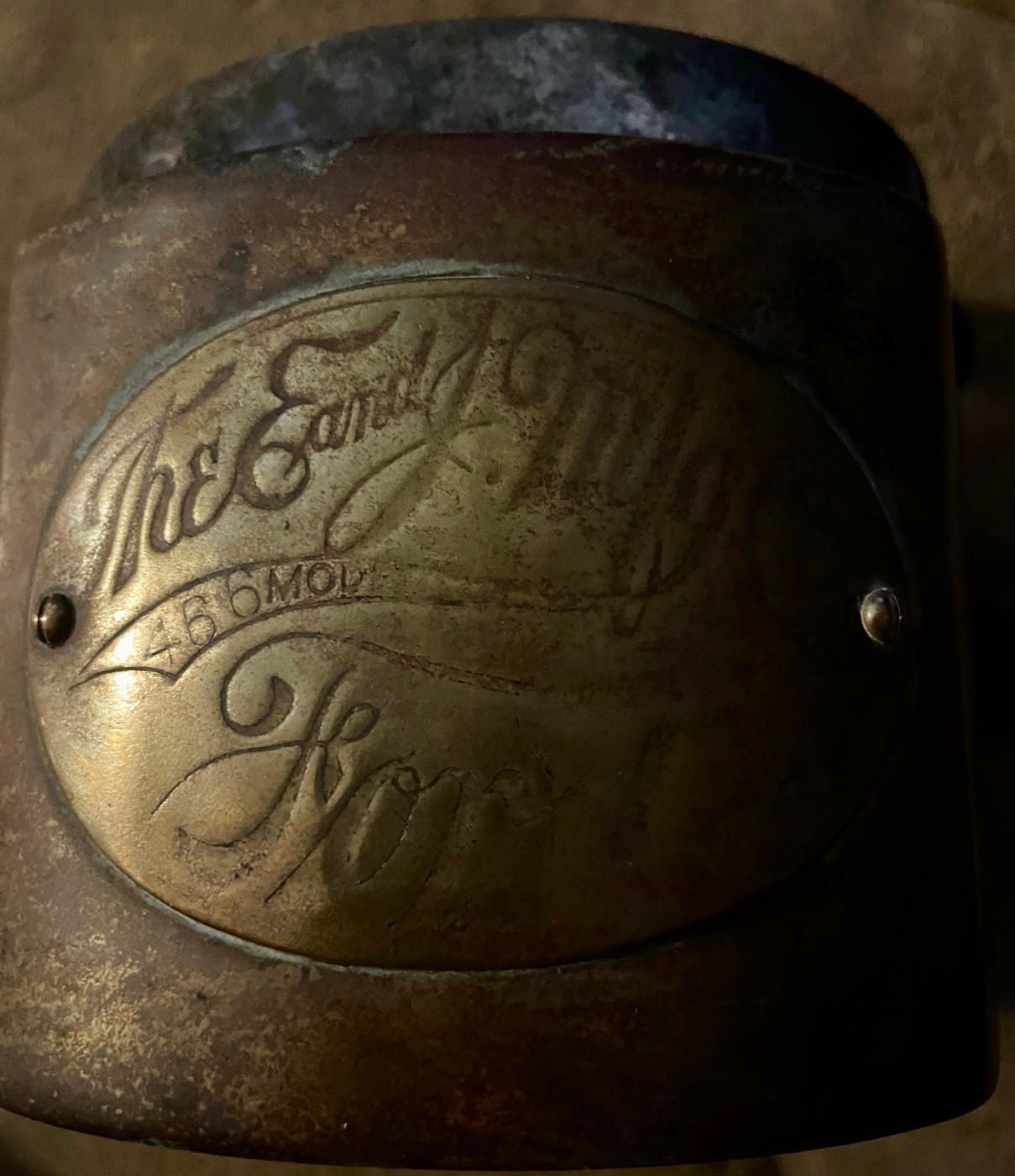

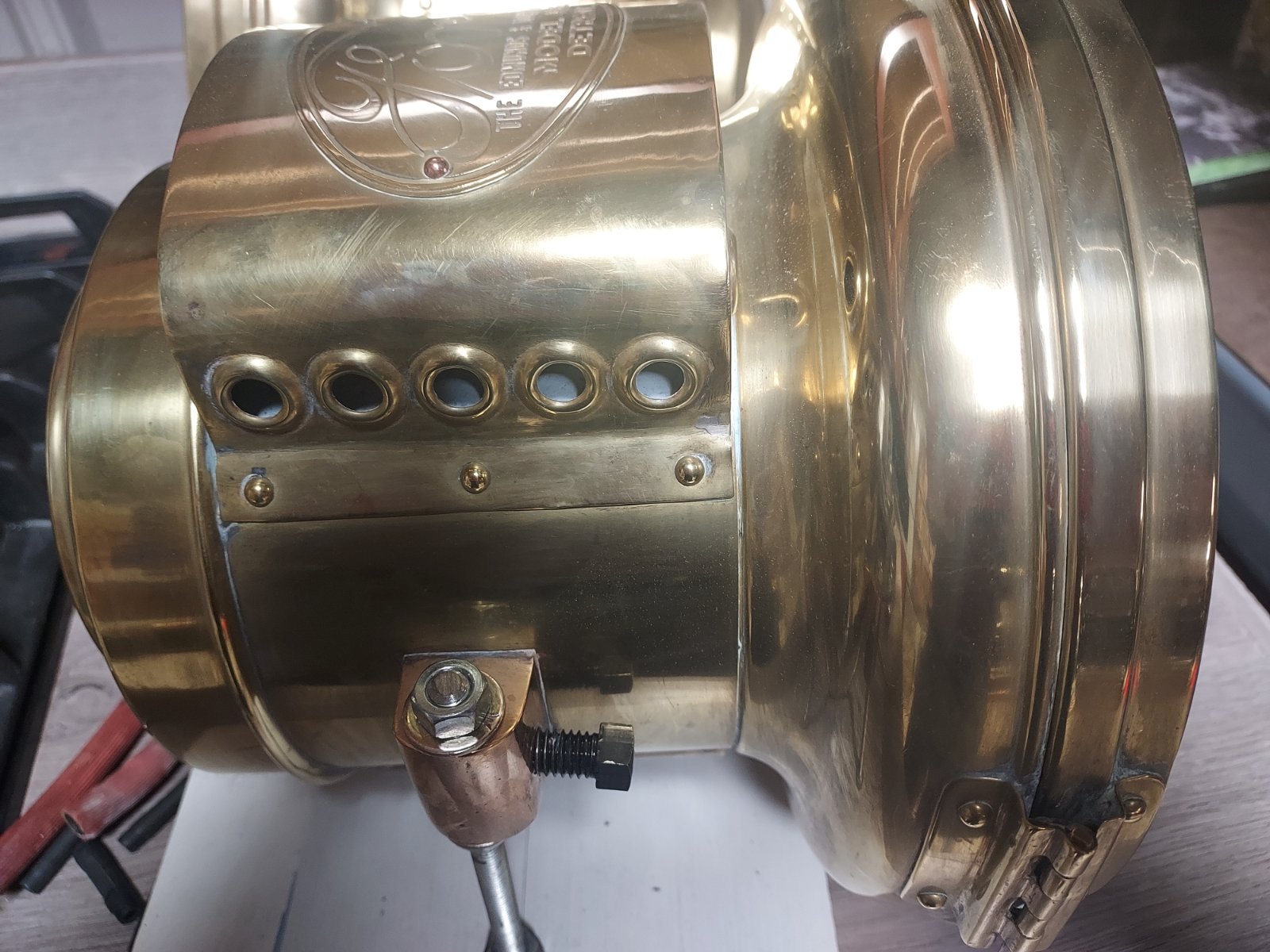

Re: E&J 466 headlight question
Here are a couple photos of mine. They have mirrors and the retainers are soldered in. attachment=2]20240310_131709.jpg[/attachment]
- Posts: 1880
- Last Name: Tannehill
- Location: Hot Coffee, MS
Your Legit
