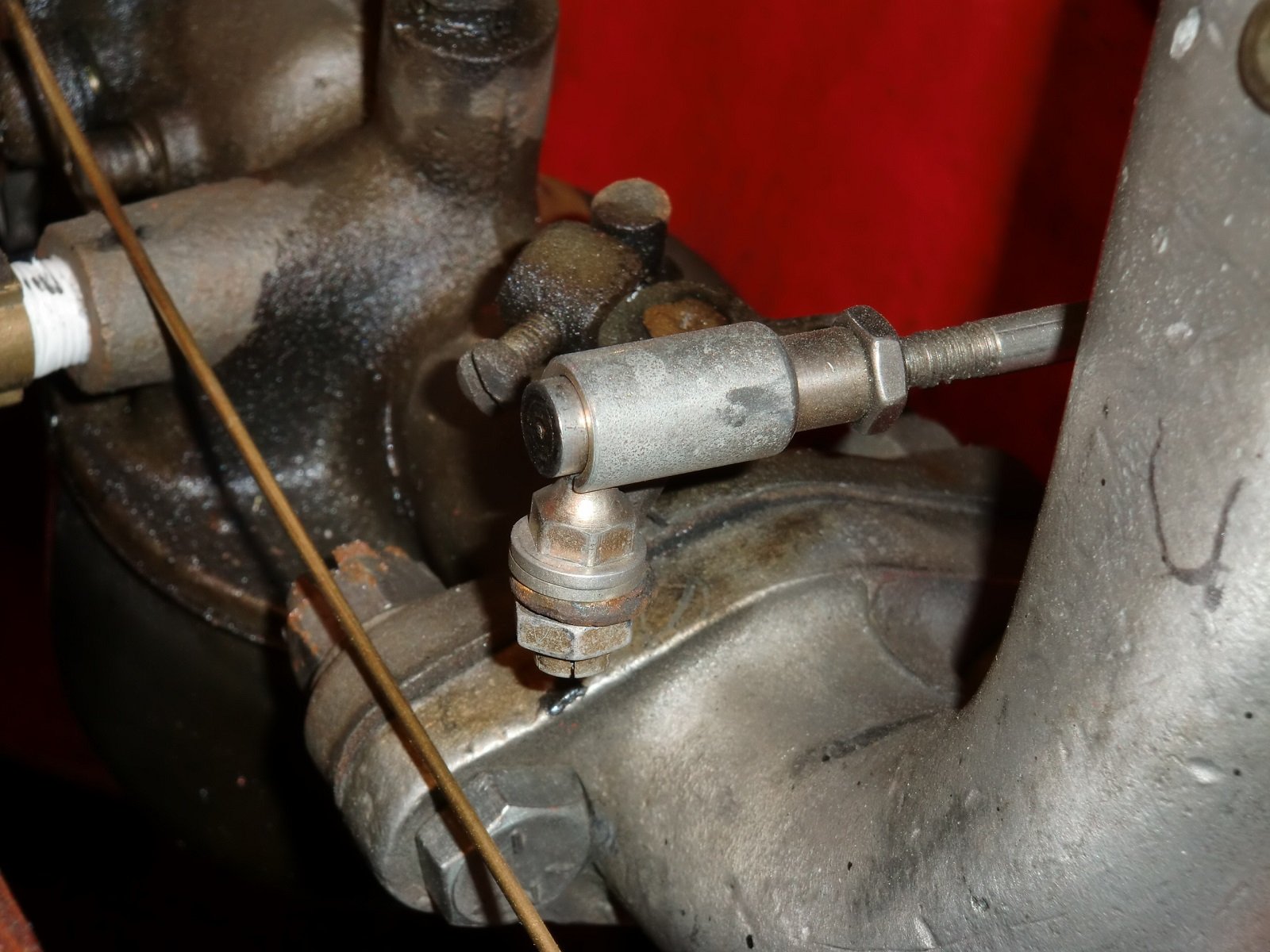

Re: Loose timer control lever
I put "Rod Ends" on my timer and throttle.
I don't have any play in either one now.
I don't recognize any of those rod ends. I have originals on both my cars, which are 1913's.
- Posts: 654
- First Name: BOB
- Last Name: CASCISA
- Location: POULSBO, WA
These are non-stock additions I made to my '16 T.
https://www.racecareng.com/item/1579972 ... ory=113424
