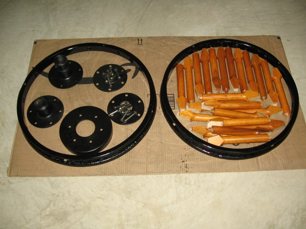

I found that a cardboard collar helps the "tent" of spokes stay in place.

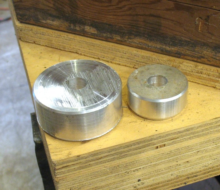

At first I used washers to keep the hub centered.
Then I made my own "washers", which worked better.
Either way, you need something to keep the hub centered.
I lubricate the "business end" of the spokes with a candle.

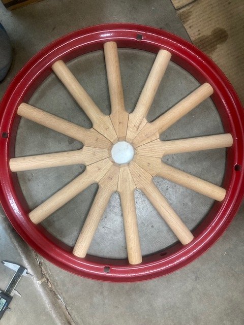

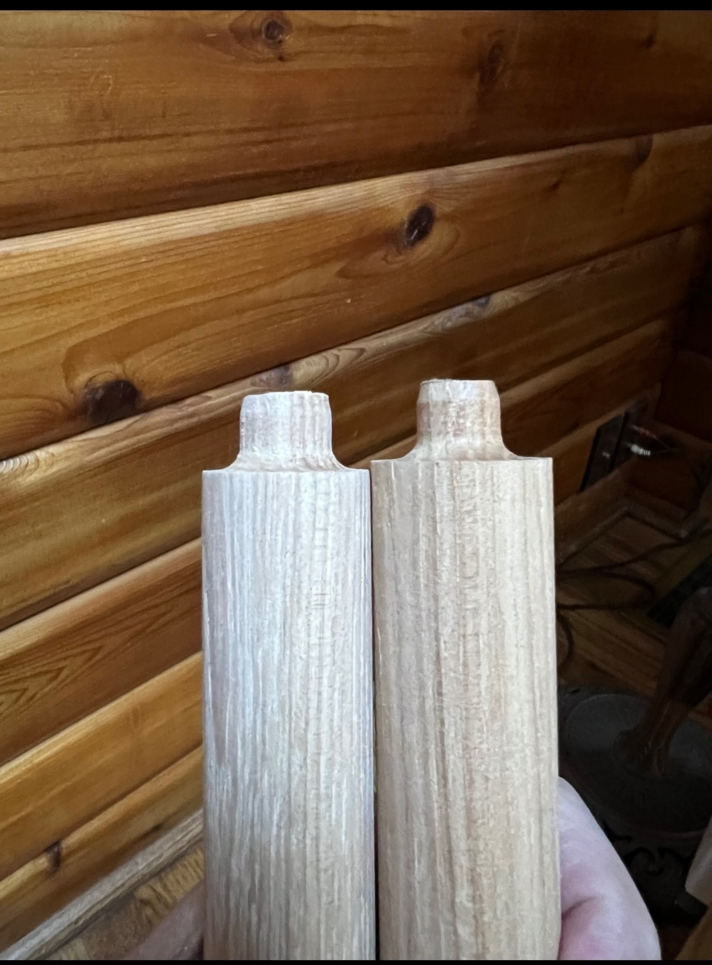

Post by KBurket » Wed May 22, 2024 11:45 am
It might work better if your fellow is not locked to the table with rim bolts and the spokes and hub should be lubricated with wax or oil as mention previously. This would allow the fellow to turn with your hub. You may want to try using an additional top washer or two to keep the hub from turning.
I waxed the tenon, the shoulder of each spoke, and the hub mating surface of each spoke. A lesson I learned from Steve Jelf’s spoke press video and other posts on this forum.
Ensure you’re using the correct length spokes. Kelsey Hayes fellows use spokes that are 1/16” longer. Measuring the inner diameter of your fellow should be 20 3/4” max for non-Kelsey/Hayes wheels.
Also keep in mind that not all spokes are created equal.
I recently respoked two wheels, one with 1/2” tenons and the other with 5/8” tenons. I had to buy spokes from two different vendors and they were different lengths.
Two different lengths.
The 5/8” tenon spokes went in straight but the 1/2” spokes didn’t sit right and I cracked the shoulders on three different spokes.
Cracked shoulders.
Cracked shoulders.
I ended up ordering three new spokes, ensuring they were correct for my fellows, then I trimmed all of the spokes by ~1/32”.
Trimming spokes.
Trimming spokes.
They were still longer than the original spokes and were a compressed fit.
New vs old spoke after trimming.
