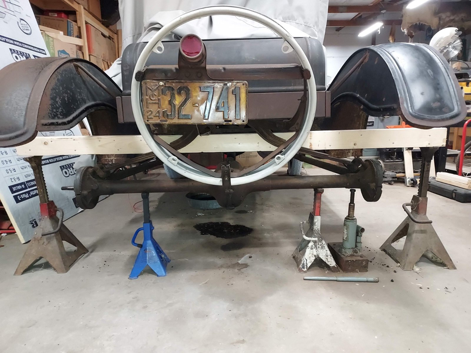

I am doing the same thing to mine right now.
1) lift the rear of the car up by the rear axle.
2) Remove the rear wheels.
3) Support the frame with 2- 2x4's glued and nailed together supported on tall jack stands.
4) Lower the rear axle as needed to take the load off the spring shackles and remove the spring at the rear end and leave the spring attached to the frame.
5) Unbolt the ball joint, disconnect the brake rods at the hand brake shaft. Be sure to support the front of the driveshaft so it will not fall when you pull the axle assy out. Use furniture dollies under each rear brake plate and the ball joint to roll it out from under the car.
All done as a one man job. I still need a helper putting it back in the car, one at the ball joint/universal joint and one at the rear axle. MTFCA has a good 3 CD set on the rear axle that I recommend, and the MTFCA rear axle book is a must.

I made my own jack stands. Just need some steel pipe, flat stock and bracing stock. I set these in front of the radius rods when I remove a rear end.
Picture is of them at the front.
