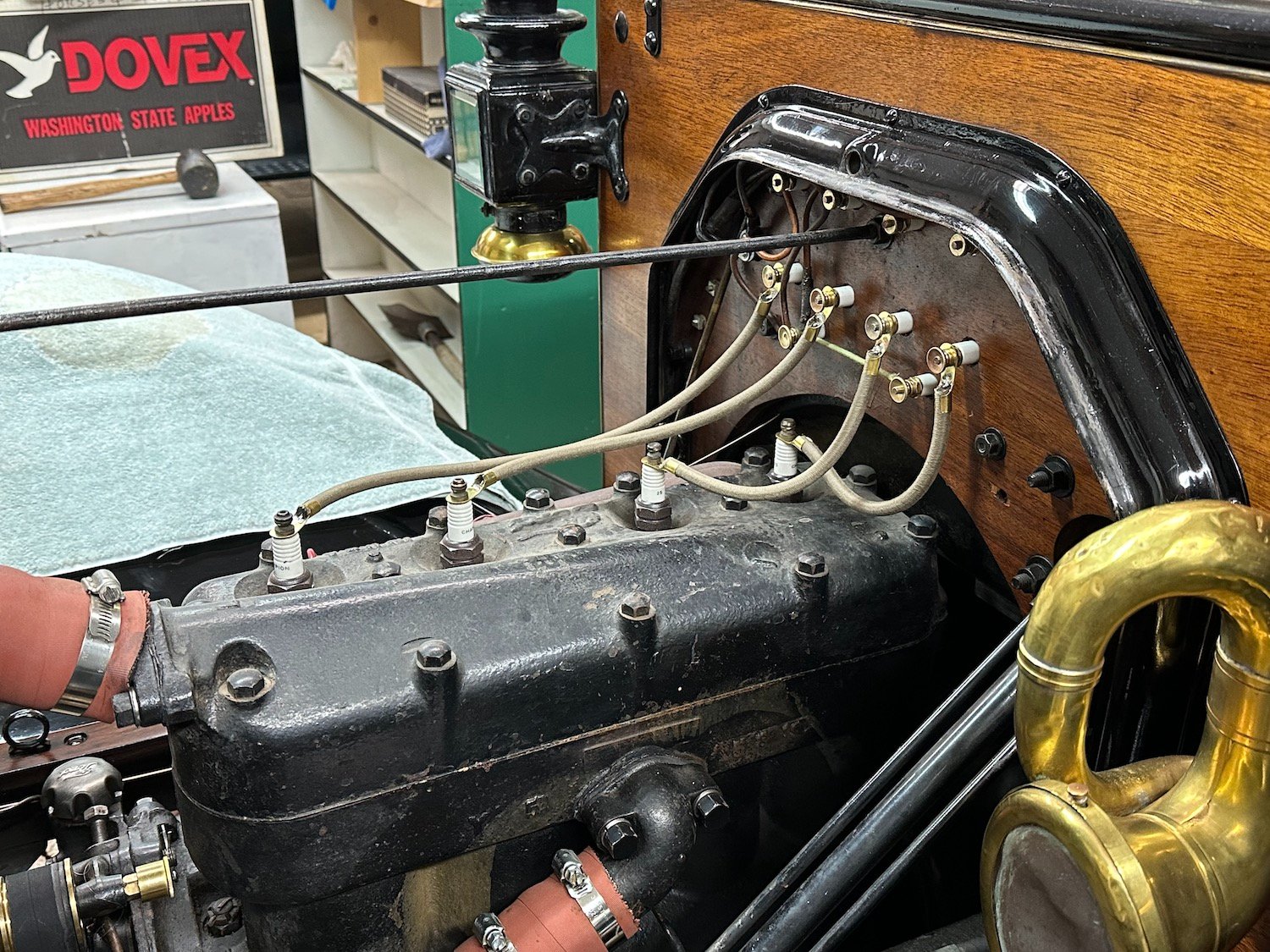

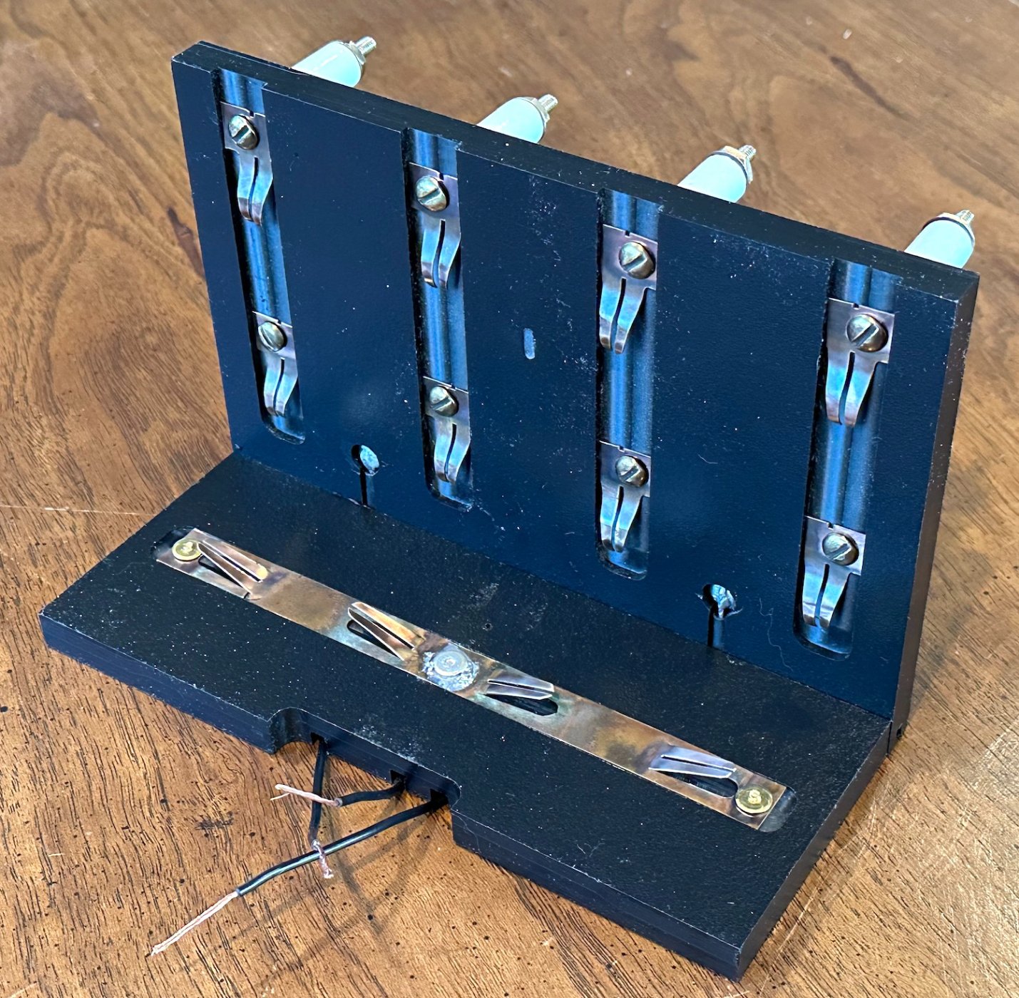

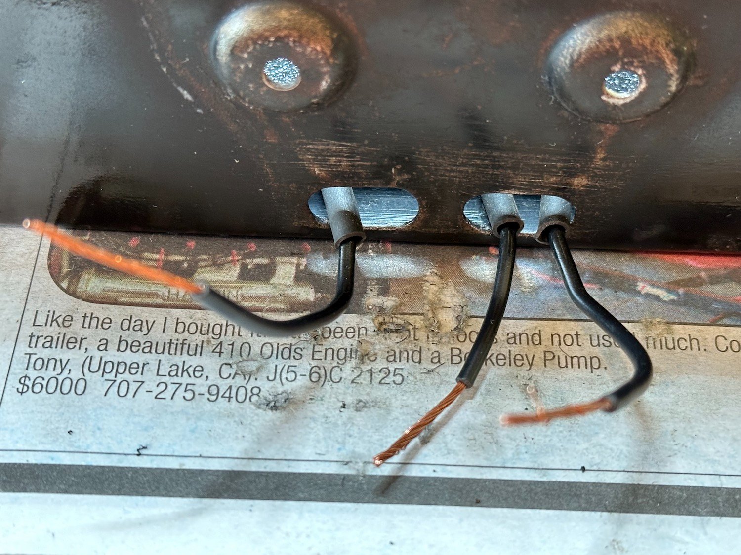

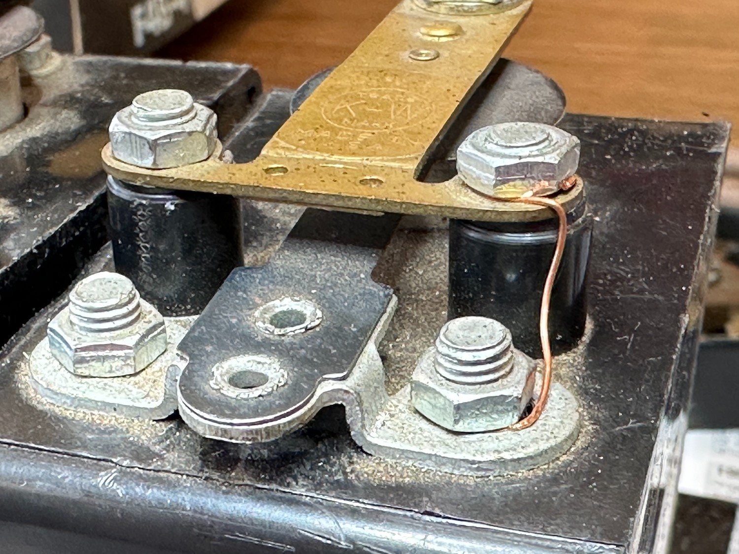

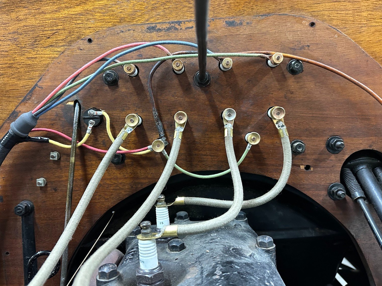

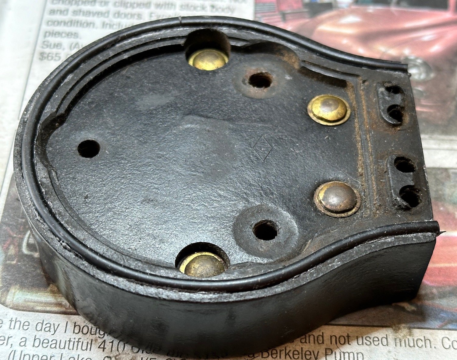

A couple of weeks ago I posted about a problem I'm having with my T. Its a 1914 Touring with a 1918 motor that has a starter & generator. This car ALWAYS starts until a few weeks ago when I had done a bunch of work & wanted to take a test drive. None of that work had anything to do with the motor, the closest I got was installing new leather clash strips on to the hood.
The starter ground normally but no fire, not even a pop. I suspected the switch as my '23 had a lot of trouble with the switch which acted the same way. Not knowing what to do to test any of this, I took it apart. I had one of the plastic wood kits in stock and wanted to replace the old wood so it made sense to look the switch over and do everything else at the same time.

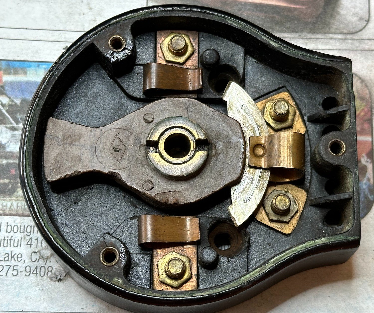

The switch turned out to be very simple and robust looking. I could see nothing wrong with it so it got a clean, with contact cleaner, reinforcement of the screw sockets with gel CA glue and some dielectric grease on the contacts & the central pivot. Thanks to Chris for these suggestions. Jerry showed me how to set my meter to verify connections so the switch was tested in all three positions. It works well.
I also added a couple of lengths of O ring to simulate the waterproof cord Ford originally installed.
The coli box kit itself is much like the old Fun Projects kit I installed on the '23 close to 20 years ago. The biggest difference being a lack of pilot holes for most of the screws. If I had this job to do over again, I would fully assemble the coil box with bottom & back paneles, coils & lid and only then run the screws.

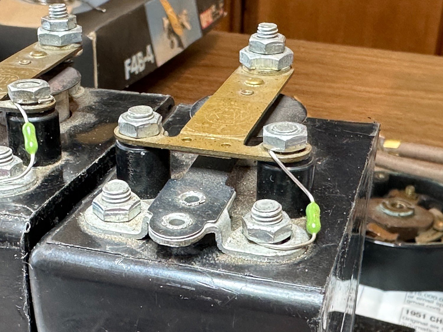

Speaking of coils, these are the plastic ones and they had a fine copper wire jumping the points. The E-Timer requires fuses and not knowing if these might be some special type of "fuse wire" I replaced them with the proper fuses.
Paul
Paul

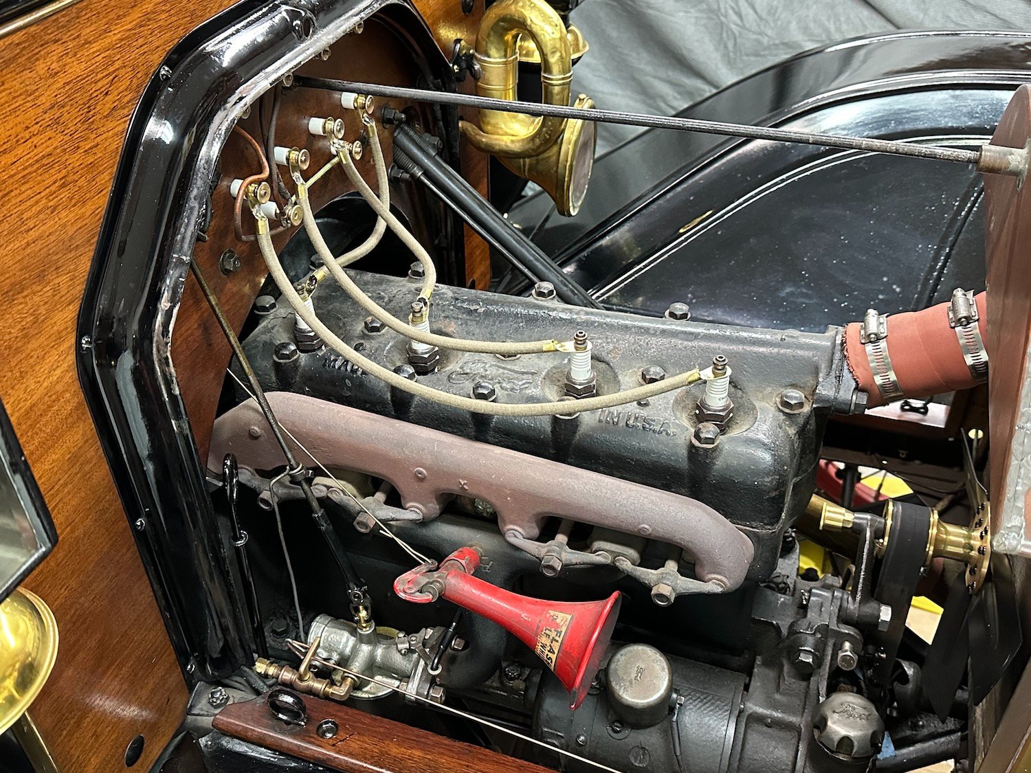

Here are some additional pictures

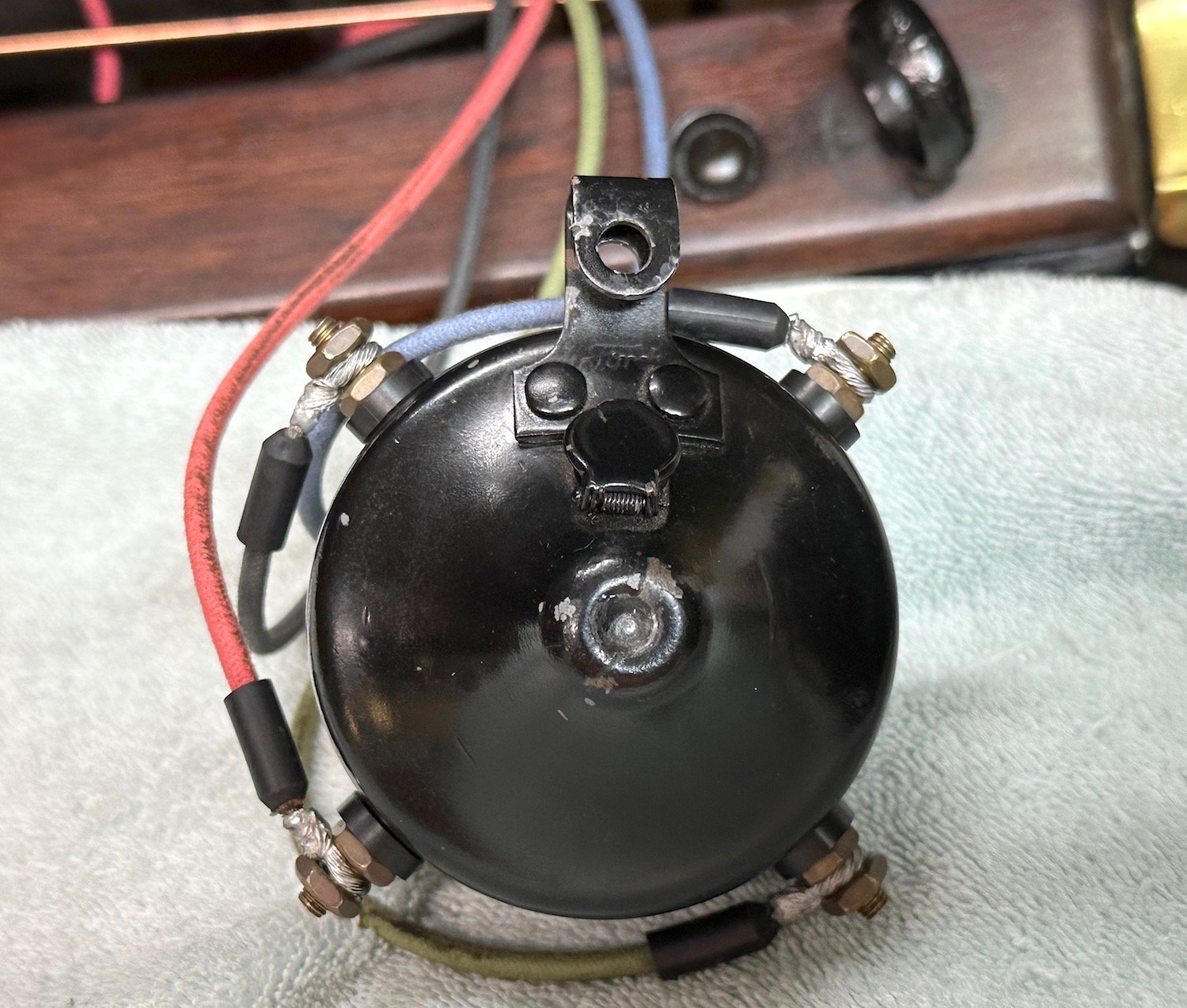

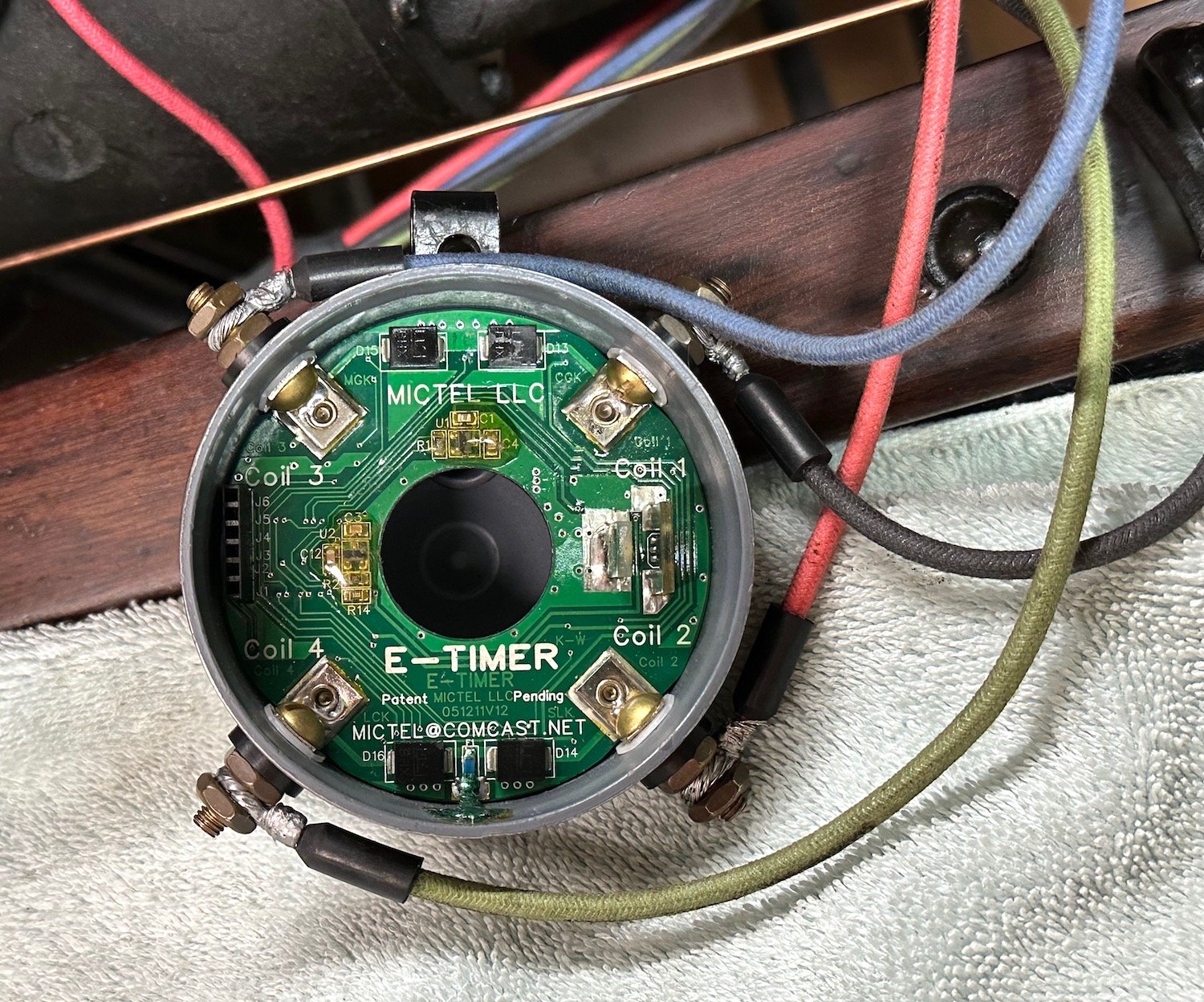

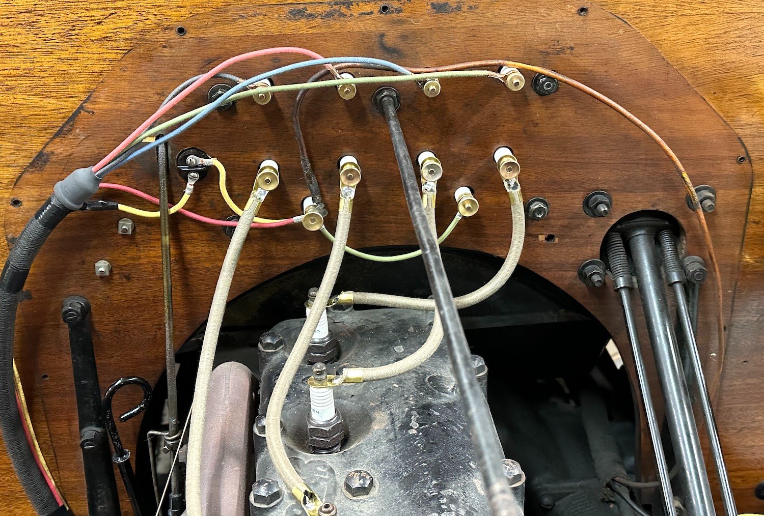

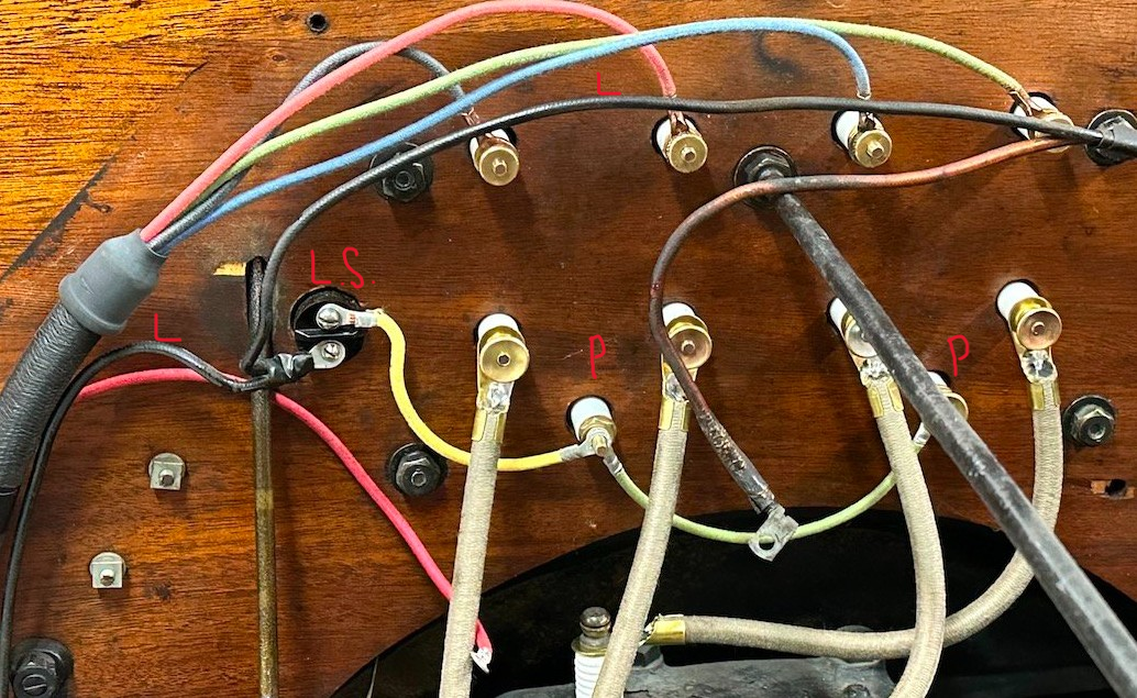

After getting everything on the coil box assembled again, the meter was used to verify connections to the switch from the MAG & BAT posts and each of the high & low tention posts to the copper contacts inside the box. All sweet.
With the box installed in the car and the coils in the box it all looked pretty good. New spark plug wires were used and routed away from other items as best as possible. They touch nothing.
I did make one modification. Seeing the E-Timer does not use the magneto, I disconnected the wire from it and ran a jumper from the MAG post to the BAT post. If I understand things correctly, this will allow the motor to start & run on either the MAG or BAT position.
Time test the work. As before, the motor ground over on the starter but no start, not even a cough. No spark at the plugs tested by the old screwdriver to the plug method. The electric lights do come on and there is more than 6v at the BAT post. I changed the E-Timer with a spare I keep in case of trouble. Same thing again, no start. Using the meter again I found no volts at one of the the terminals of the E-Timer.
Time for a beer or three and a think but sadly, I'm out of ideas. On reflection, the only thing left that is not new or reworked in the timer wiring loom. I bought one but did not install it.
The E-Timer has always been dead reliable so it is unlikely to have caused the initial trouble. I did remove the coil box cover with the switch on and might have blown the fuse but that was after the motor would not start. I read Mike's instructions too late to save this one but the second E-Timer was brand new still in its sealed bag and it was installed with the ground strap off the battery to forstall any issues.
What now? Is there something else I can check?
Paul
Paul

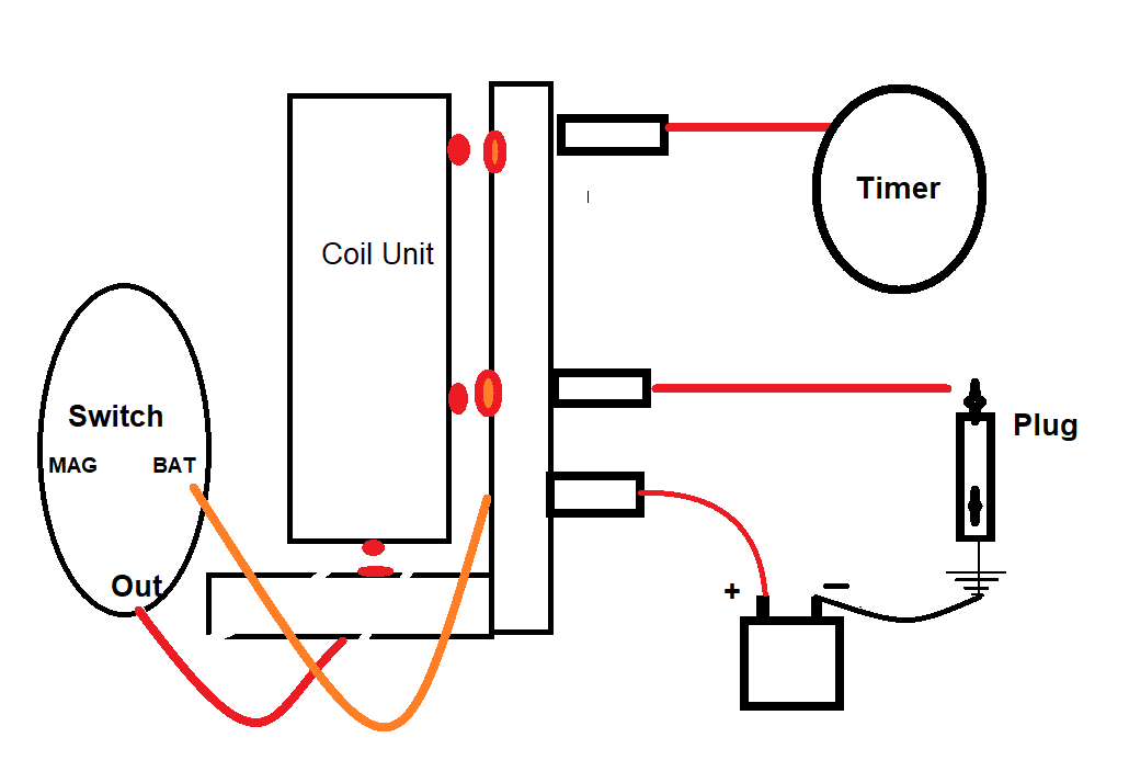

So you have constant power @ the coil box voltage in terminal? That would be the lower right.
You have power to the coil box & the switch on bat, but the coils dont buzz when you hand crank?
Mike Kossar is the guy to talk to about the E-timer & your jumpers. Dont forget to report what voltage you run.
If the old jumpers worked, why did you change them?.
Is your power wire(yellow normally) @ the starter switch on the battery in to starter switch terminal or on the terminal that goes to your starter motor?
You say the starter cranks over the motor just fine?

I think I am seeing a jumper wire on the mag & bat terminals, so if you have power there, the switch will work in either position.

Yes, there is power at the BAT post, more than 6v. Before installing the coils in the box I was able to use the meter to check the pathway from the bottom strip through the switch to the MAG & BAT posts. It is an Orange County car and when running was very happy on the backroads of Klamath County.

Paul, Maybe pull out a spark plug and lay it on the head so it has a ground and so you can see it when you crank the engine over with the key ON. See if you have a spark at the plug? This will let you know you are getting spark at the plug. You might be able to just disconnect a plug wire with a gap to see the spark.

I did the equivalent of this by using a screwdriver to short the plug wire to the cylinder head. Nothing on any of the four wires. Is pulling a plug as you suggest a more certain test?

The E-timer requires a 4A replaceable fuse at the coil box. It is not in the timer itself. I installed the fuse under my '26 coil box at the power-in terminal.

Lay all 4 plugs on the head. You can easily see & possibly hear each plug spark.

2nd last photo in your first post16 Aug. What are the green thingies connected across the coil points ???... are they fuseable links or they small capacitors ??? by mistake....n

Paul, I provided a detailed trouble shooting process on your previus post of 7/13. What were the results of each step in the process? Knowing those answers should promptly lead to the likely root cause.
I repeat that process here for convenience:
Here are a few troubleshooting suggestions:
With the car setup for normal engine starting (ie spark lever fully retarded, transmission in neutral, ignition power on set to battery, etc.) Slowly hand crank the engine and listen for coil point buzz while turning the crank 2 full revolutions. Each coil should buzz once after 2 crank shaft revolutions. Use caution when hand cranking engine because the engine may start even if it does not start using the starter motor.
1. If no coil buzz is heard while hand cranking the engine, check positive battery power (+6 to +12V) is present at each timer terminal using a DC voltmeter with respect to frame ground. (Be careful not to short the timer terminal to ground with the voltmeter probe or you may blow the fuse jumpers! ) If no battery power is present at any timer terminal, check battery power is present at the coil box battery terminal. If so, trouble shoot coil box power distribution. If not, trouble shoot why power is not getting to the coil box; the ignition switch is a common candidate vulnerable to contact failure. If this is the first time the car is being fitted with an E-Timer and battery power is present at the timer terminals, verify the E-Timer housing is making metal to metal contact with the mating surface on the timing cover. Newly rebuilt engines may have a fully painted timing cover that prevents the E-Timer housing from contacting engine ground. If so, remove the paint on the timing cover where it contacts the E-Timer.
2. If no coil buzz is heard during hand cranking 2 revolutions and battery power IS present at the timer terminals. The E-Timer internal fuse may be blown and will need to be returned for repair. Known causes of internal fuse blowing:
a. Metal coil box lid removed or replaced while ignition powered or operating, shorting coil points together or to ground while powered.
b. Improper routing of spark plug wires. Its good practice to route spark plug wires to remain a minimum 1" clearance from ANY other
objects between the spark plug and coil box terminal. Old, worn, dried out or cracked spark plug wire insulation can allow spark to jump to
adjacent objects such as other spark plug wires or timer wires which can damage the E-Timer. This is especially true for sharp edges of the
spark plug wire terminals. Your #2 spark plug wire looks like its sitting on or close to spark plug #3 in your first photo!

Actually, E-Timer failures are rare and I-Timer failures are even rarer.
Yes, instances of the internal fuse blowing are much more common, providing fail safe protection of external wiring faults, shorted coil faults and defective coil point faults. Such incidents are gleefully boasted as E-Timer or I-Timer FAILURES by the purests. In reality, the E-Timer and I-Timer should be credited in averting catastrophic damage or possible car fire from occurring.
One such instance was a coil point limit revit that cam loose, allowing the cushion spring point contact to always remain in electrical contact with the vivrator spring contact (ie points never opened) even when it was fully open against the coil core. The I-Timer fuse blew preventing a coil melt down and possible fire if the enging came to rest on that coil when shut off. There would be nothing limiting the coil current next time the ignition was turned on and Poof! Yep, could of just put on an original Ford mechanical timer and your back on the road and all fixed.. Right

I'm with Neil what is the purpose for the wire / fuse across the point contact? Does that stop the vibrator on the coils? Is that something done
with a E or I timer? I'm rather curios as I have a K-W elevated timer & the instructions I found said to eliminate the vibrators on the stock coils.
Do the E & I timers work the same as a K-W? If so is that why there is no mention of listening to the coils mentioned? Thanks for indulging my
ignorance.
Craig.
ignorance.
Craig.
Mark Nunn
- Posts: 1289
- Last Name: Nunn
- Location: Bennington, NE
Re: No Spark, No Start Even After Work
Craig,
The E timer bypasses coil points with the installation of the fused jumper. The E timer fires the coil at the best time without relying on point adjustment. The photo with the solid jumper wire will work but dues not have fuse protection. I-timer is more like the mechanical timer that relies on coil point performance for best operation.

There is a jumper on the "coil box" bat & mag input terminals. Either position of the switch will provide power to the coil box.
The mag post(off the HH) is not in play.

That added replaced jumper wire grounds out the capacitor inside the coil that is hooked between those two set of points.
Those points have to function to make a square wave that is kind of shaped by the capacitor to make it look like an AC Voltage.
A DC Voltage cannot be passed through the coils to increase the spark plug voltage to about a little more than 2,500 volts.
That increase requires an AC Voltage.
Your coil can operate for a short time with the capacitor clipped out of the circuit, you will see ore sparks across the points and they will soon weld themselves together.

I did not do the installation on this E-Timer and have no idea if the previous owner installed such a fuse. I'm not even sure where to look for it with this hybrid wiring system. It would have to be between the battery & the coil box someplace? I remember putting one in under the floor bords in the '23 but that had a different electrical setup.
Thanks Speedy T, I will do the spark plugs on top of the head test as you suggest. I was going to replace them anyway with a new set of Champion Xs that I squirrelled away some years ago.
Yes, John K, the gas was on during the attempted start.
Remember this car ran fine just a couple of weeks before. I did a lot of work on it but nothing under the hood or with any electrical bits.
Paul

Thanks Mike, sorry for the confusion, I got in a hurry telling the story. The battery was disconnected only to remove the coil box lid. It was reconnected to try the voltage at the timer terminals. I did not pay attention to which lead was grounded. I will run this test again with the black lead grounded and do all for terminals, battery connected & switch ON.
Just a reminder - This car came with an E-Timer. When it would not start, I removed the coil box lid with the switch on. I had some silly notion about jiggling the coils into better contact. After I read Mike's troubleshooting instructions I see that this was not a good idea.
After that, I switched the original E-Timer out with a new one that was still in its packaging. I really expected that with all of the work done on the coil box & switch and all the pathways checked with the meter that the car would start as it always had. I'm baffled as to why this problem continues after all of this work. There must be a fault someplace I have not considered. E-Timers have been dead reliable in the experience of the many folks I know who have used them including my own. The chances of two failing within a few weeks on one motor seem pretty long.
Paul
Paul
- Posts: 4472
Right. There would be little chance of both units failing, if a failed E-Timer were the sole cause of failure. However, if something in the car's wiring, or ???, caused the first timer to fail, it would most likely cause the second one to fail as well, if said problem had not been diagnosed and corrected. It seems as if at least one of those timers should go back to Mike K. to check for the blown internal resistor he refers to.

Was looking at the wiring to the coil box and was wondering what all the wires are for. One from the battery, one a jumper from MAG and the other two? Also the #1 has a dark outer spot form ? and th end of #2 looks frayed
When ever there are electrical issues I prefer to break the circuit into isolated segments and test them individually for CONTINUITY. Then connect them together one by one and test as I go for CONTINUITY. Realize you will get a negative voltage reading for a bad wire connection or a good wire depending on the cause.
I would pull the coil units out of the coil box and then test for CONTINUITY. no need to take things apart
1. for each spark plug from its coil box post to the plug's cap. Validates good wire connection
2. for each timer wire from the screw head to its corresponding post on the coil box. Validates good wire connection
3. for each position on the switch from the bottom contact plate in the coil box to the BAT post. Validates good wire connection

First thing to do is to immediately remove the jumper between the mag and battery post. It has absolutely no purpose, and worse, the minute you hook up a battery to your car you're destroying your mag/magnets. Given I don't see a lead from the mag to the coilbox mag post, I imagine the car is run just on battery, where the jumper enables the car to run regardless of switch setting ( no purpose)?
- Posts: 5253
There are no magnets or magneto. The jumper allows the ignition switch to work in both positions.
Its not an issue.
- Posts: 6581
Here is what he said from above "I did make one modification. Seeing the E-Timer does not use the magneto, I disconnected the wire from it and ran a jumper from the MAG post to the BAT post. If I understand things correctly, this will allow the motor to start & run on either the MAG or BAT position." So there is no connection to the magneto. BUT while it is not a problem, why have the option and confuse solutions.
Daisy Mae
- Posts: 523
- First Name: Kurt
- Last Name: Andersson
- Board Member Since: 2024
Sorry, I hadn't read all the particulars of your post and was just reacting to the pic with a big gulp....
Apologies for jumping the gun...

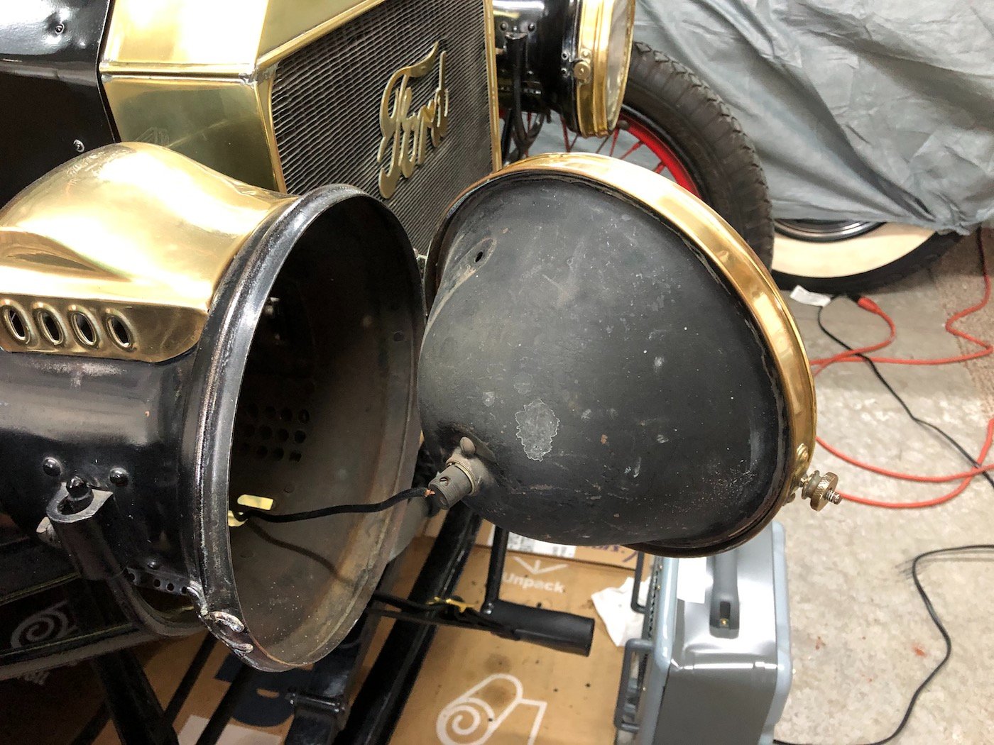

This is a hybrid car. It is basically a 1914 and would, if I understand it correctly have had no wires on the BAT post. It makes me curious why Ford spent the money to install one?
Someone later installed a 1918 engine with starter & generator. Also the lights were electrified at some point. So now the BAT post has a wire coming from the battery, another coming from the cutout and a third going to the electric light switch. I just added a jumper wire to the MAG post to allow the motor to run in either the BAT or MAG position. The magneto wire has been removed.
Speedy T identified the internal parts of the headlights as later T buckets squeezed into the old brass bezels. It might be a fun job to replace the bulbs. The switch was not working very well and I replaced it with a repop '15 switch which fit the mounting holes perfectly. Whoever originally electrified this car may well have just used later Ford parts.
Paul
Paul
- Posts: 4472
That's a neat trick with the lights!

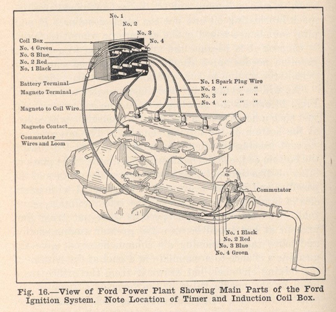

Your car would have had a battery connection originally. The battery would be be for starting purposes only. Once started, you would have switched over to Mag. The battery was normally a 6V dry cell, sometimes called a "hot shot" battery....if I understand it correctly have had no wires on the BAT post. It makes me curious why Ford spent the money to install one?
Hudson29
Topic author - Posts: 509
- Joined: Fri Mar 01, 2019 1:51 pm
- First Name: Paul
- Last Name: O'Neil
- * REQUIRED* Type and Year of Model Ts owned: 1914 Touring, 1923 Runabout
- Location: Klamath Falls, OR
Thanks Jerry, that makes sense but it was not shown in the wiring diagram. Did they come from the factory with the Hot Shot battery? Where was it located?

It could be that TRBxB2 is on to something.
Those two wires in the close up got hot or shorted for a reason so what is the reason.
The spark plug wire that’s laying directly on the burnt wire just isn’t good. Are you sure the burnt wires haven’t burned up internally under the remains of the insulation? Until you figure out what exactly goes where and the reason for it is the mystery. If the car was running well before it stopped something shorted out. Maybe the burnt wires in the picture?
But I guess that’s the question.
MKossor
- Posts: 546
- Joined: Sun Jan 06, 2019 7:30 pm
- First Name: Mike
- Last Name: Kossor
- Location: Kenilworth, NJ 07033
NOTHING should be within 1" of the coil box spark plug wire terminals, spark plug wires or spark plug terminals.
High voltage (10kV - 20kV) from the coil will always take the path of least resistance. Old, warn, or dried out wire insulation does not provide adequate isolation! Engine miss is very likely and and damage to the E-Timer or I-Timer is also possible.
Take the time to inspect your ignition wiring and route the wires properly if necessary. You may just rid yourself of that elusive and annoying engine miss.

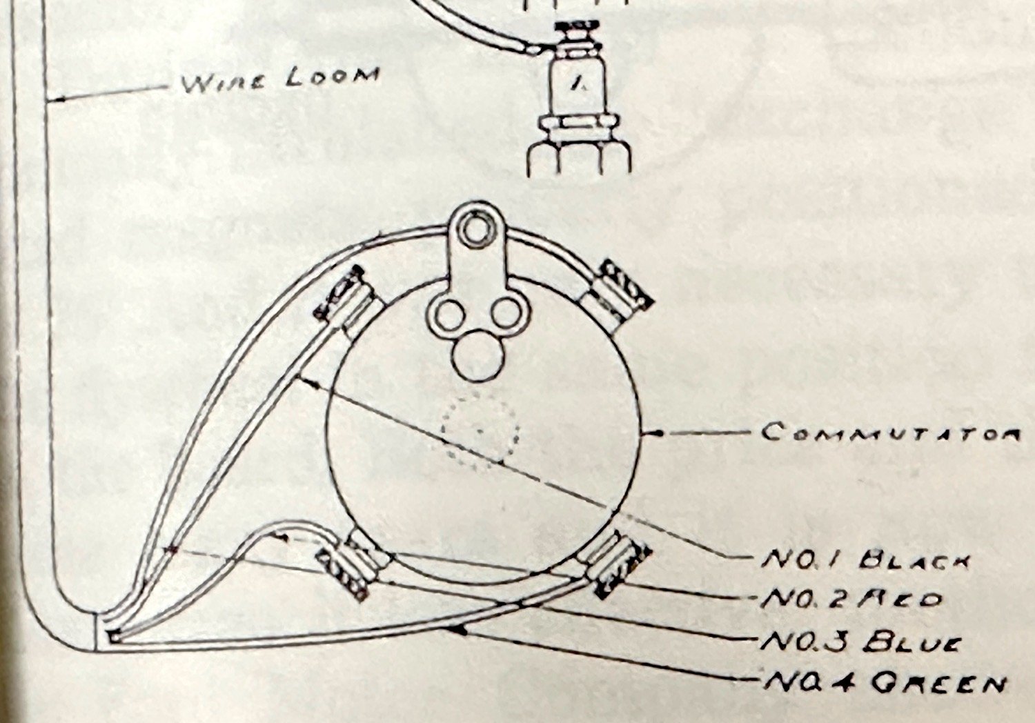

I did some work over the weekend to try to solve this ignition issue. Previously, the coil box was removed and "rewooded" with one of the plastic kits. All electric pathways were verified with the meter and found to work fine. The switch came apart and was cleaned and lubed. Once again the pathways were checked with the switch in three positions. it was asembled to the coil box and checked again, all sweet.
This weekend the hood former (is that the right word?) was removed from the firewall and the ancient commutator wiring harness was removed and replaced by a new one that was supposed to be the one correct for the year. In 1914 there were no lights or generator so there were extra wires installed to run these later additions. These wires were newer but I replaced them all anyway with new cloth covered modern wires of 14 gauge.
Once the new commutator harness was installed it was time to test the ignition. The headlight wires were not finished but that should not have mattered for the ignition test.
I started by testing the little green fuses on the coils, all OK. Next was the hand crank test with the battery connected and the switch ON. No sound That I could hear from the coils. Next the voltage was checked at the BAT post, 6.5 v. After that, the voltage was checked at the timer terminals - nothing. Then I checked voltage at the four posts where the commutator wires connected with the coil box nothing. Last, I tried to start the car. As before, totally dead.
So - now its all new, all correct as far as I can tell and still will not start. All of this was with the second E-Timer which should have been good as it was brand new still in its packaging. Could it have been killed by something I did? I sure don't see how as ALL work was done with the battery disconnected. I was very careful not to short the terminals to ground at any point or to mess with the coil box lid.
What next? I outta moves at this point.
BTW, I used John Ragan's helpful little drawing in the Club Electrical System book to make sure I wired the timer and posts correctly.
Paul, baffled

- Posts: 5253
Did you faithfully & accurately follow Mike Kossor's testing instructions?
Assuming the new unit install will fix the problem is a leap of blind faith.
Looking @ your wiring, You have no power going to your coil box unless you turn on the light switch. ????
You should read constant voltage on your lower coil box input posts.

As far as I can see, the light switch has nothing to do with the ignition in this circuit. Power comes in from the battery to the BAT post. From there it goes inside the coil box to the switch to be connected to the bottom common copper strips that power the coils. Have I got that right? What am I missing? I could try turning on the lights to see if the timer terminals get power but I sure don't see how that would make any difference.
I detailed in my last post about the testing procedure and the results. Did I miss anything?

- Posts: 5253
Yea try turning on the light switch.
I see a yellow wire from your coil box to a light switch terminal. I see no direct power.
I see other wires on the other switch terminal. I presume that's battery voltage. Get out that voltmeter.
If you are correct, you would read continuous battery voltage on those lower posts with the battery hooked up.
As far as your E-timer diagnostics, I have ZERO experience.
Normal diagnostics that I would use would damage it, I am told.
Do exactly as Mike K. says. It should have been clear if the timer is working or has power or not.
There is no thumb nut securing the wiring on the bat terminal.
- Posts: 4472
Where in this photo are you measuring 6.5V battery power??
Unless I'm mistaken in what I'm seeing...
The two terminals marked "P" should be delivering power to the coil box.
"L.S." would be your light switch
The two "L" wires would be your headlamp wires.
Where is "B", your battery lead??? There appears to be no power going to the P terminals, or the headlamps for that matter.
- Posts: 5253
Is the battery power @ that hanging burnt red wire that isnt hooked to anything?
If its hot, it goes onto the yellow wire light switch terminal or the Bat coil box terminal.
Hudson29
- First Name: Paul
- Last Name: O'Neil
I am terribly sorry for the confusion I caused by including a picture of the firewall that was NOT taken with the wiring in test configuration. I included this picture as well as the other three for the sole purpose of checking that I had the commutator wiring installed correctly. I should have stated this.
In fact, both the power lead from the battery & the cut out lead were installed on the BAT post for the test. I relied on others being able to read my mind . . .
More work was done after the test on the rest of the wiring. By the time its done all wiring forward of the firewall will be new.
For clarity the battery lead was on the BAT post as was the cut out lead & the light wire. That BAT post gave me a reading on the meter of 6+v.
As far as I can make out, I did follow Mike's instructions and included a list of the tests and results. My poor hearing may have negated the first one which included listening for the keening of the coils while spinning the hand crank. That keening, if it been there, sadly matches pretty closely the permanent keening in my ears. Years ago, I could hear that noise in the '23 but I have not been able to hear that sound in a long time.
Paul
Paul

- Posts: 7411
I'm not going back and rereading the entire discussion, but scanning down the page I see spark plugs mentioned. Laying them out on top of the engine and watching them while you pull the crank will tell you that high voltage from the coils is reaching them. It will NOT tell you whether they are any good. For that they will need to be tested under compression in a spark plug tester. Chances are they are fine. But until you see them fire in a tester you won't know for sure.
I suspect your problem lies somewhere in how things are wired, such as a wire connected where it shouldn't be or disconnected from a place where it should be. I'm guessing that you have a wiring diagram for a starter car. Let's remove that complication/distraction/red herring. I'll post a diagram showing the basic ignition system, and not the post-1919 extras. Remove (disconnect) anything not included in this diagram. That is the basic system at its simplest. If you follow it in detail you should have your ignition system good enough to start and run the engine.
The diagram omits the wire bringing current to the battery post. You will want to install a wire from the battery there.
The "hot shot", often a telephone battery, was usually located in any convenient place a wire would reach (under a seat, on the running board etc.). They were very cheap. Today they're expensive. You will do better with a car battery from the local farm supply.
Hudson29
- First Name: Paul
- Last Name: O'Neil
Thank you all so much for your help. As you can tell, I'm out of my depth with electrical matters even though I am learning pretty quickly. I just had a long phone call from an old pal in the Orange County Club who is an electrical sort. He went over some troubleshooting basics and as some of you have pointed out, the confusion I caused by posting that picture of the firewall with the wires all ahoo because I had moved on to other electrical work. The pictures below ARE representative of the way it was during the test.
The wire coming over from the starter area that is red but turned black by the time it hits the BAT post is the hot wire from the battery. That battery is fully charged and spins the motor over normally for a 6v Model T. There is 6v+ at that BAT post.
The bright red wire on the BAT post goes to the cutout, it is new.
The yellow wire from the BAT post goes to the hot side of the light switch. It is also new and will have a left headlight and tail light wire added to the bottom terminal of the light switch to go with the right headlight wire already there.
The green jumper just allows the switch to be used in either battery or magneto position. The magneto is of unknown quality and cannot be used with the E-Timer.
Paul
Paul

- Posts: 2967
- Last Name: Hjortnaes
- Location: Men Falls, WI
I believe this wiring diagram is close to correct.
I would install a junction box like Ford did originally. Remove the extra wires on the coil box, and wire your car
up correctly. Only install the wires needed to get the car to run. Forget about the lights for now. You can wire
them in later. Disconnect the wire from the magneto so it is not damaged and try to start it on battery.
Unfortunately you seem to be running in circles and getting nowhere.
Good luck.
Good luck.
