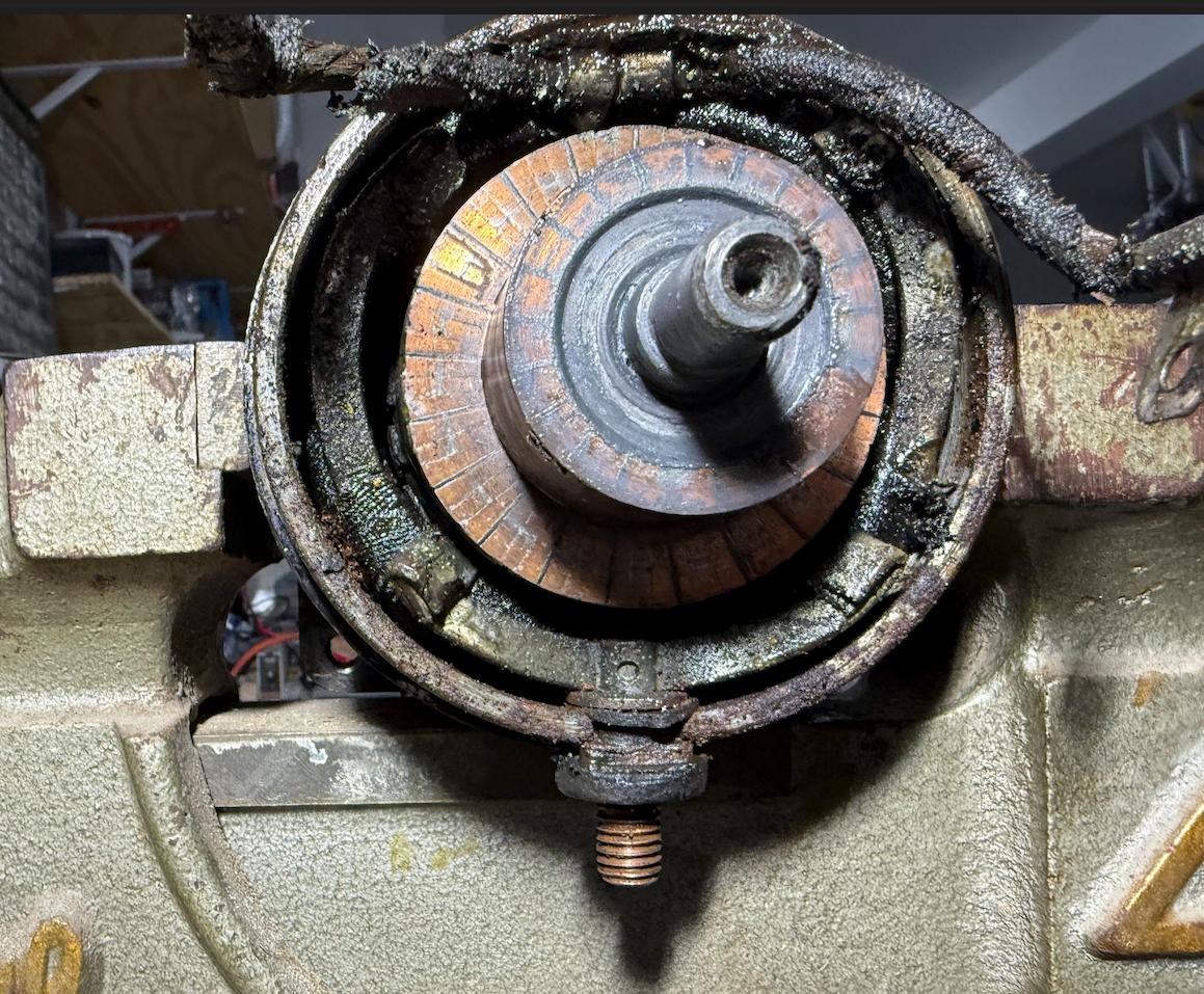

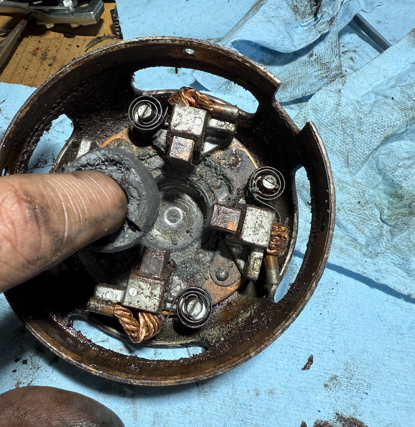

Below I will put in some pics. But I am looking for part number 5106. What is it called? how to get it? This ring is made of metal but it is almost evaporated.

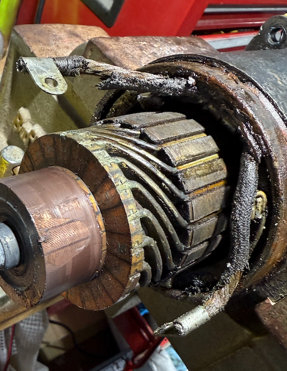

The insulators and communicators seem to have expected resistance. The fabric on the wires coming from the starter fields is basically gone. Should I add fabric or electrical tape? I really dont think I need to replace the starter fields ($120) as it seems the fabric wire insulation is the only thing wrong. Thoughts?
Should the inside of the starter be this dirty? Is this a sign that the rear bushing need replaced?
I suspect some of you would say since I have it taken this far apart, might as well rebuild the entire thing back to new. But I am interested if I should do that or just test and replace those things that are needing it.

5106 is the rear bushing, originally pot metal, as yours was. Replacements are bronze, or you can opt for a ball bearing race and a suitable spacer.

Thanks for the quick response! I just found that on Langs and ordered it. I will also replace the brushes since I have this open. Any concerns of only replacing the brushes and this bushing (and the front and back cork gaskets (which was the initial intent of me doing this winter project)?
Specifically wondering if the cloth insulation around the wires from the field coils. Overall, it is 100 years old, but does not seem terribly beat up. I assume this looks normal? Im not opposed to doing this first and then later rebuilding it completely...but looking for insight to how much to rebuild now vs later...

Based on what a PITA it is to remove the starter in the first place, the more you can do now, the fewer problems you'll have going forward.
The cloth on the field coil leads is important to be in good condition. If not then you risk those leads shorting out. I've seen some folks use electrical tape. Not a good idea bc oil gets into the starter and the tape just comes undone. I've used heat shrink tubing in the past with good success. It needs to be large enough to pass the spade connectors through though and shrink enough to cover the wire. The cloth on the fields themselves is almost always not salvagable, so don't remove them and you might be ok. I *always* use new field coils on my rebuilds so I don't have issues in the future. Also, don't use corrosive sprays to remove grease. They eat away insulation on wiring, commutators, etc.
