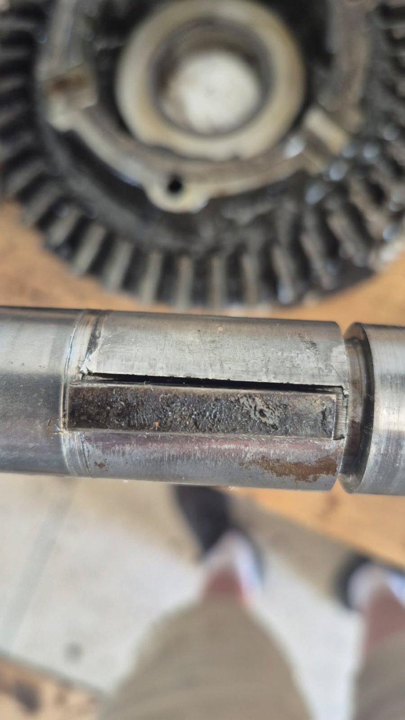

One axle I know for a fact is original....
I'm surprised it's still intact... Needless to say, Daisy has seen a lot of hard miles, and obviously endured a lot of high torque conditions...
I just wish they could talk...but she's definitely telling a story!!!
The other axle has a stamping that's not quite clear... is it an H/R/B - C/G - S/8...????? Anyone know???
While I still had to press the axle gears off, they did show torsional wear given the keys and axle key slots were badly worn...
Getting back to the driveshaft roller...boy did it endure a lot of torque twist with as much wear clearance existed....I'm surprised it's still intact... Needless to say, Daisy has seen a lot of hard miles, and obviously endured a lot of high torque conditions...
