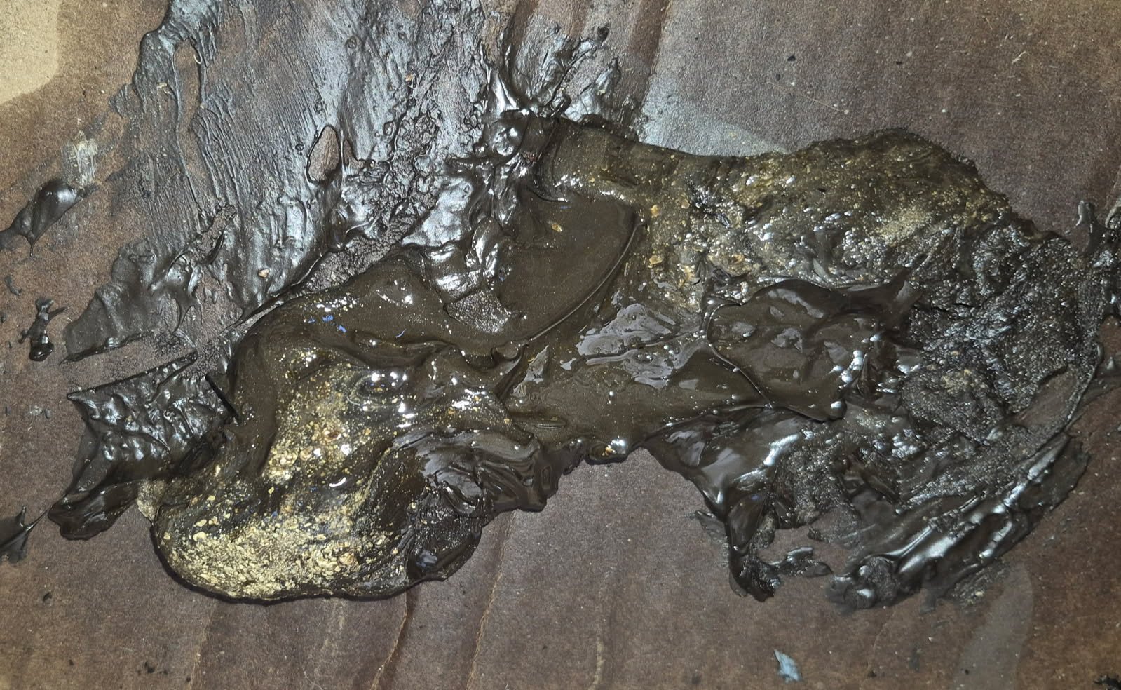

Post by Daisy Mae » Wed Apr 16, 2025 6:00 pm
Lots of bronze from the spider bushings glistening in the sludge!
