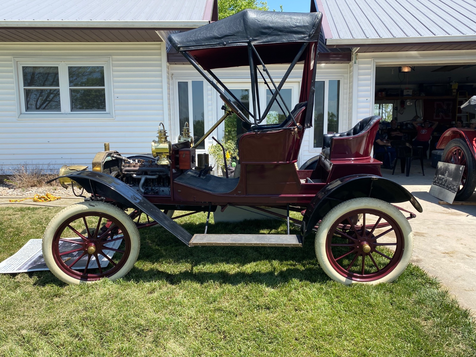

Re: What Have You Done To/With Your Pre-T Ford This Year?
Post by Robert Kiefaber » Tue May 13, 2025 12:24 am
Made a vanity license plate for my model F.
Posts: 4243
Post by Jerry VanOoteghem » Tue May 13, 2025 6:22 am
Bob,
I like that F! Thanks for posting!
