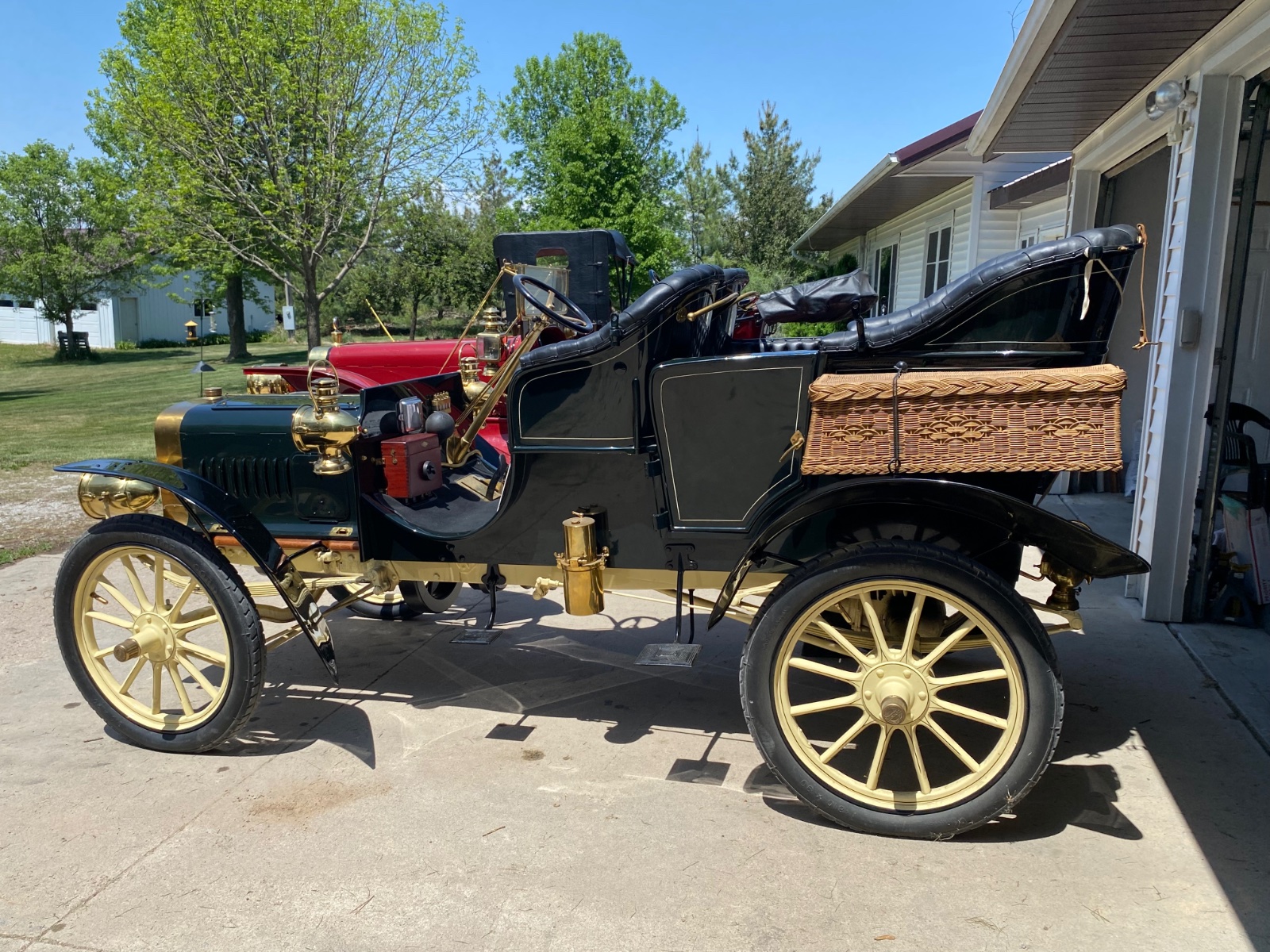

Post by Rob » Wed May 07, 2025 12:11 pm
Been driving the 07 K daily, getting ready for the ABC tour in Pennsylvania in a week and a half.
Just back from town this morning.
