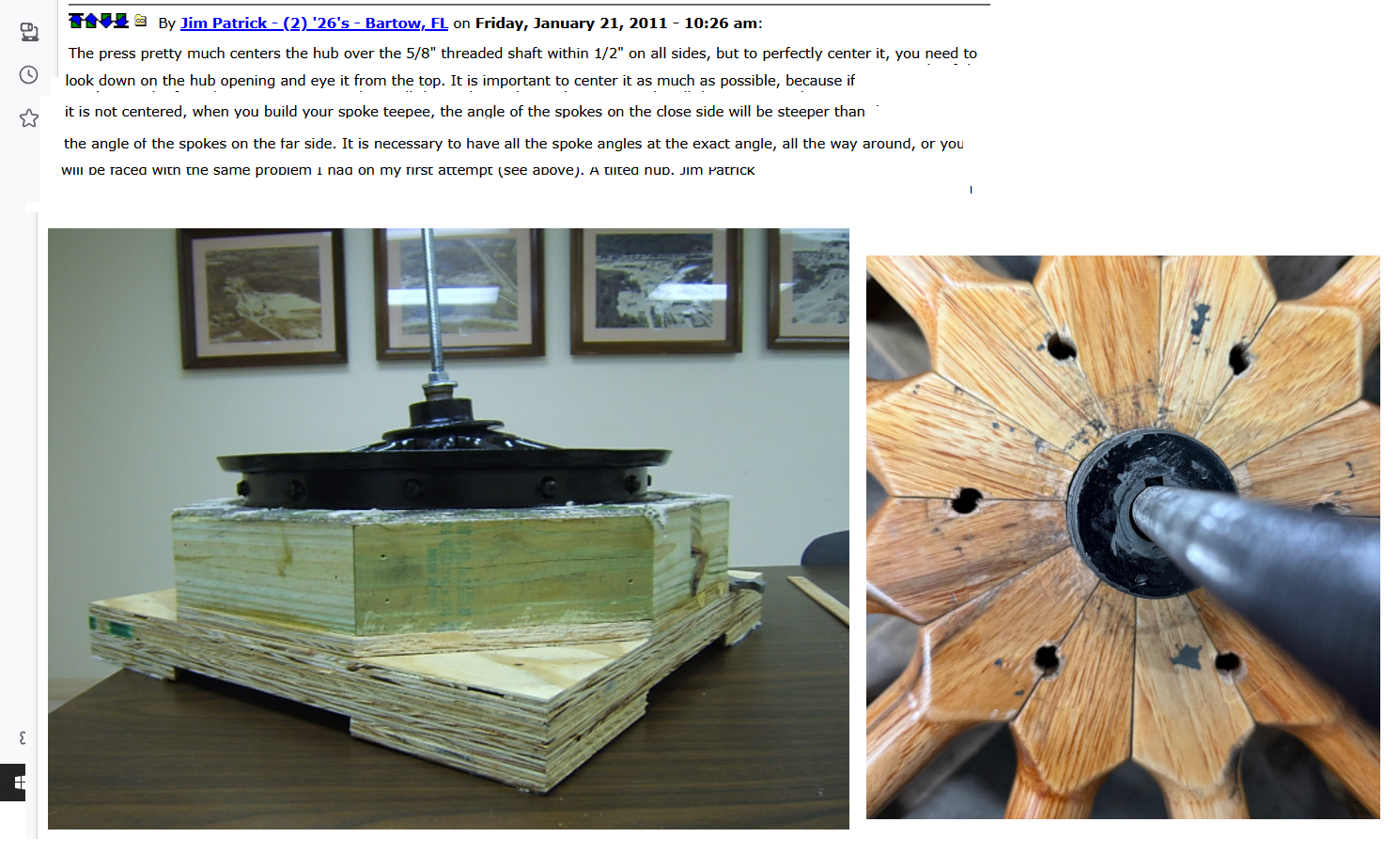

First time wheel rebuilding. They're Hayes wheels, bought Hayes spokes. First problem was the tenon was slightly too big to press into the fellow. Turned one set down, as an experiment (before doing all 48). Got them pressed in.
Was all excited then decided to mount it on the car and spin, wobbly. About a 1/2"! So I check the felloe, it's true. I check the hub, it's true too.
So I decide to take the wheel all apart again and notice this is how the center looks. Seems odd to me?
Anyone who's done their own wheels have any input? I'd greatly appreciate it!

I have seen the term "clocked" to describe what has happened with your wheel. Sometime in the assembly/pressing the felloe has rotated a bit in relation to the hub centre, which causes the misalignment of the spokes at the hub. Somebody with more experience than I may have the solution to your problem.
Like this! I'll have to try again

So, I took it all apart and tried again. I was under the assumption the spokes would settle in the correct position as they compress. So I noticed one side going down further than the other. Stopped and smacked the hub on the high side and it leveled back out. Went slow and kept checking.
My holes no longer lined up, which is good. Meaning they're positioned differently.
No longer "clocked"
Mounted before drilling new holes. Has about a 1/4 wobble now. Acceptable for me on a rear wheel. I've learned a lot now, so hopefully the next three will come out mint!
These spoke sorta got beat up from the trial and error, which may be leading to the slight wobble. If so I'll Respoke it in the future.
Thanks for the advice everyone!

First the spoke tenons should fit very tight in the felloe, my experience was I had to rub them with bees wax so they would compress into the
holes. I had the same issue that you are having with the spokes trying to clock or rotate in one direction @ the hub. what I found was if you
support the spokes in the center & lay the tenon on the the felloe the spokes fit together @ the center very well. Measure the diameter of
the hole in the center. I think you will find it is smaller than the diameter of the hub. One would think the spokes should fit tight on the hub
but it is just as if not more important that the spokes fit tight against each other in order to hold the load. If they contact the hub before
they fit together they will try to rotate either CW or CCW. I had to carefully remove material from the center end of my spokes to get the
proper fit, fortunately one of the wheels on my B&D belt sander is the same diameter as a T hub so it was not overly difficult once I figured
out that was what was needed. If you have a way to shorten the spokes @ the tenon end that I would think will work as well. Also some rim
lock bolts will line up with the tenons & will not let the rim center on the felloe & you will need to remove some of the end of the offending
tenon. this can be very frustrating, I almost went to wire wheels over this. Now I'm supper happy with the new spokes. Good Luck.
Craig.

I found a process that works! You have to do the wheel facing down (outside down). Set the spokes up as a teepee, with a nut and some sort of holder below. Smaller than the outside plate so marks are covered.
Ideally, loosen the lower nut and then tighter the upper nut. While doing this, keep checking the spokes are flush, and no clocked.
It's a slow process, but works the best. Worry about pressing the hub in after. Got two more done with tiny 1/4 wobble. My only gripe is the quality of the spokes. Some spots chipped at the hub end.

Would the plate used (vs a hub) have caused the clocking by not keeping the spokes from creeping up? Also with a hub tilt be another cause?
https://www.mtfca.com/discus/messages/1 ... 83733.html

I am fortunate enough to have a good friend with a large hydraulic press with incremental foot control for the ram travel. Even with our Canadian spokes with the double taper, they can be a problem. With his press there is no chance of cocking the load on the spokes like the photo shows using the Reagan press. I set up the wheel in the press with the hub flange and the wheel felloe supported. The spokes are pressed down with a generator body as the driver. The press allows a decent drive to push the spokes home. The last one I did had shims on the tenon end, so it was extra tight. It was perfect straight off the press. Just had to bolt the outside plate on when finished.

I keep posting but I'm pretty sure nobody ever tries it but oven drying the spokes prior to assembly makes them smaller in every dimension which solves the tight tenon and the clocking problem and produces the truest wheels I have ever assembled. They just have to be re-hydrated after assembly to swell the assembly back to the original sizes.

Of course the last wheel has to be the most difficult. After 3 evenings after work, taking apart, pressing, spinning, she was very wobbly.
So, after thinking a bit, I decided to give a try with using a hydraulic press. It work out quite well. Left the spokes in the teepee form, set everything up and pressed it down with the retaining plate on too. That way I could drill the new holes and bolt it down before releasing the pressure.
Not sure of its true yet, darn thing has to be!

All this is why the wheelwright I used would bore the hub hole after the spokes were in the fellow.
His wheels ran true every time.
