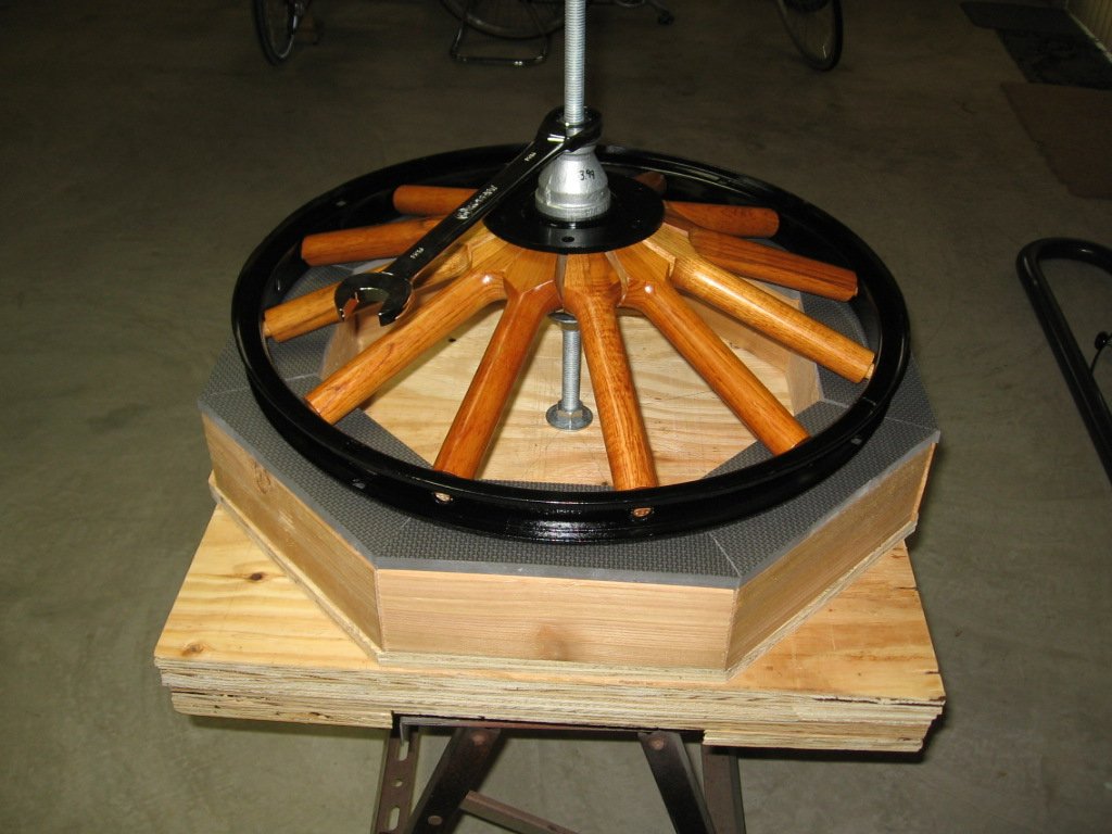

UPDATE!
I found a process that works! You have to do the wheel facing down (outside down). Set the spokes up as a teepee, with a nut and some sort of holder below. Smaller than the outside plate so marks are covered.
Ideally, loosen the lower nut and then tighter the upper nut. While doing this, keep checking the spokes are flush, and no clocked.
It's a slow process, but works the best. Worry about pressing the hub in after. Got two more done with tiny 1/4 wobble. My only gripe is the quality of the spokes. Some spots chipped at the hub end.

Would the plate used (vs a hub) have caused the clocking by not keeping the spokes from creeping up? Also with a hub tilt be another cause?
https://www.mtfca.com/discus/messages/1 ... 83733.html

I am fortunate enough to have a good friend with a large hydraulic press with incremental foot control for the ram travel. Even with our Canadian spokes with the double taper, they can be a problem. With his press there is no chance of cocking the load on the spokes like the photo shows using the Reagan press. I set up the wheel in the press with the hub flange and the wheel felloe supported. The spokes are pressed down with a generator body as the driver. The press allows a decent drive to push the spokes home. The last one I did had shims on the tenon end, so it was extra tight. It was perfect straight off the press. Just had to bolt the outside plate on when finished.

I keep posting but I'm pretty sure nobody ever tries it but oven drying the spokes prior to assembly makes them smaller in every dimension which solves the tight tenon and the clocking problem and produces the truest wheels I have ever assembled. They just have to be re-hydrated after assembly to swell the assembly back to the original sizes.

Of course the last wheel has to be the most difficult. After 3 evenings after work, taking apart, pressing, spinning, she was very wobbly.
So, after thinking a bit, I decided to give a try with using a hydraulic press. It work out quite well. Left the spokes in the teepee form, set everything up and pressed it down with the retaining plate on too. That way I could drill the new holes and bolt it down before releasing the pressure.
Not sure of its true yet, darn thing has to be!
Will find out tonight when I can mount it on the car.

All this is why the wheelwright I used would bore the hub hole after the spokes were in the fellow.
His wheels ran true every time.
