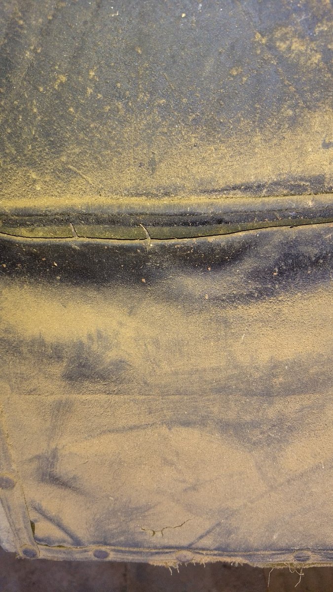

I have the original top back on, it’s shrunk a little so it requires stretching to make it more level at the front
