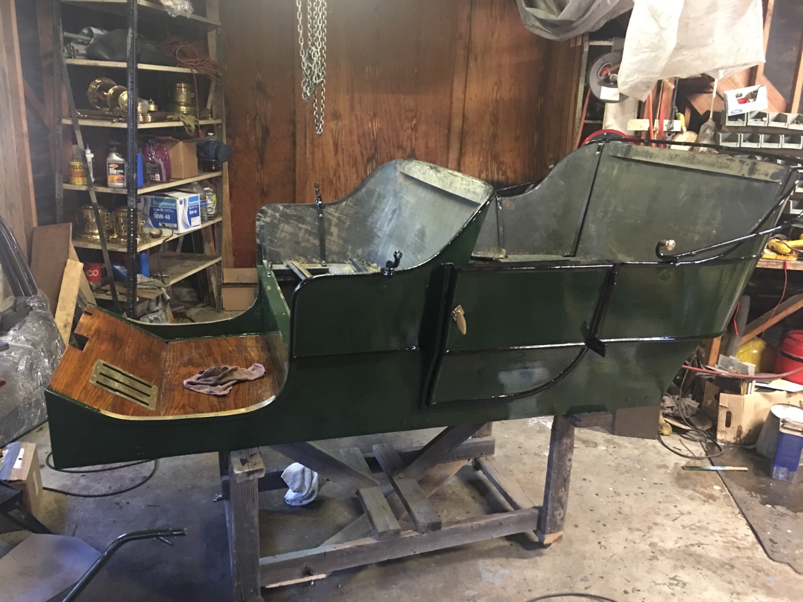

I had a complaint that I’ve not been posting about the 09 for a few weeks. I have been painting the half round beads that run around the body. Funny but the body is not vertical but the beads are horizontal, so laying the tape on the corners is difficult due to the compound curves with flat tape.
I think the doors are done and ready for a coat of clear varnish. I went down the sailing stores in Point Loma and bought the same varnish that I used on our boat years ago. It has lasted very well and well worth the money over the cheaper box store brands.
I have been using the kick panel under the drivers seat as my test area. The varnish there has been very successful.
I have had a little bleeding of paint under the tape, I suppose s#*t must happen. I’ll get a smaller brush and fix a couple of spots by hand when I feel real steady. One problem is the time to keep the tape on the body. They recommend no longer than three days. It’s tough to get enough coverage in that time as slow as I worth these days.

You're using the wrong tape. Go to a body supply and get what they call "fine line tape". Comes in various widths. It's easier to manipulate into contours, but most importantly it is clean and smooth on the tacky side so that the new topcoat won't bleed underneath. Common masking tape isn't designed to hold a sharp edge.

Live and learn

It’s my understanding that Frog brand tape is for water based paints. The tape is designed to react with the water in the paint and provide a close seal at the edge, thus giving a very clean line. Of course I’m using enamel based paint so it will not be as effective.

Automotive masking tape is expensive but works and will come off after you paint without problems. Only thing is it might pull off any loose paint so a trick we used was to "kill" the tape a little on your leg to remove some of the glue. Stick it to your pants leg and remove it one time before you put it on your paint. It will come off a even month later easy so you can work at your own pace. It has been a while since I bought any but it was about $4.00 per roll last time and worth it. I buy the cheep stuff for less important places like holding paper to paper on a window and save the good stuff for anything that touches the car. 3M makes the stuff I use and it comes in different sizes and holds up very well to paint and solvents.

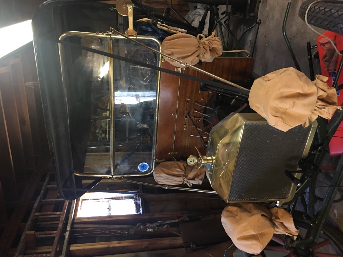

In spite of my travels and tours, I’m still getting bits done. This last week was on the windscreen mount, one of which was broken and been welded solid in the incorrect position. With the encouragement of Art Wilson I spent a couple of days on the lathe and mill with bits of brass and now it works.
My daughter Carolyn has been getting in on the act and made a set of lamp bags. They came out great with ties so they will stay on and be fairly effective at reducing air flow. I have the original top back on, it’s shrunk a little so it requires stretching to make it more level at the front Finally before I leave on yet another trip I have the parking brake installed and the floorboards in. When I get back I will remove the top and have a go at re-installing the original upholstery. Wish me luck.
It’s not quite the same shape as the original, which was rounder rather than bull nosed, but I think this will be stronger and less liable to fail. My daughter Carolyn has been getting in on the act and made a set of lamp bags. They came out great with ties so they will stay on and be fairly effective at reducing air flow. I have the original top back on, it’s shrunk a little so it requires stretching to make it more level at the front Finally before I leave on yet another trip I have the parking brake installed and the floorboards in. When I get back I will remove the top and have a go at re-installing the original upholstery. Wish me luck.

I had another pleasant surprise when I returned from England. My daughter has made bags for all five brass lamps and a radiator cover.

I have done some more work over the past month, I now have the fenders back on the car and wheels painted.
There was a monument of confusion as there are four holes in the wood hood former under the hood. On the drivers side I put the bolts in the outer two holes and the clips in the inner two holes. However when I did the passenger side I had the correct long bolts and the holes in the lower chassis member were under the inner holes. From this I checked the lower holes and sure enough the bolts should be in the inner position. Odd really as the hood has wear markings in both position.
Next is finally fixing the top, polish the hood clips and then I’ll start installing the tires.Tony Bowker
