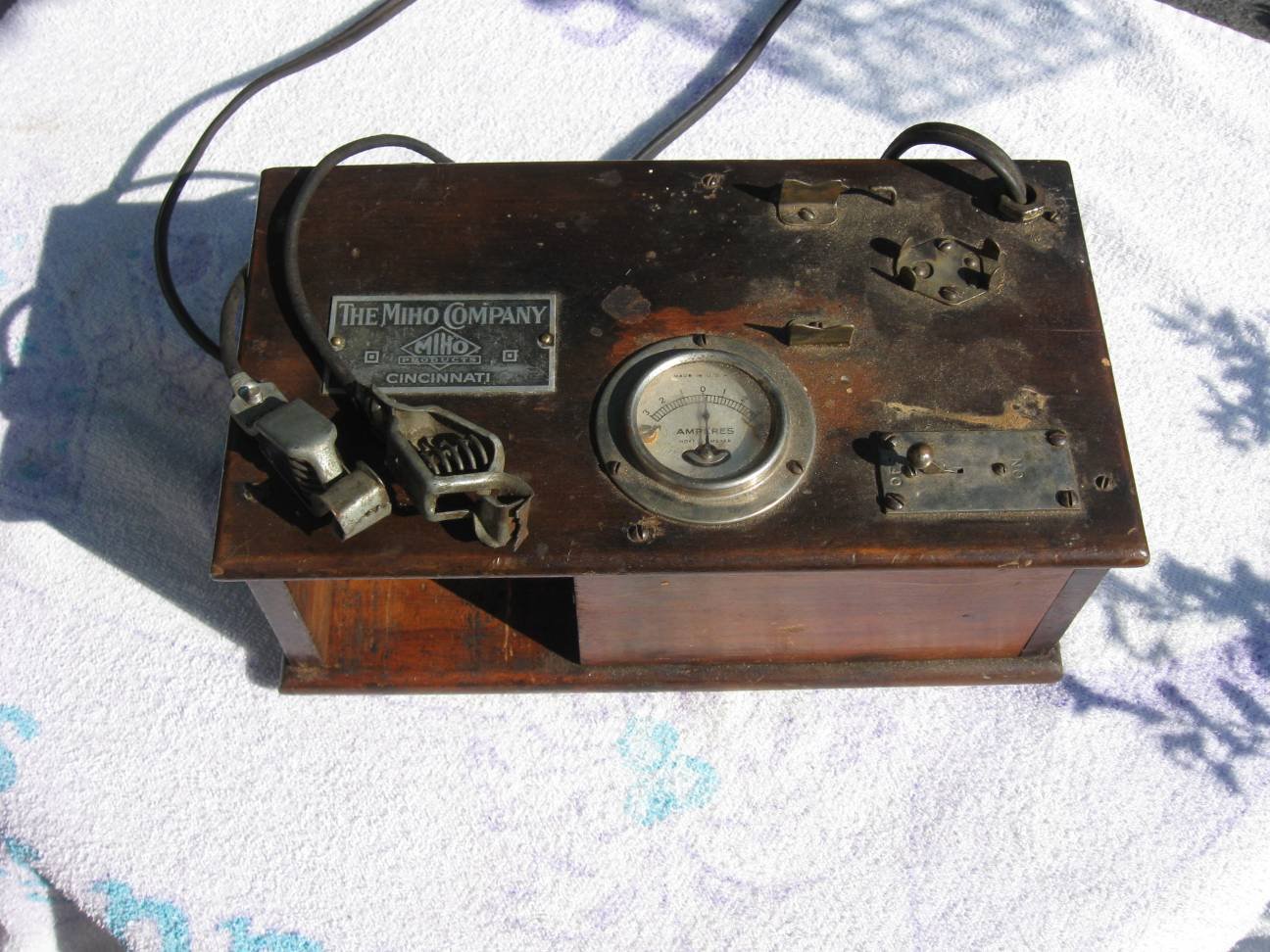

Foot Note: Circa 1906 - The early Rolls-Royce cars had used a trembler coil to produce the spark with a magneto as an optional extra which soon became standard - the instruction was to start the engine on the trembler/battery and then switch to magneto. Part of an Ignition system for an early Rolls-Royce:

Re: question on how to adjust/test coils
I was a buzz box guy. Even built and sold a few on E Bay. This was years ago and I was taught a lesson when a friend who lives not far from me contacted me through the Forum. He had an HCCT and did coils for the local club. I had rebuilt mine, ( cap, points etc ) and he came over and set them up for me. My car started, dead cold, on the hand crank after we reinstalled them. Brother I was sold.
- Posts: 7938
A buzz box is much better than trying to adjust coils "by ear". But an HCCT is FAR BETTER, and an ECCT is best.
