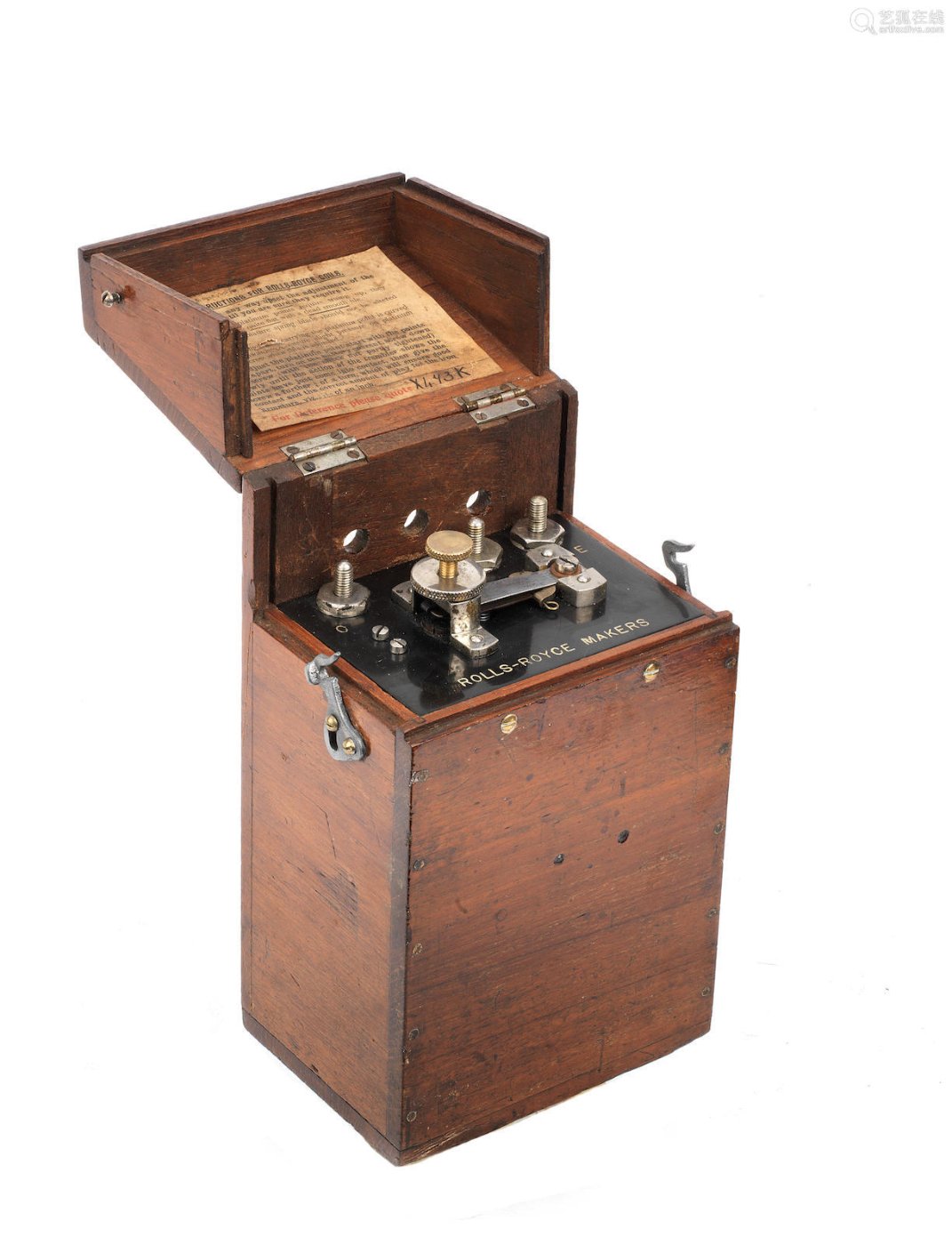

Foot Note: Circa 1906 - The early Rolls-Royce cars had used a trembler coil to produce the spark with a magneto as an optional extra which soon became standard - the instruction was to start the engine on the trembler/battery and then switch to magneto. Part of an Ignition system for an early Rolls-Royce:
