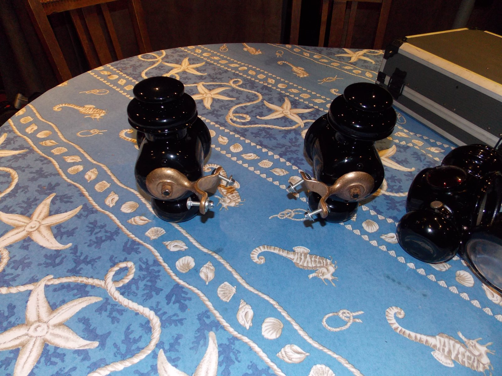

Post by AndreFordT » Sun Nov 23, 2025 3:09 am
Not only the wheels were different.
Those cars had also two petrol side and a rear lights.
The brackets of the front lights are fixed with the two upper bolts of the windsheeld support.
The rear light had the small lens (red) pointed to the rear and the big lens (door) pointed to the licence plate.
(See photo's)
(They came with my 1926 runabout)
The contact switch plate had no amp meter (must have some photos of this somewhere)
The place for the amp meter was flat. On the back there was a resistance for the front lights working with the marneto.
Just what I know about.
Andre
