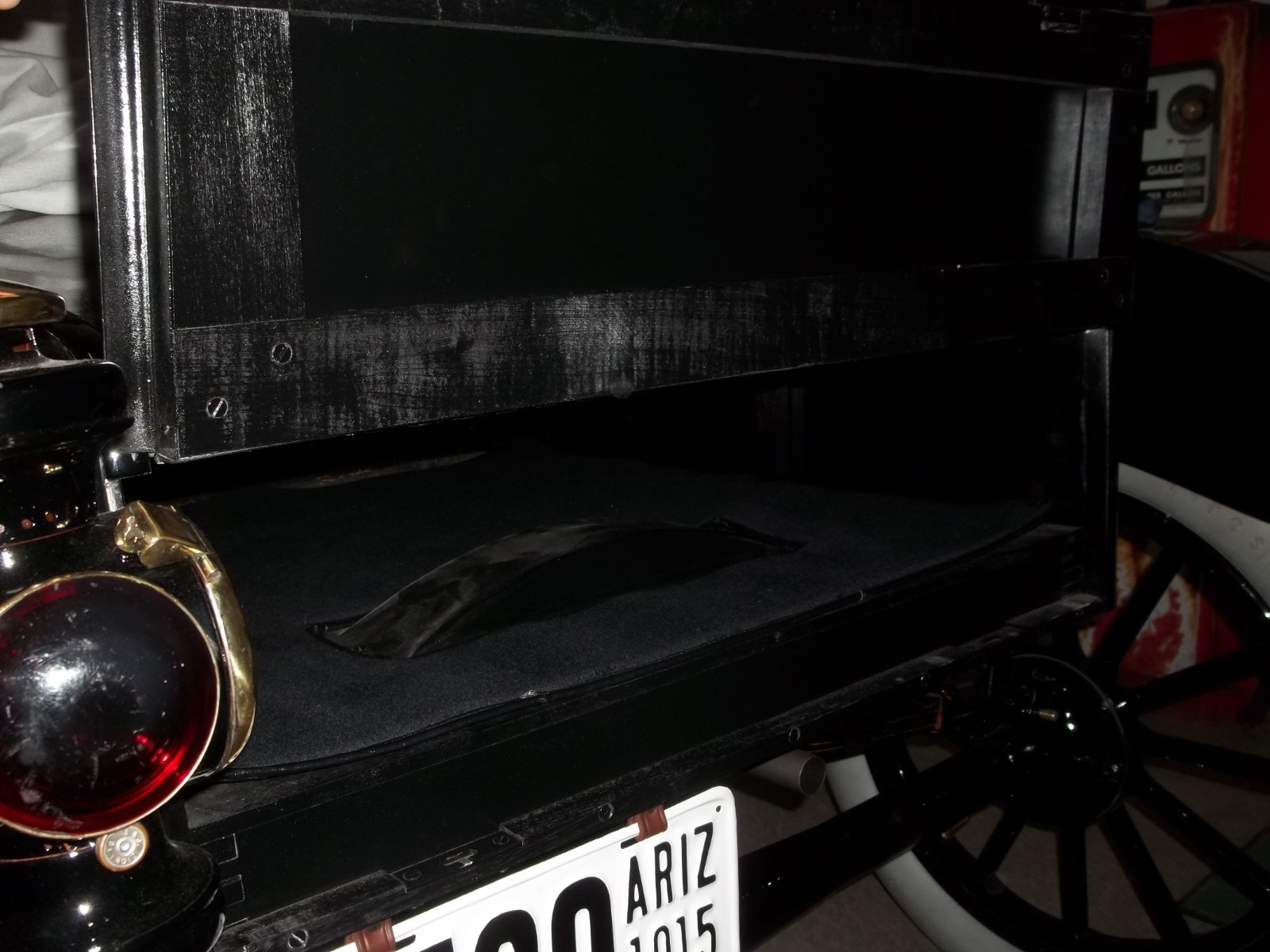

Post by Wayne Sheldon » Sun Sep 01, 2019 5:26 pm
Beautiful car! And such an amazing quality restoration. You should be quite proud.
At some point, I would love to see a good picture of your tail-lamp. I really like those earlier '15 style side-lamps.
Absolutely wonderful!

Post by Russ_Furstnow » Sun Sep 01, 2019 7:30 pm
Wayne, Here you are. The E&J Model 7 tail lamp came in two styles. The tail lamp on this car has a "blade" type mount and there is also a bolt and nut type mount like the E&J Model 9 tail lamp. The most interesting and worthless feature on this car is the tailgate at the rear of the trunk. Very little can be loaded into the trunk with this tailgate. Ford decided to change to the typical trunk lid on the top of the trunk for the 1916 coupelet, which was identical to the later coupes. Here is a photo of the side lamps, which have the blade type mount.

Post by Wayne Sheldon » Sun Sep 01, 2019 11:16 pm
Thank you Russ F. Quite an unusual tail-lamp I would think! Like the very much later Ford "O" tail-lamp, a small red lens with larger clear lens aimed at the license plate, mounted on a spade, and the brass bezel/door hinged at an odd angle. I wonder how many variations of side and tail lamps Ford used between the early September and October '14 closed (?) body cars and say March '15 full production. I have seen original era photos showing a couple variations with side hinges and smaller lenses with fatter bezels. But usually the detail and clarity is lacking in those photos to able to see all the differences. I doubt there is a significant piece in that lamp that is the same as what became standard a mere couple months later.
I have an odd tail-lamp I may use on my February/March '15 runabout. From a few feet away, it looks to be early typical Ford. Except for the font/bowl. The main red lens and its rim/bezel is almost like the common '15 tail-lamp (unlike your fatter rims smaller lenses). It may even be interchangeable with the common later '15s. But even it has some very minor detail differences from the other few originals I have. The clear side lens for the license plate may be interchangeable, but frankly, I never even tried it. Guess I should just for curiosity's sake. Nothing else is the same as the common lamps used by February and March of '15. No inner shell reflector. the burner looks NOTHING like any other Ford lamp I have seen. The font/bowl looks like yours does (three pin twist and a locking thumb screw), much fancier than the lamps that followed. The chimney is different. Even the brass top is different in construction and shape than the ones that followed so soon after. The mounting, although slightly different in detail of manufacture, is basically like the lamps the followed for another decade.
I do hope you have that car judged in the MTFCI circles! And I do hope you can get a Stynoski award for it! (I do wonder about your connection with their judging standards, and hope it doesn't somehow exclude you?)

Post by DanTreace » Mon Sep 02, 2019 9:34 am
Russ
Beautiful is truly the comment!
Such detail to your work, and especially the Arizona ‘Registration Disc’ dated 1915; looks good there on the dash, bet that was a hard find. :)

Post by Russ_Furstnow » Mon Sep 02, 2019 9:46 am
Hi Dan, You are VERY observant!! I decided to register the car with a YOM 1915 Arizona license plate also. Both the disc and plate are quite rare.
Wayne, Here is an original photo from the Benson Ford Library showing the E&J Model 7 tail lamp.

Post by Russ_Furstnow » Mon Sep 02, 2019 10:02 am
Here is a photo of the 1915 Arizona license. There is no provision or bracket that allows for the mounting of the license, and I believe that back in the day, the owner would just drill holes in the tailgate to mount the license (I decided NOT to do this!!). I used brass footman loops and leather straps to mount the license, and it just swings along as I drive.

Post by Russ_Furstnow » Sun Sep 15, 2019 11:58 am
Hi Warick,
Here are a couple of photos of the rear deck lid on the coupelet. It is nearly impossible to load anything in the trunk due to the rear spring pan that takes up vertical floor space at the trunk's opening. The change made to the trunk opening on the 1916 coupelet's made loading the trunk much easier.
Hi Wayne,
I also love the 1911 Torpedo, and just finished my Torpedo about 6 months ago.
Russ

Post by Aussie16 » Mon Sep 16, 2019 2:48 am
Thanks for that Russ. All that trunk space and no easy way to get luggage in! The 1916 design will be the one for me to look out for. I need all than accessable trunk space for my wife's luggage! Congratulations again on a spectacular restoration. You certainly have aimed for the rarest and prettiest models.

Post by Wayne Sheldon » Mon Sep 16, 2019 5:26 am
A couple good friends of mine have a 1918 ((could be '19?) Pierce Arrow coupe. Its trunk is the same way as the '15 T couplet. The trunk is fairly large (compared to the T), but has only a small door at the back of the trunk deck. Even on that Pierce, forget a suitcase! Nothing much bigger than a briefcase is going in that thing.
I suspect they did that as it was easier to make it rain-tight that way. I guess it just took awhile to see the error of that idea.
