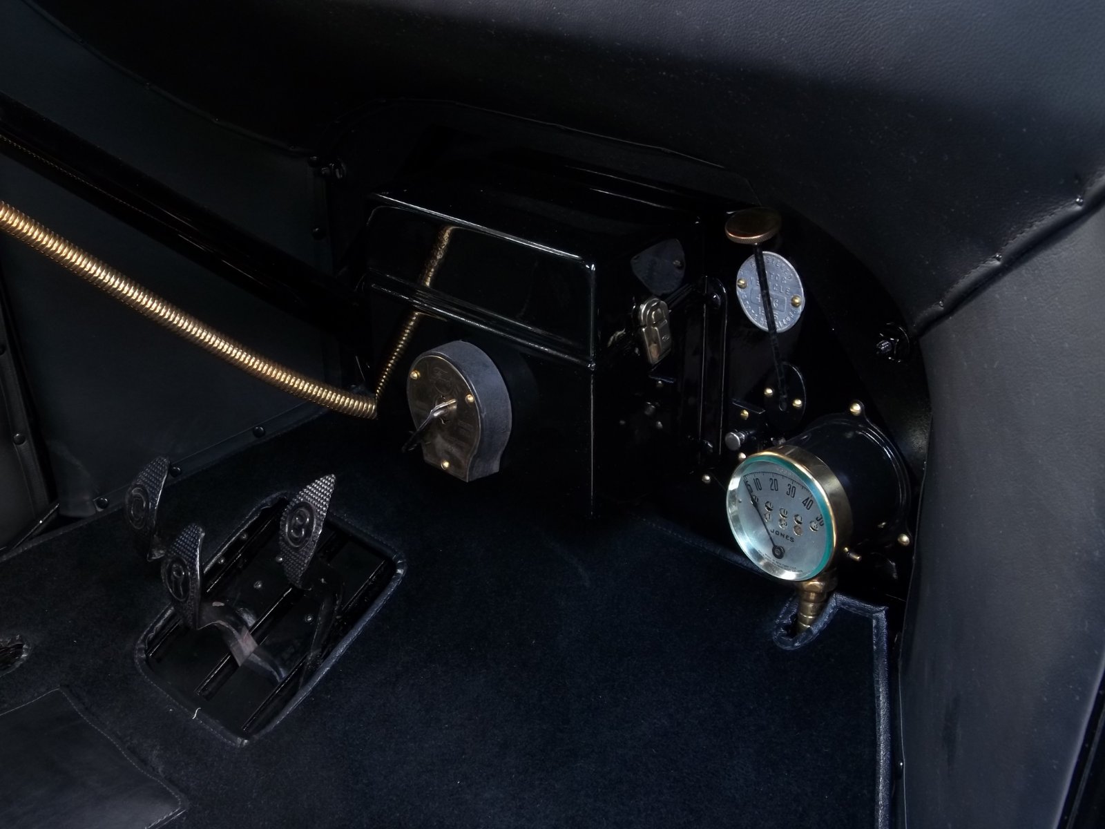

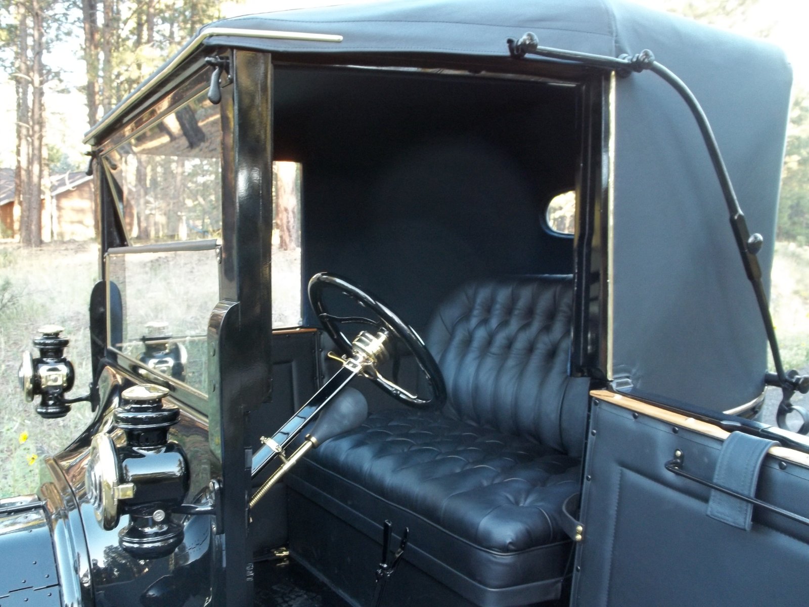

I just finished my 1915 Coupelet (engine # 6552XX) which was assembled on 12-31-14. I took it out for a drive today and it runs and drives great. The car has many components found on the typical 1914 car, including a 12 rivet rear axle, lettered pedals, riveted steering gear case and aluminum timer. The car has an all original body that was re-wooded by Ray Wells and has a diamond tufted leather interior, dark blue headliner and a leather top. The side lights are E&J #6 and the tail lamp is an E&J #7, while the headlamps are larger than the production 1915 electric headlamps. The bulb horn has a unique bracket that attaches the horn tube to the steering column. The car is all black with gray rubber Firestone tires.

Beautiful car. I see it even has a speadometer.

Russ, is that a brass moulding above the windshield and in the back below the convertible top? It is absolutely beautiful. Frank

Frank, The brass molding is the "tack strip" used on the coupelet. It covers the tacks used to hold the leather top in place. The molding is half round brass filled with lead and has 90 degree nails imbeded into the lead. This was original to the coupelet. Russ

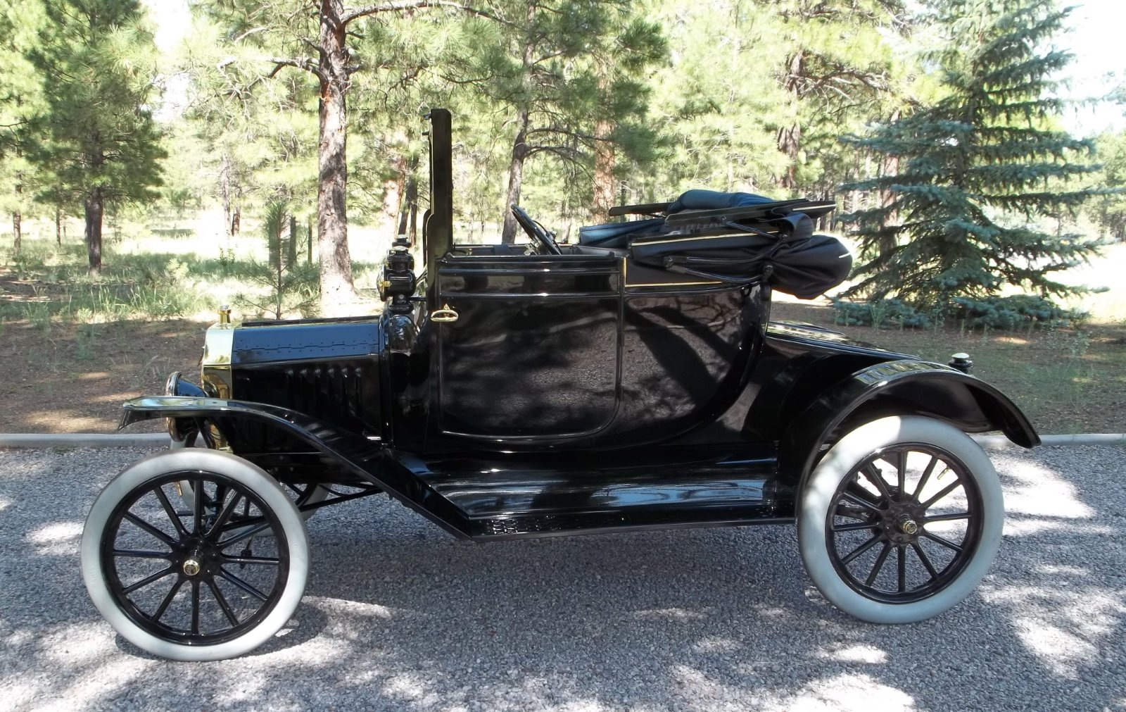

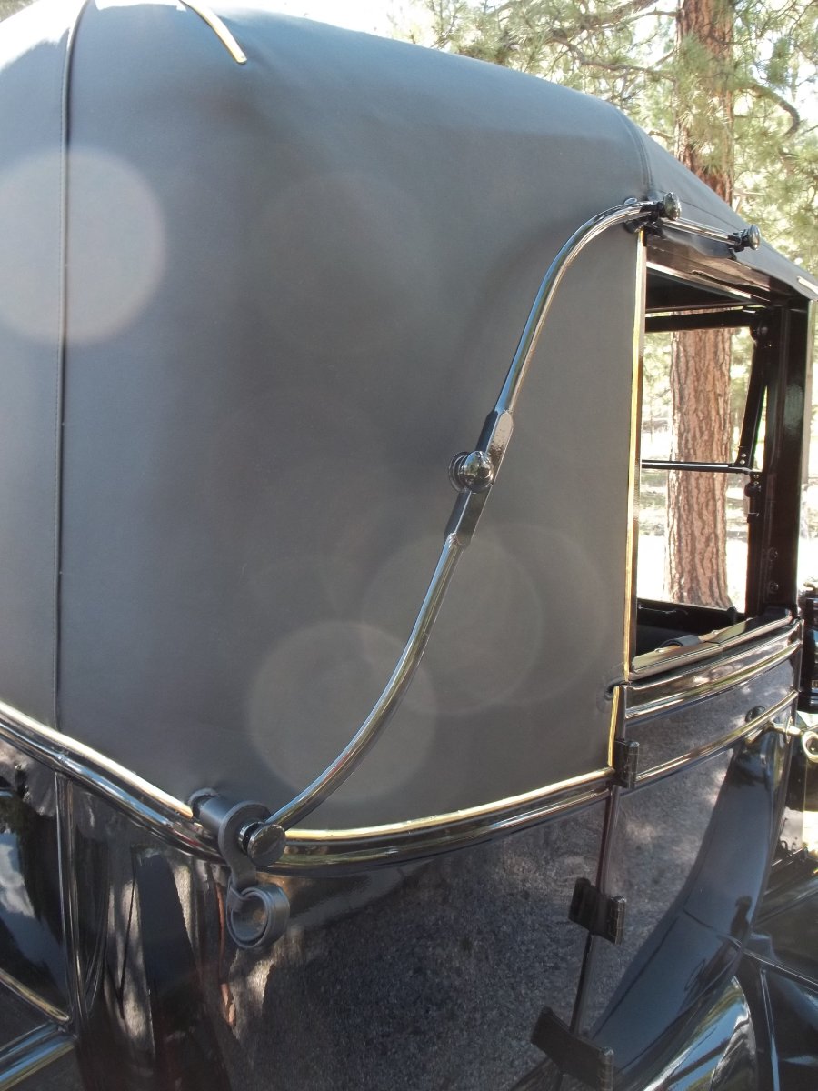

Frank, Here is a closer photo of the brass molding and one of the car with the top down. BTW, it is much easier to drive the car with the top down (easier to see around you)!!

Russ, FWIW, my late Dad's original '23 Canadian coupe has that same lead/brass trim, with embedded nails, as you describe. The former owner removed it to install the new top material, but fortunately he removed it carefully and saved it.

That trim is also called, "pin molding" and was also used around the firewall on other early makes of cars. Neat stuff and it's easier to work than it sounds. Had to make a new one once for the firewall of an Autocar.

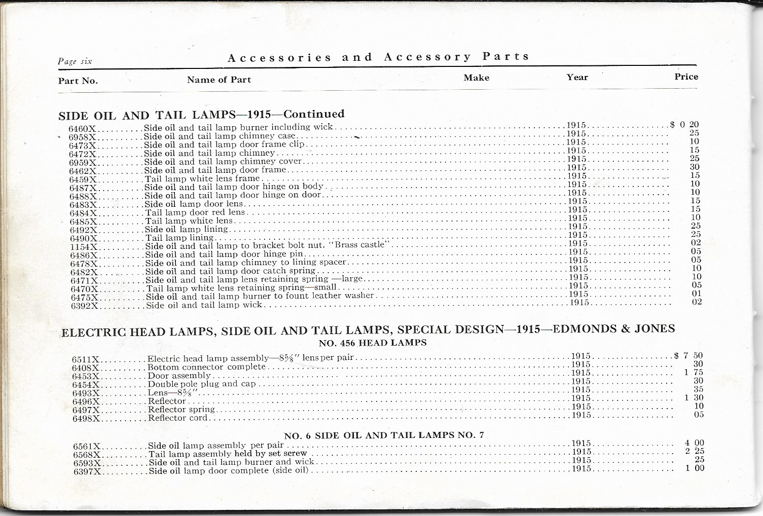

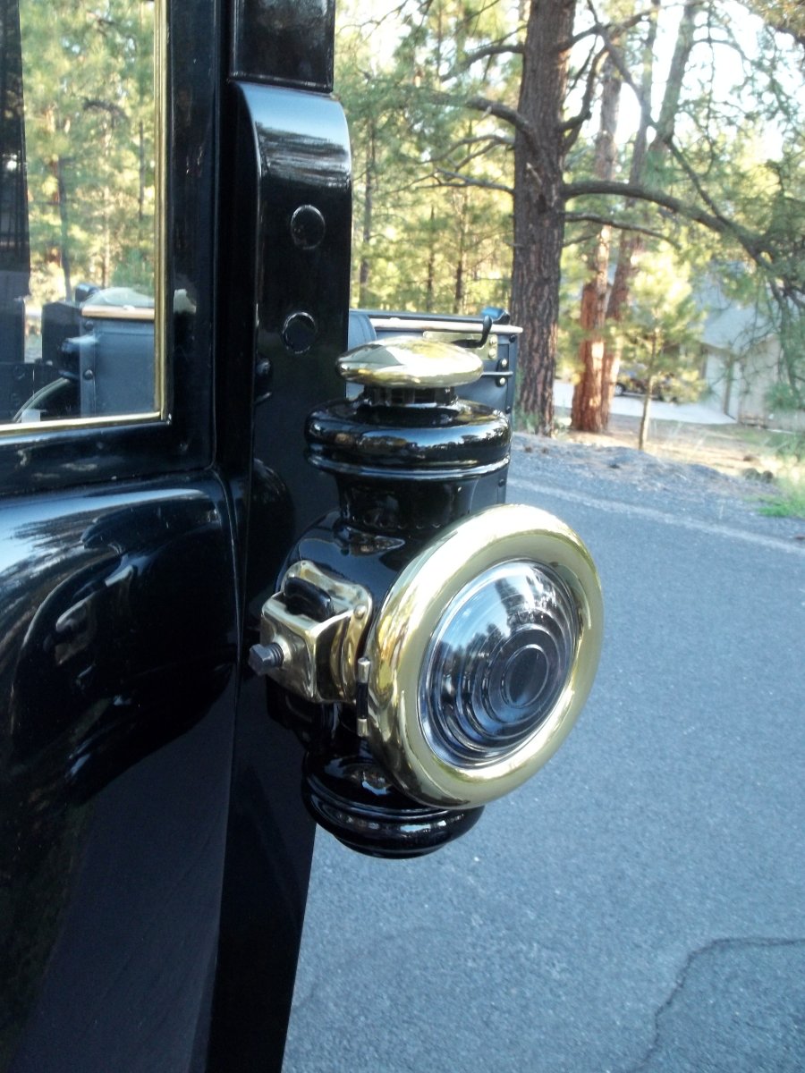

Wayne, Here you are. The E&J Model 7 tail lamp came in two styles. The tail lamp on this car has a "blade" type mount and there is also a bolt and nut type mount like the E&J Model 9 tail lamp. The most interesting and worthless feature on this car is the tailgate at the rear of the trunk. Very little can be loaded into the trunk with this tailgate. Ford decided to change to the typical trunk lid on the top of the trunk for the 1916 coupelet, which was identical to the later coupes. Here is a photo of the side lamps, which have the blade type mount.

Thank you Russ F. Quite an unusual tail-lamp I would think! Like the very much later Ford "O" tail-lamp, a small red lens with larger clear lens aimed at the license plate, mounted on a spade, and the brass bezel/door hinged at an odd angle. I wonder how many variations of side and tail lamps Ford used between the early September and October '14 closed (?) body cars and say March '15 full production. I have seen original era photos showing a couple variations with side hinges and smaller lenses with fatter bezels. But usually the detail and clarity is lacking in those photos to able to see all the differences. I doubt there is a significant piece in that lamp that is the same as what became standard a mere couple months later.
I have an odd tail-lamp I may use on my February/March '15 runabout. From a few feet away, it looks to be early typical Ford. Except for the font/bowl. The main red lens and its rim/bezel is almost like the common '15 tail-lamp (unlike your fatter rims smaller lenses). It may even be interchangeable with the common later '15s. But even it has some very minor detail differences from the other few originals I have. The clear side lens for the license plate may be interchangeable, but frankly, I never even tried it. Guess I should just for curiosity's sake. Nothing else is the same as the common lamps used by February and March of '15. No inner shell reflector. the burner looks NOTHING like any other Ford lamp I have seen. The font/bowl looks like yours does (three pin twist and a locking thumb screw), much fancier than the lamps that followed. The chimney is different. Even the brass top is different in construction and shape than the ones that followed so soon after. The mounting, although slightly different in detail of manufacture, is basically like the lamps the followed for another decade.

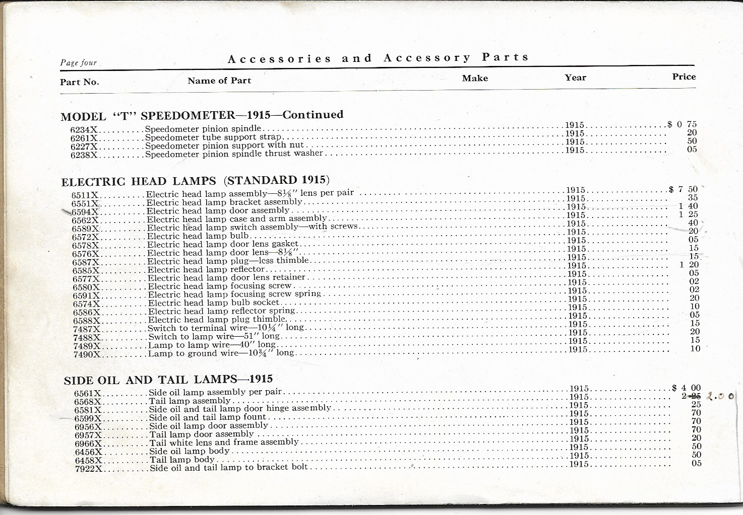

Re: 1915 Coupelet
Russ,
Beautiful restoration! Thank you for sharing the photos with us! And we look forward to an article or something similar about the car and restoration in the future. It is a real inspiration to many of us!
Wayne,
You asked, "I wonder how many variations of side and tail lamps Ford used between the early September and October '14 closed (?) body cars and say March '15 full production."
Summary:
In your research on different style lamps I would recommend referencing the Dec 1914 to Jan 1915 closed cars and excluding the photos from the Sep prototype closed cars. And yes there are many possible styles.
Additional Comments from the old Forum added here so when the old forum is gone they survive:
The closed car photos are mentioned in late Sep 1914
ref: https://www.mtfca.com/encyclo/doc14.htm
SEP 23, 1914 Acc. 509, Letter, Ford Archives
Sedan and Coupelet announced.
photos of the Centerdoors and Coupelet
SEP 23, 1914 Acc. 833, Photo 1527, Ford Archives
Photo of 1915 Coupelet. Shows fork-mounted electric headlamps.
SEP 23, 1914 Acc. 833, Photo 1621, Ford Archives
Photo of 1915 Sedan. Fork-mounted headlamps and lantern-like side lamp. Curved front and rear fenders.
SEP 23, 1914 Acc. 833, Photo 1546, Ford Archives
Photo of 1915 Sedan with gas headlamps.
SEP 23, 1914 Acc. 833, Photo 1470, Ford Archives
Photo of 1915-style Touring with odd post-mounted electric headlamps, no louvers in the hood, brass steering wheel spider and 1914-type steering gear box.
SEP 23, 1914 Acc. 833, Photo 1633, Ford Archives
Photo of 1915 Touring, now with louvered hood.
FEB 6, 1915 Acc. 509, Letter, Ford Archives
New-style Touring and Runabout bodies shipped to branches for use as models, not for use in production.
FEB 8, 1915 Factory Letter
Branches asked to submit a list of inventory for 1914 parts left over after the change to the 1915-style cars.
FEB 10, 1915 Acc. 509, Letter, Ford Archives
New type (1915 style) Runabouts and Tourings now being shipped from the Highland Park plant.
But we know from Trent Boggess examination of Accession 125 Finance – Model T Cost Books 1913-1927 at the Benson Ford Archives, that the Coupelet and Centerdoor Sedan pictures taken in Sep 1914 were of pre-production closed cars. See the posting at:
http://www.mtfca.com/discus/messages/11 ... 1268414053
That posting details that the production for the Sedan and Coupeletes started in Dec 1914 and not in Sep 1914, And it lists the number produced and the cost per unit for both body styles. It documents that USA closed car production ceased in Feb 1915 and did not resume until Oct - Nov 1915 which would be 1916 model year cars.
From that posting we have:
Month/Year Sedans Sedan Cost Coupelets Coupelet Cost
Dec. 1914 331 $577.927 801 $373.95
Jan. 1915 441 $612.215 211 $408.918
Feb. 1915 204 $601.066 160 $398.826
Totals 976 1172
Repeated from above: So in your research on different style lamps I would recommend referencing the Dec 1914 to Jan 1915 closed cars and excluding the photos from the Sep prototype closed cars - or noting that they were shown on a prototype.
Respectfully submitted,
Hap l9l5 cut off

I recently found this "Price List of ACCESSORIES AND ACCESSORY PARTS". It is undated, but probably issued in later 1915. It lists the special head lights, side lights, and tail light, that were unique to the new 1915 coupelet and sedan models. Surprisingly, these special lights were priced the same as the standard lights that were used on the touring cars and runabouts that came along later in 1915.
If you "click" on the pictures, they will be easier to read.

That book is a wonderful and necessary book if you own a brass T of any year.

Mike,
Is this the one you had?

This is another car, not the one Mike was rebuilding. Russ

MikieB -- Russ had already started building this '15 when he bought the one from me. He will build that one as a '16.

Here are a couple of photos of the rear deck lid on the coupelet. It is nearly impossible to load anything in the trunk due to the rear spring pan that takes up vertical floor space at the trunk's opening. The change made to the trunk opening on the 1916 coupelet's made loading the trunk much easier.

Thanks for that Russ. All that trunk space and no easy way to get luggage in! The 1916 design will be the one for me to look out for. I need all than accessable trunk space for my wife's luggage! Congratulations again on a spectacular restoration. You certainly have aimed for the rarest and prettiest models.

A couple good friends of mine have a 1918 ((could be '19?) Pierce Arrow coupe. Its trunk is the same way as the '15 T couplet. The trunk is fairly large (compared to the T), but has only a small door at the back of the trunk deck. Even on that Pierce, forget a suitcase! Nothing much bigger than a briefcase is going in that thing.
I suspect they did that as it was easier to make it rain-tight that way. I guess it just took awhile to see the error of that idea.
