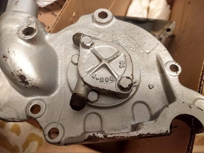

Can anyone identify this oil pump? Thanks

Really cute!!
I wonder if it is a “vane style “
Great find

I have a generator that would work good with it as it has a distributor on the back of it

Les:
the pump looks very much like the pump on my Dodge Brothers … a similar pump was used on Dodge Bro. engines from 1914 thru the 4 cyl. era … it appears to be bolted to a plate that is attached to the Ford front timing cover … the DB pump came in a 2 or 3 bolt mounting depending on year and engine series and was a vane type pump ...always an optimist...Gene French
