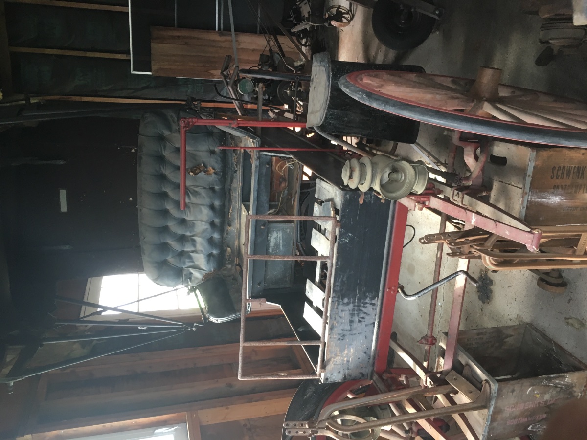

Craig Raynor, Nice Sears in that picture! Is that the car George King bought? So you know George king well? And is this the George King that used to rebuild antique engines? I have along wanted to contact him, yet somehow never did. The name "George King" was fairly common among some of my ancestors about 150 to 200 years ago. There is a fair chance he and I could be distant cousins.
Maybe you could pass this along to him?

I really like those hit and miss engines too! Great pictures! I think they would look good in my barn:)

Wow, what a cool find Craig! 11,500 out of 825,545 or so produced that year and the mounting bolts still inside. :)
You gone after it with WD-40 or some-such and a soft scrub brush yet? There's color under the rust on the back at least! Wow.
Yes, great pictures Craig! Thank you! Tiny bit of garbage but very little scrap iron in those stacks.
Randy, how many engines you find in Craig's pics? I found 6 plus the set of green flywheels (IH, F-M?) and main shaft...
