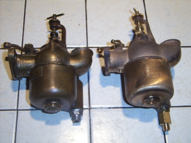

brass carb

Looks like an 08 Holley very similar to the ones used on Ns and Ss and S Roadsters for that year. The same only different
The 06s and 07s were very different. I believe Holley used the style you have only in 08 perhaps into 09. The 10 and 11 Holleys were much different. I don't know the particular application.

Re: brass carb
The photos are of two 07 Holleys. The 06s were the same without the support arm for the needle.

Re: brass carb
With the pipe thread mount, it would not be a NRS application. If it’s a 1-1/4” female NPT it would be appropriate for a late production ford model F ....along with many other autos,boats,stationary engines etc. it’s missing the large Nut and probably the spark arrestor screen over the inlet. it certainly is a Holley, does the name plate state patent pending or patented? Made in Pennsylvania or Detroit?

Re: brass carb
Looks very similar to my 1906 ford model F carb.

Re: brass carb
tim! it is detroit,pat ap for.1" throat.which will run a 30 hp.how big is a mod f ford if its a 1 1/4 pipe which would be a 1 3/8s throat?? that brass elbow screws off. charley

Re: brass carb
I had an 8 hp high wheeler and it had a factory 1” NPT schebler D. . The F is 12 Hp and takes a 1 1/4” throat carb. These are all pretty low rpm engines, but that is how the factory sized them. In my opinion it would be for about a 8-10hp auto engine, but probably not a ford application. A couple of years too late for the ford C model. I’ve seen lots of adaptor flanges that would bolt up to many applications.
