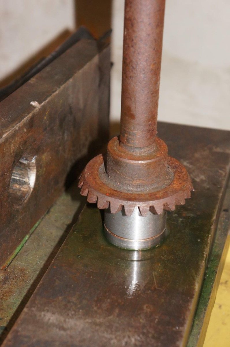

Post by John E. Guitar » Sat Jan 11, 2020 9:12 pm
Here's my setup to remove the half moons. You can't see the top of the shaft very clearly but it has a nut on it to protect the thread.
The highest I've had to go is around 15 tonnes.

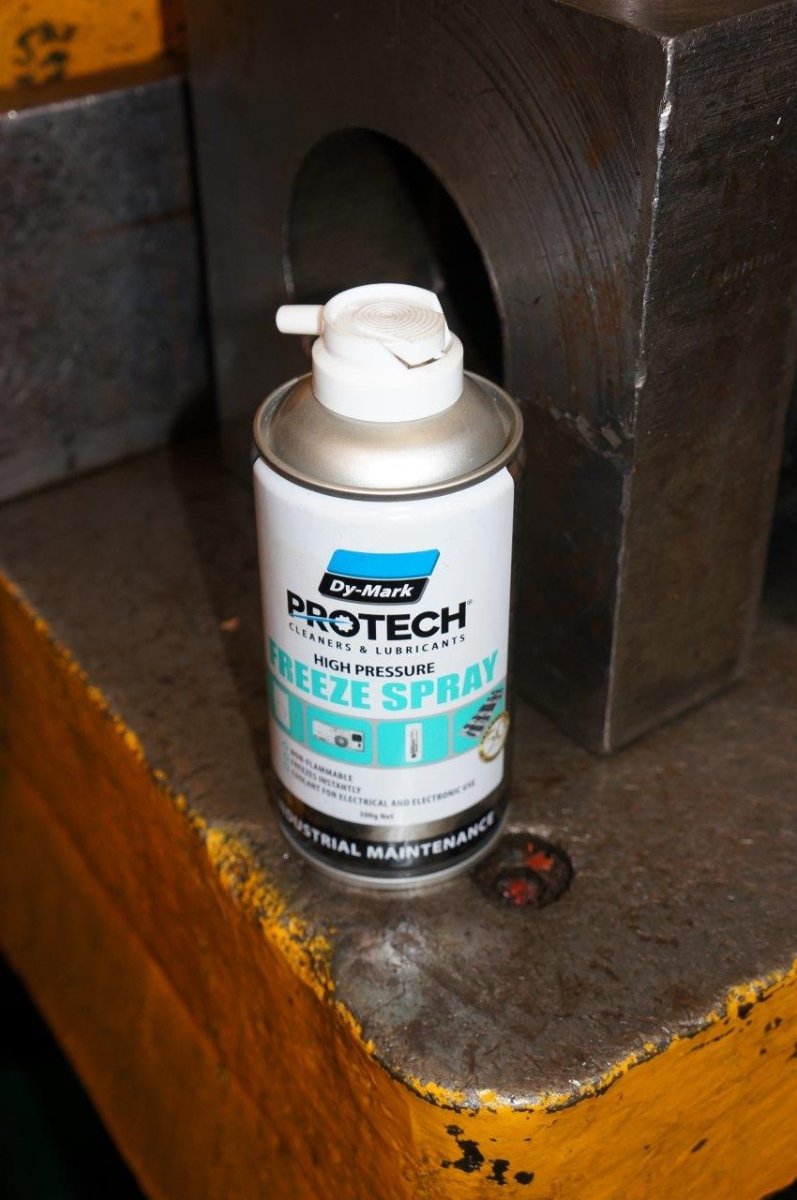

Post by John E. Guitar » Sat Jan 11, 2020 9:17 pm
Here's the setup to install the gear on the shaft. I use a bearing heater to heat the gear up to 115°C and a freeze spray to shrink the shaft. The photo of the frosted shaft only shows the top area being cooled. I apply the freeze spray for the full length of the gear location.
