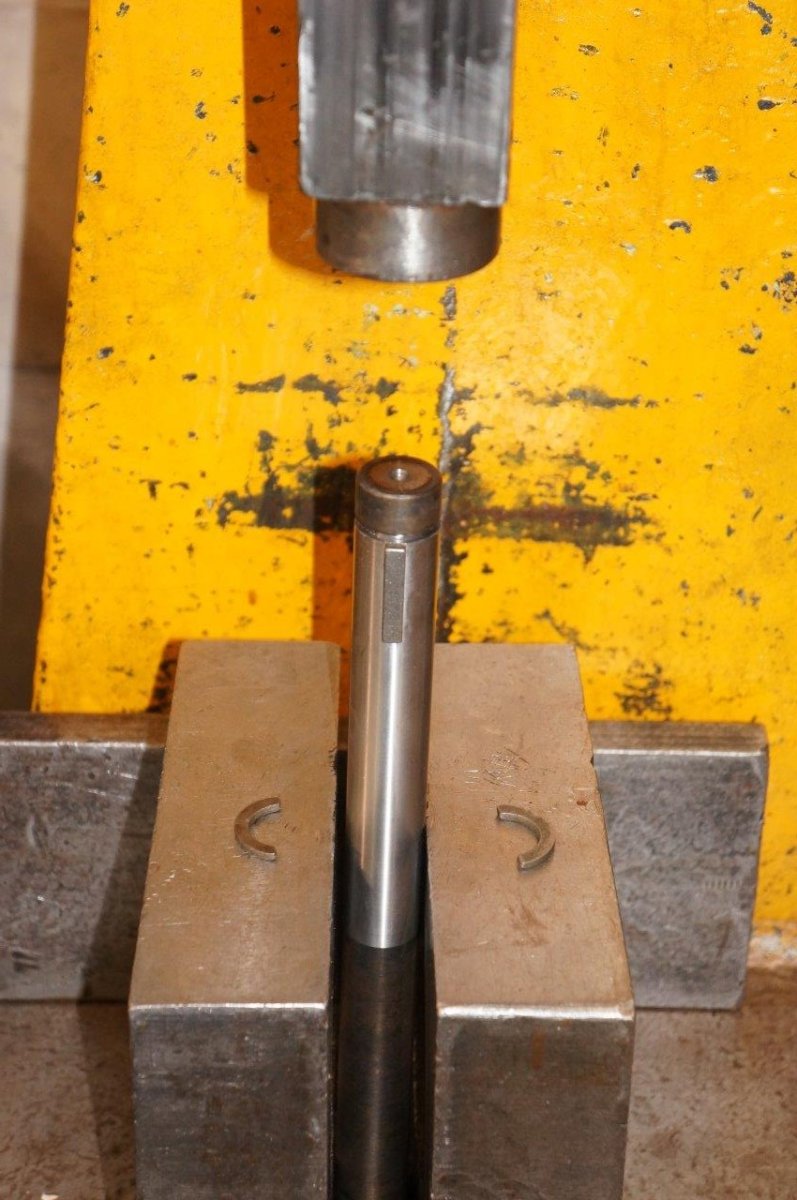

Are you asking how to move the gear down the shaft to remove the two half moon retainers?
I drop the bed of the press right down and have the gear sitting on a cupped tool that supports the gear in the area between the teeth and the axle shaft and press down on the threaded end of the axle shaft (with a nut fitted to protect the thread). It can be quite tight, I’ve had some gears that needed 15 tonne before they budge. The shaft may flex a bit. You need to make sure the shaft is as close to vertical as you can get. I always wear a face shield for this, it’s a bit outside my comfort zone.
I will be doing this tomorrow and can take a few photos and post them.

- Posts: 518
- Last Name: Guitar
- Location: Ulladulla
- Board Member Since: 2012
Re: Removing and replacing rear axle gears.
Here's my setup to remove the half moons. You can't see the top of the shaft very clearly but it has a nut on it to protect the thread.
The highest I've had to go is around 15 tonnes.
