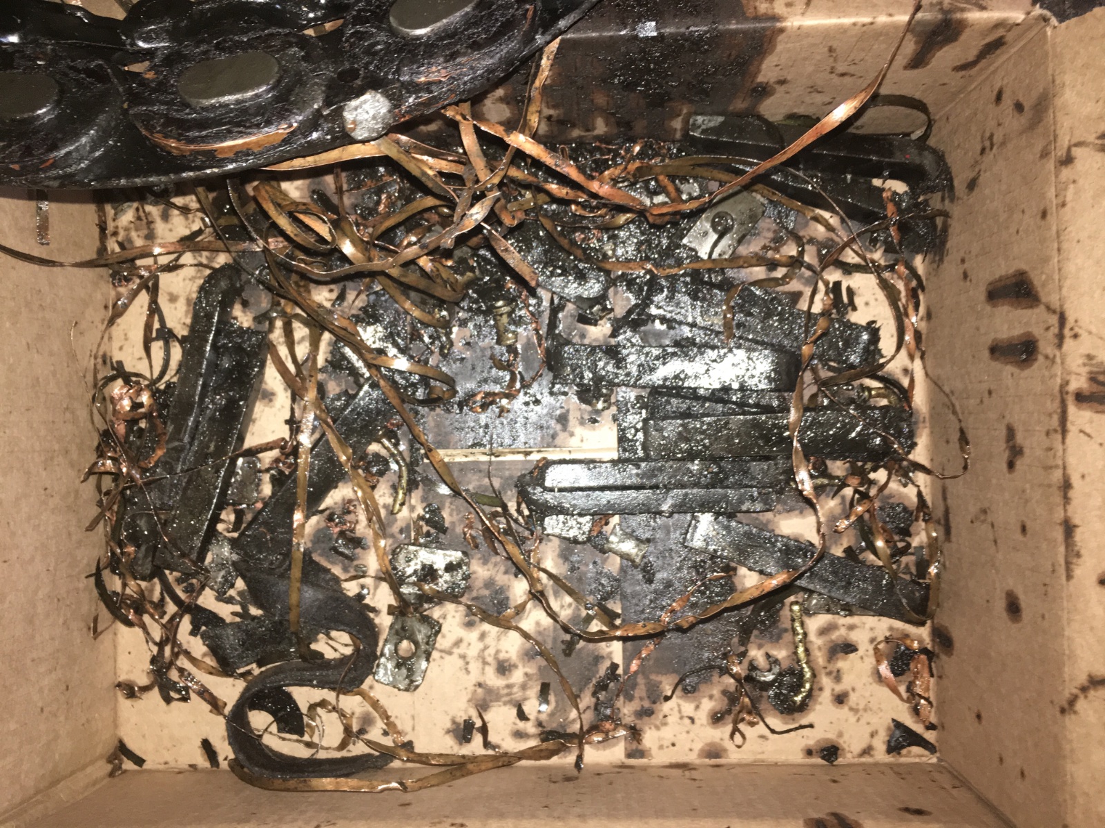

I remember many years ago working on the Coupe with the transmission door off and the key in the ignition. Yes the inevitable happened and the damn key fell into the bowl of the transmission. I had to pull the motor, expensive lesson.
I posted this as a caution note to novices and no disrespect to the novice owner. Another expensive lesson.
This is what I pulled out of the bottom of the pan
Theis the remains of the coil ring
Remains of the magnets
View when I removed the hogs head

Here is another one to look at. It was being towed when it came apart. It destroyed the firewall, floor boards, coil box, and broke the starter snout off, as well as breaking the exhaust manifold off. . It was in a TT truck and the entire inside of the cab was covered in oil. Even the ceiling. This was a customers truck from sometime about 1990. I have posted these before and yes the owner knew I was posting them.

I did not tell the "rest of the story". The TT was a nice original body, wood cab truck. The new owner could not get it running because it was in the winter time and very cold. He lived less than five miles away so they decided to tow it home. (the previous owner was out of state at the time, so he had no input into the event) The new owner was in the truck when it exploded. The only thing that saved him was he had on full winter clothing. Carhart coveralls, ski mask, heavy gloves and boots. he also wore glasses. He said when the transmission exploded, it felt like his knees went behind his ears. He said it almost turned him upside down. Him and every square inch of the inside of the cab was covered in hot oil. The pictures show the engine as I removed it, It looked worse before I removed the engine because all the floorboards and wood firewall were splintered to shreds, The entire transmission assembly was in the seat beside where the owner was sitting. When the flywheel broke it allowed the entire transmission assembly to come out as one piece. One of the triple gears went completely thru the driver side door. How it missed the guys legs is a miracle. The moral of this story is "do not tow a model T" They made it about 2 miles. I was able to salvage the motor, and the transmission drums were all still useable. I replaced the hogs head, oil pan, starter, flywheel and magneto, exhaust manifold, and a few other things. They steam cleaned the inside of the cab, replaced the firewall, coil box, floor boards, and fixed the hole in the door. The truck is still running today...

No, you cannot in any way pull a T backward on a dolly under the rear wheels. The T can only go in very very slow reverse, as the steering geometry can't be controlled.
To move a dead T, push it on a flatbed tow truck and haul away, or push up on a trailer and tow the trailer with T on it.
Towing a dead T on all fours makes the rear end turn the drive line, since there is no neutral in the trans. Any tow 'in neutral' at a speed will overheat oil and lockup trans discs. If a dead T is towed in high gear, the engine turns, creating some oil splash, but even with spark plugs out, to relieve compression strain, its just too much load, heat, and wear at any speed other than a crawl. If you like your T, don't tow it on all fours.

Dan is correct. The trans clutch disc were warped and very blue, almost welded together. The three thrust washers were welded together. When towing any distance, disc's are turning inside the clutch till they finally get so hot they lock up and then they start turning the engine. I am guessing, but I think when the engine started turning is when something came loose. The guy said they did not get over 30 miles an hour, but at that speed how many rpms would a TT rear end be turning the engine. ?? At the time I did not do a CSI investigation into the mishap, but I always felt like the clutch disc's locked up and the rpms then destroyed the engine. As to the owner knowing if I used the pictures. He was there when I took the pictures, I told him I wanted the pictures to show others "what not to do" and he had no problems with it. This had nothing to do with a dropped washer. I posted these as another example of "what could happen" Seems like every time something gets posted, someone jumps in with something negative to say. :(

The clutch pack dries out very quickly without the flywheel churning the oil around.
Then everything goes wrong.

I have no explanation on what happened here. I was driving along and I heard click,click and then BANG !! Towed it home opened the transmission cover and wow! It even broke the pinion gear.

Saw transmission look like that only once. Owner built speedster on the sands in Ormond Beach antique car timed runs. Great fun day. Anyway he had just gotten underway, rear tires throwing sand, then oops :o he stalled fast.
Later he looked in the cover plate and told me the low drum was in pieces. Viewed it back at his garage with hogsheads off and drum was in multiple pieces. Later he told me pieces and threads of lining were everywhere, had to dissemble the entire motor to clean it.

George. I figured that the engine explosion was probably caused by the excessive RPMs The thing that I have always wondered about is, what did it sound like in that truck cab before the engine exploded. . Most of us have trained ourselves to "listen, and hear" what is going on with the engine. It must have sounded terrible just from the rpms of the engine.
