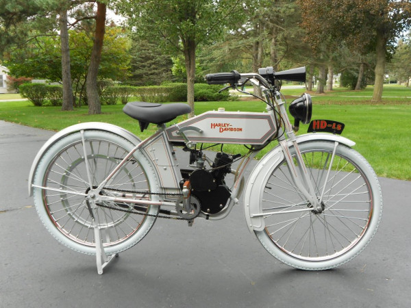

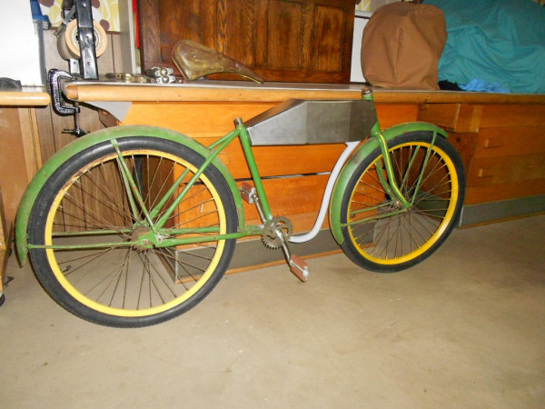

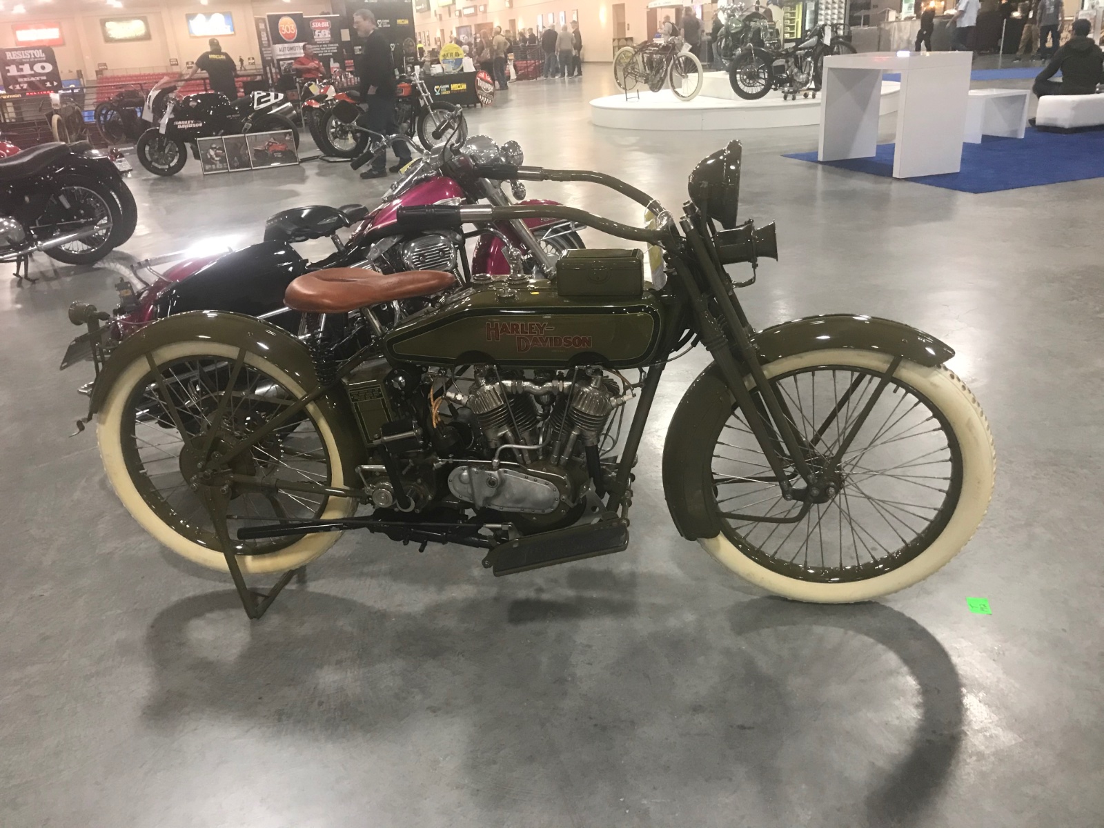

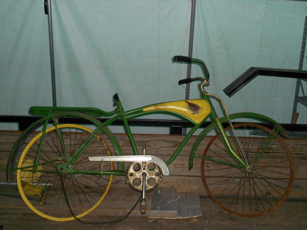

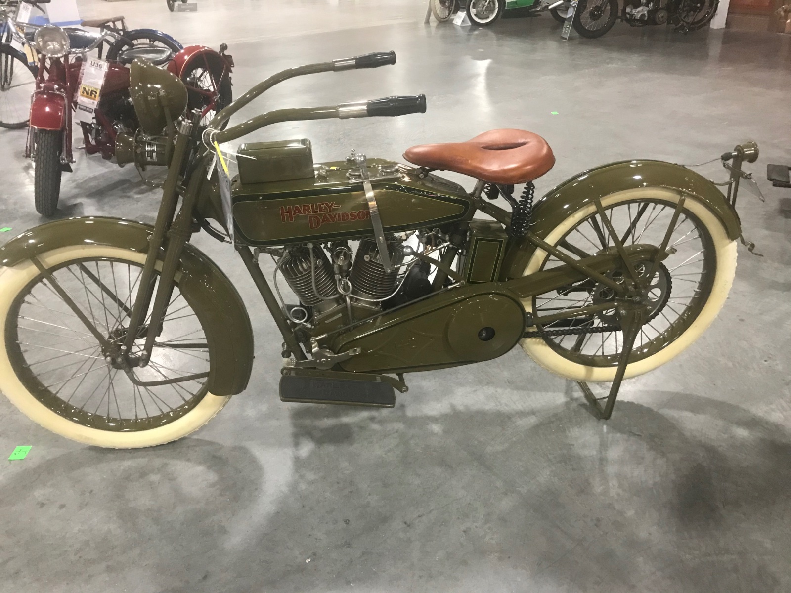

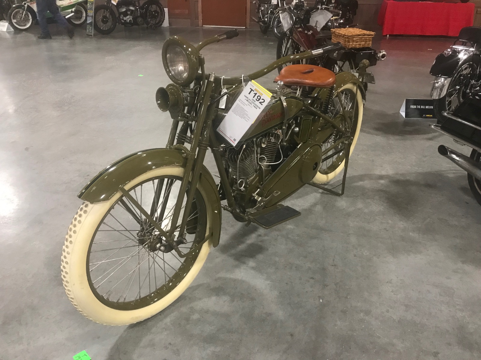

Love the bike!!!

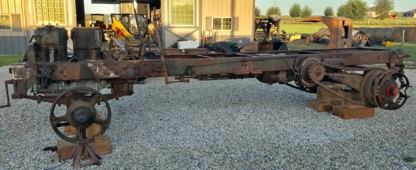

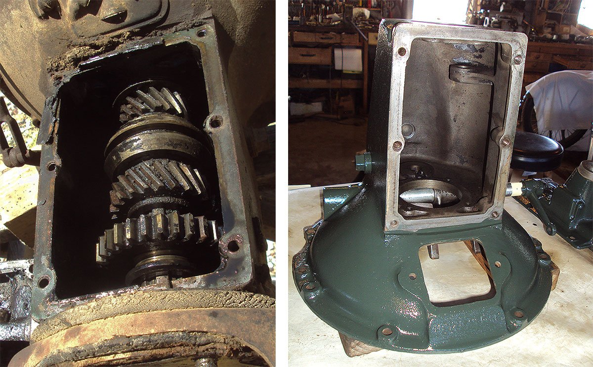

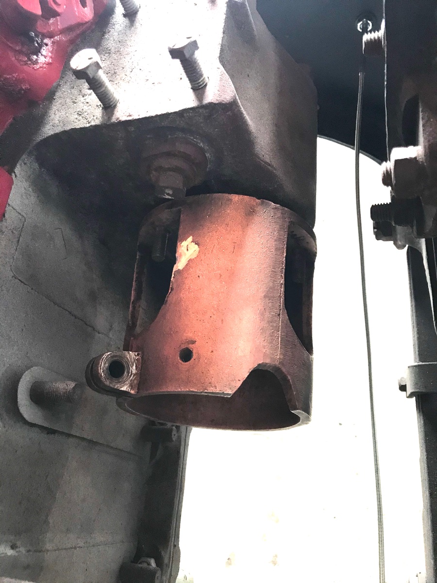

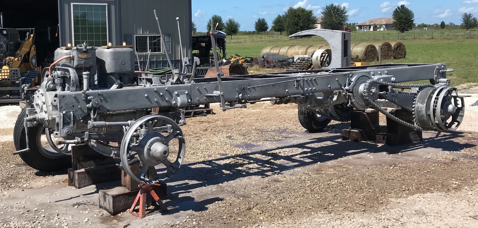

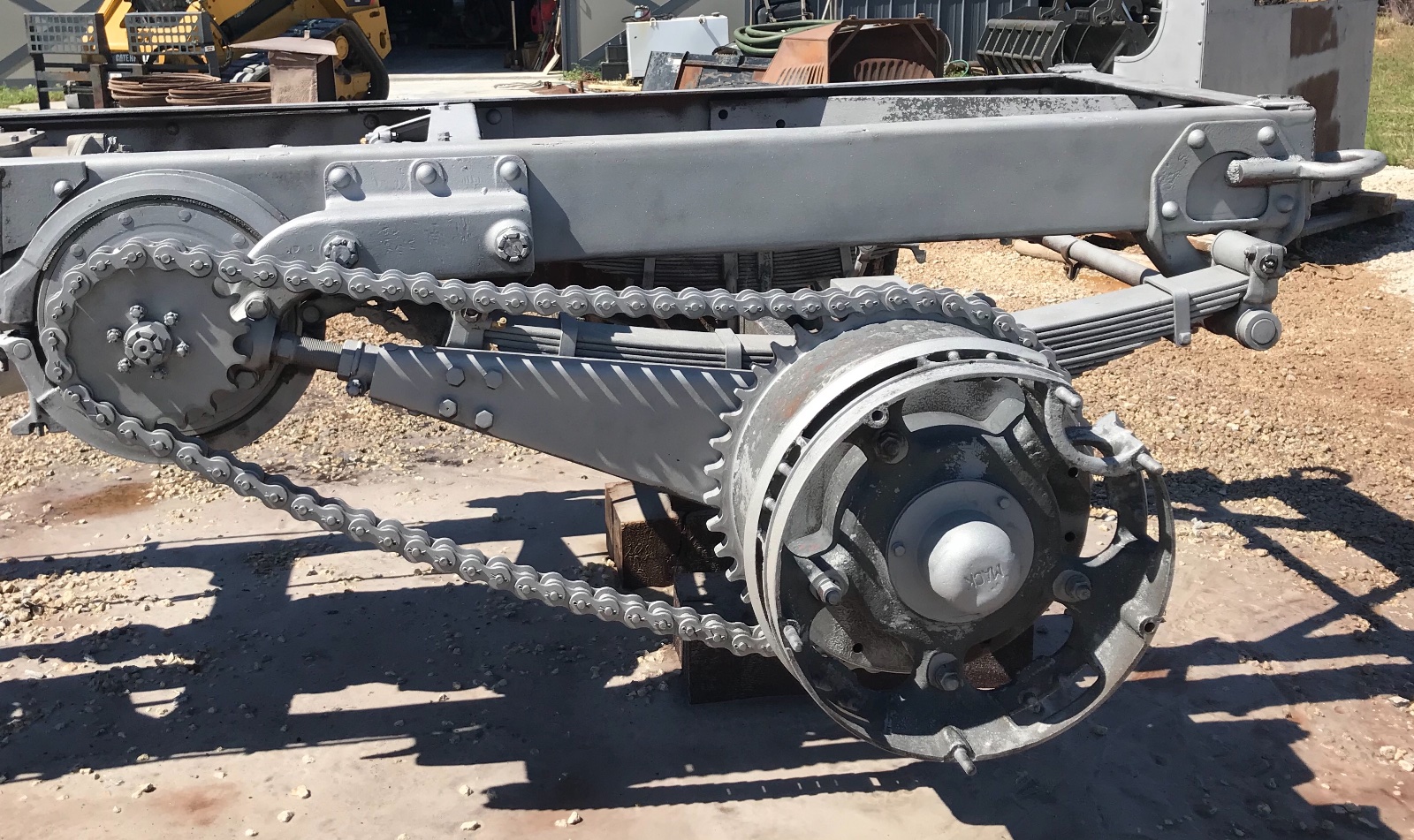

Doing some cleanup this week.
Hopefully moving into the cleaner assembly stage.
Before : After: Now that’s a piece of art :

Art? It sure is! That drive is gorgeous Paul and those sprockets look great! What color? No wait, show us when painted.

What a $#@! BEAST !!!

Those photos are fantastic!

Looks like you have been very busy! Great job. I cant wait for more. I agree with the art comment.

Hmmm...wonder what color it could be ?
That is a behemoth, very cool !!

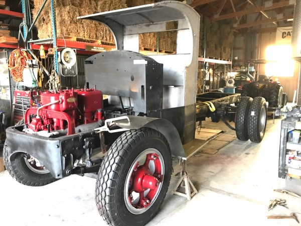

It will be modeled after our other Wrecker with similar accents, but I’ll have to change the color from ‘Coal Black’
- to gloss ‘Black’ in accordance with the model year !
Engine cylinders, squirrel cage, wheel hubs, sprockets (and possibly chains ?), as well as winches/cable pulleys (safety) will be accented as our TT.
All aluminum (block, pan, and transmission) and brass/copper will remain exposed (possibly clear coated to prevent oxidation).
A lot of work yet before that happens.

Looking so nice! Can such a behemoth be so nice? Yeah, but they sure ain't fast!
I do look forward to seeing this done.

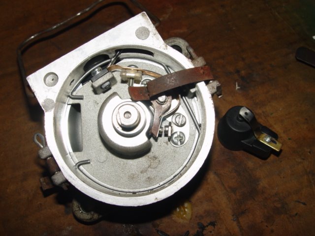

Reset points...

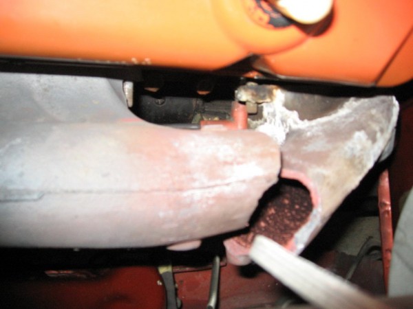

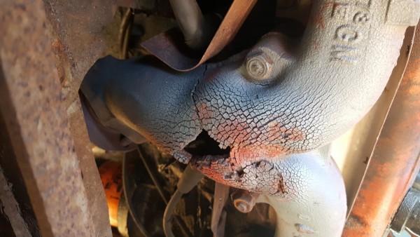

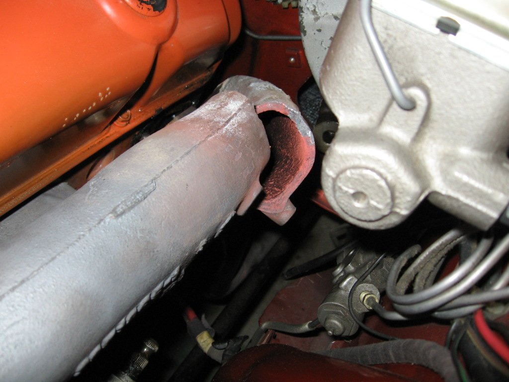

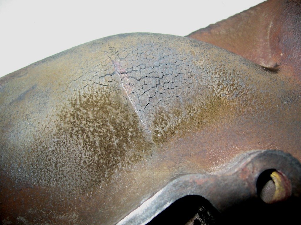

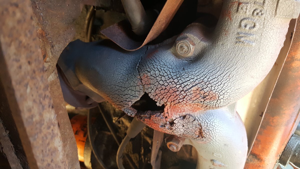

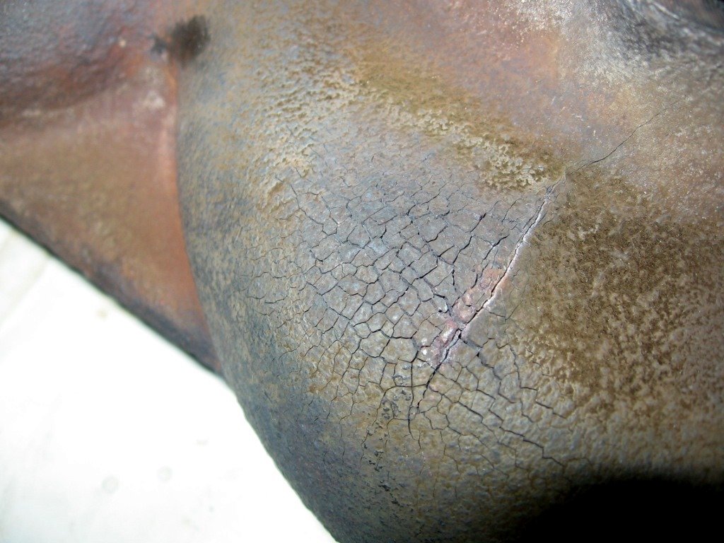

Now that's pretty interesting to me because just last month I had to replace the manifolds on the 350 in my '71 GMC. People on the Chevy truck forum and elsewhere told me they had never seen this before and that I must have something wrong ranging from timing to blocked exhaust, but there is absolutely nothing wrong with how this truck has run and performed for the ten years I have owned it and everything checked out afterward.cudaman wrote: ↑Sat Aug 31, 2019 12:44 pmA couple of months ago, I finally got fed up with the exhaust manifold leaks on my 1971 Plymouth GTX. I thought that the gaskets were blown, but once I got the manifolds off it turned out that the driver side manifold was cracked into two pieces and the passenger side manifold had a circular spot with cracks radiating from it.
I purchased two good used manifolds and swapped them in, the exhaust is nice and quiet now.![]()
I started out replacing a muffler and knew that I had some leaks up front, what I thought were bad donut gaskets. While the pipe was disconnected I decided to move to the front and do the gaskets and that's when the pipe wiggled in my hand and I knew something bigger was wrong. The left side manifold had a heat shield over it, so I never could see this happening. The right side was starting to do the same but it wasn't obvious yet. Seems to be right there where all the heat concentrates where it dumps out the middle. Maybe it's a junk 1970's iron thing.

Looks very similar to what happened on my GTX, I wonder if it's just age and heat cycles catching up with the cast iron?

It almost makes me think it's something to do with the era because I've worked on a lot of older stuff that has seen a lot more abuse and miles than my truck and I've never seen a cast iron manifold do that before. My truck only has 105,000 miles on it.

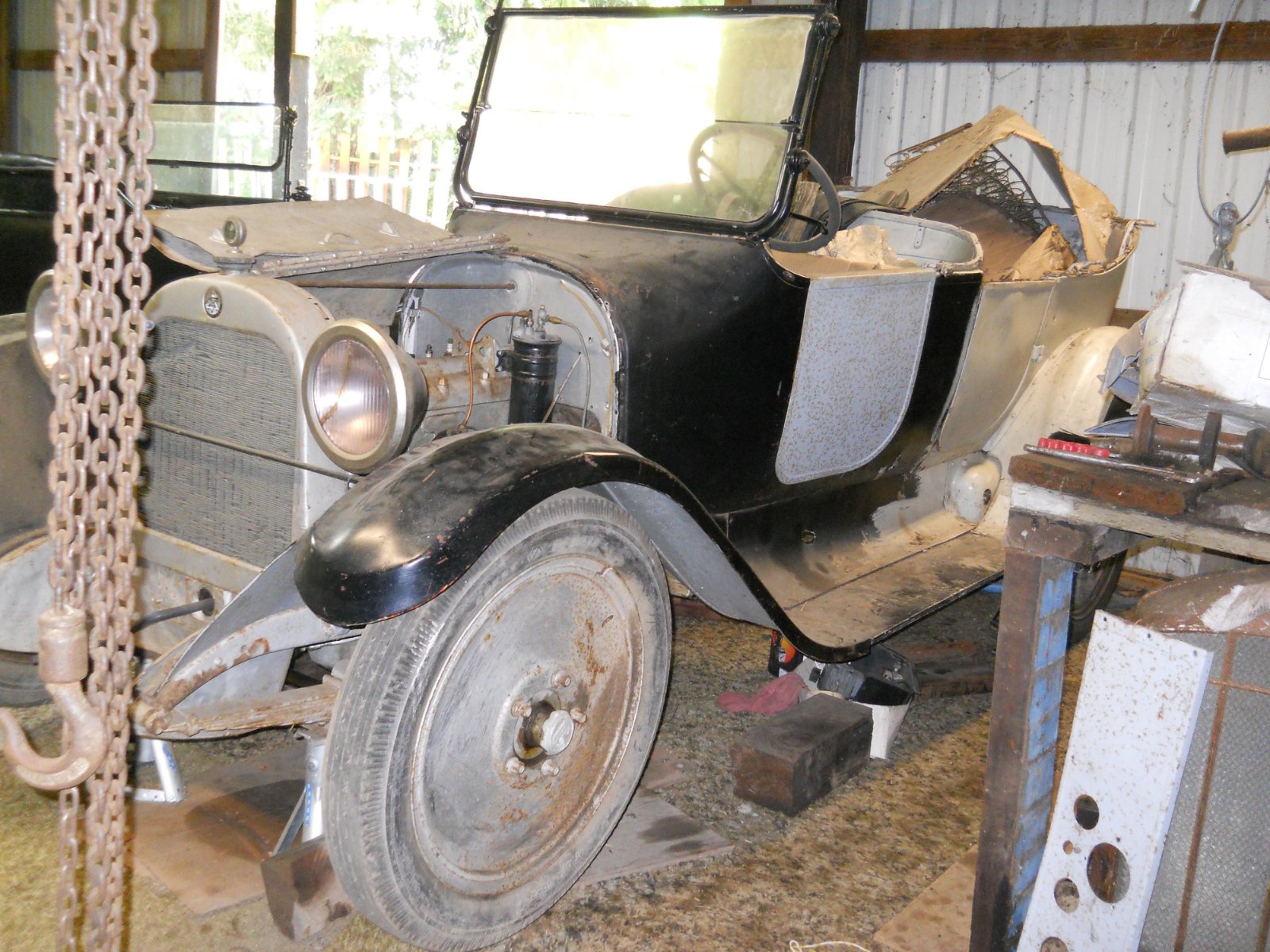

Hi Rich, thanks for starting this great post. We all love the model T s but it seems anything from that era draws our attention. I often wonder if we're reincarnated from that time.
I've been sorting through things in my containers and have found some early motorcycle parts, one is a carburetor with a 1914 Harley tag, and a rear hub and sprocket, no tag but in great condition. I'll post some pictures so they might be identified. I don't need them, but maybe someone else on this forum might have use for there project.
You do amazing work, it's great to share our experience. There is a small High school in the town of Wheatland in California. They have a great program in the metal shop class, and have restored several antique tractors. I'm hoping to get in touch with the teacher and donate a model T chassis for them to restore. There are still plenty of our teens that love working on anything mechanical.

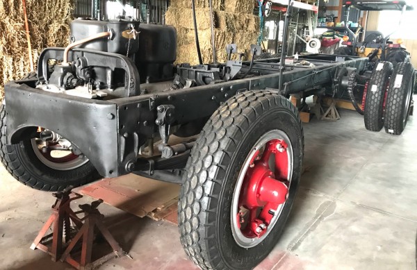

Finally got the new shoes on. First time on its own rubber in over 12 years. Had to get them on to be able to move it easier during the assembly.

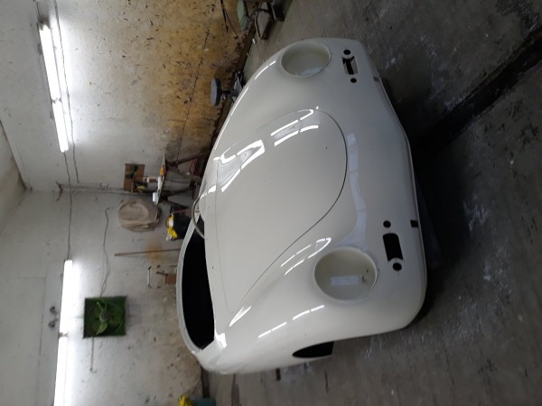

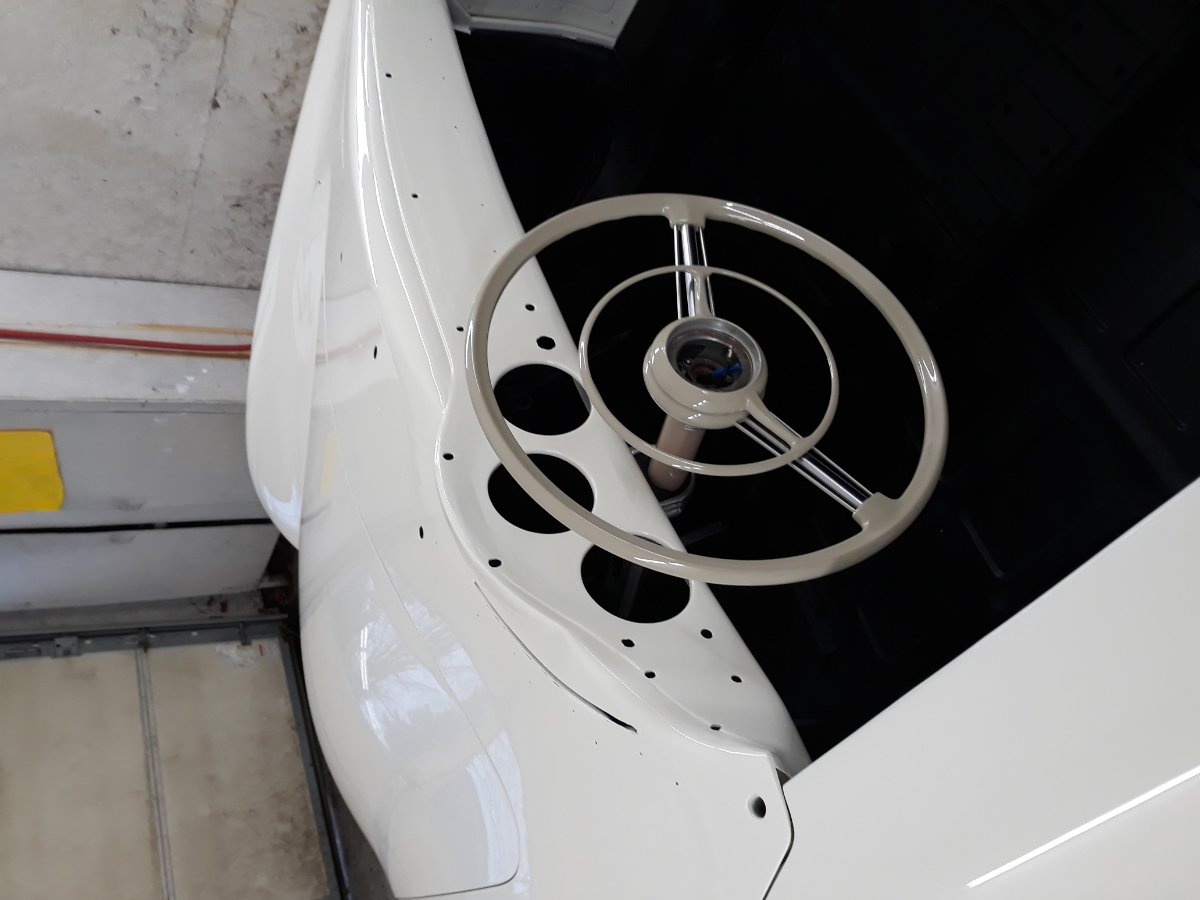

I've been helping a friend restore his 1958 Porsche 356 Speedster. After having the metal work (rust repair) done and bodywork, I started in on it a couple months ago, working in my spare time and weekends, to get it painted, so he can finally start assembly. Here's 2photos taken this evening, ready for it to go home. When he bought it, it was painted (horribly) black. Now back to the correct orginal "Elfenbein" white.
* well, I can't seem to rotate the photos right side up. Darn....*

Wow, looking good. I have a friend who had a similar Porsche, but his had the very rare bench seat in it. He's had it some two to three decades and finally was almost finished with the restoration. BTW, that bench seat is so rare, the factory museum offered him $20K just for the seat. In the Camp Fire he lost his shop, including the nearly finished car. End of story there, except one should have insurance (he didn't).

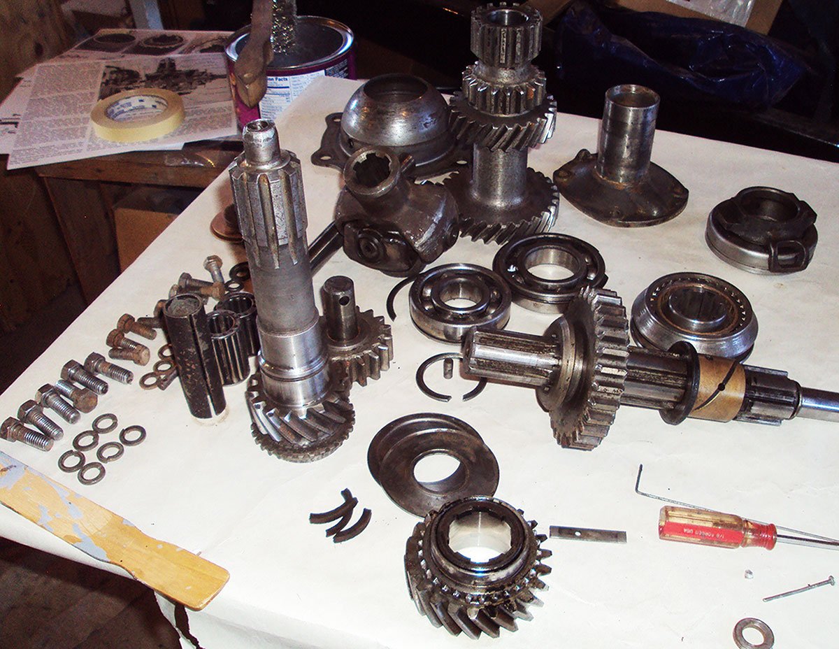

Mack, you didn't know all older Dodge pickups toss their transmissions at some point?
They do.

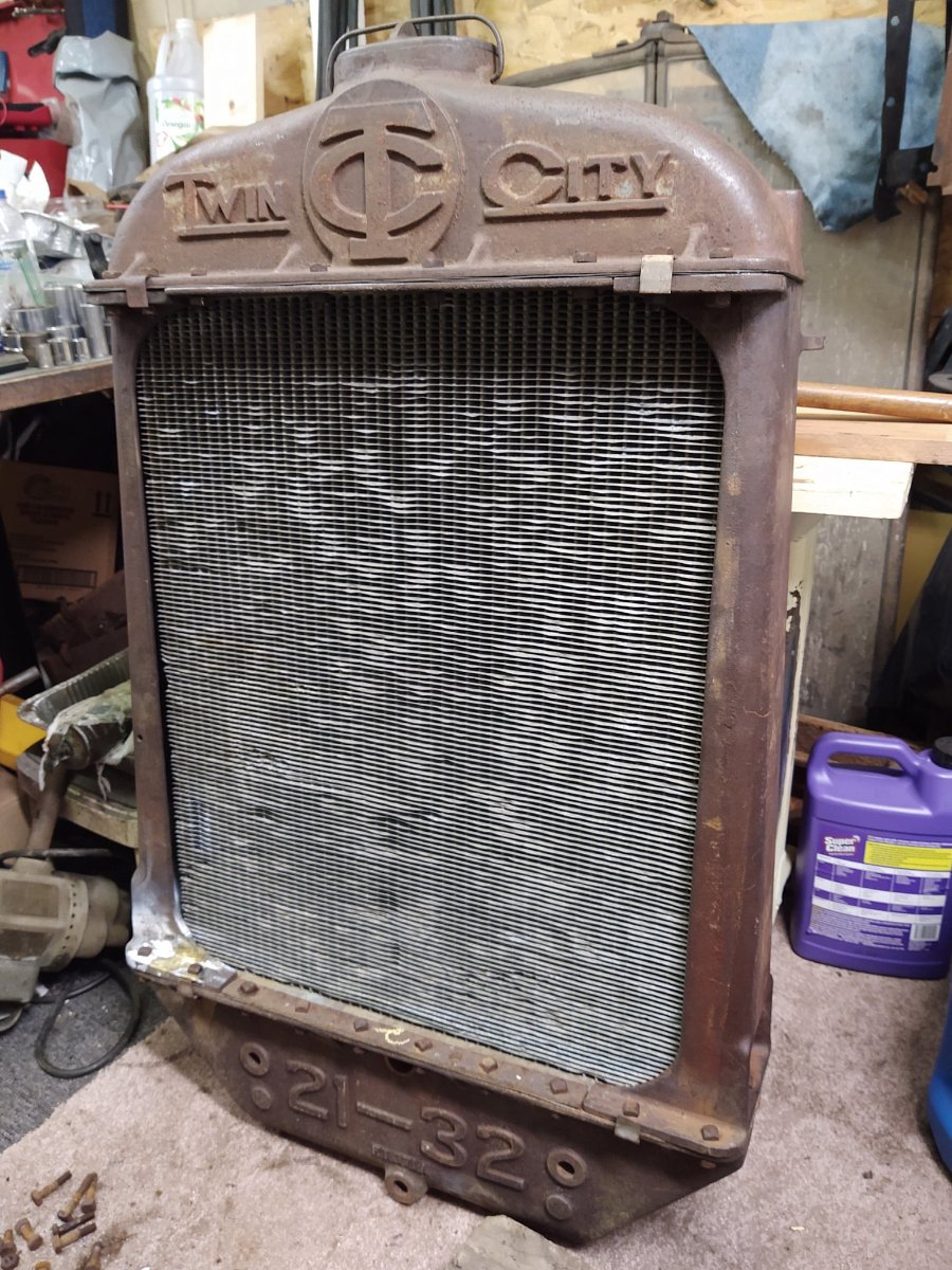

I still work away at study and moving forward with my non-vehicle project/projects. Deep in the rabbit hole, I've even noted hose clamp fixes and fails on 90 year old foolishness. Much to do!
Great thread Rich! Excuse this late night OT.
One more little 130 pound piece of a puzzle.

Re: What have you done on an old non-Model T vehicle.
Had to do a bit of mock up this week.
Since everything is based on the cab assembly, I had to temporarily remount the cab and cowl
on the chassis in order to do a fit up of the new fenders and running board fabrications.
Still have a bit of work to do on the fenders.
But it’s lookin good over all.
Thats looking great. You have been busy.
That old AC Bulldog is coming along nicely ! love it !

The Mack is looking really nice Paul! How many cubes is the engine?

471, but it’s only a 4 cylinder. (5x6)

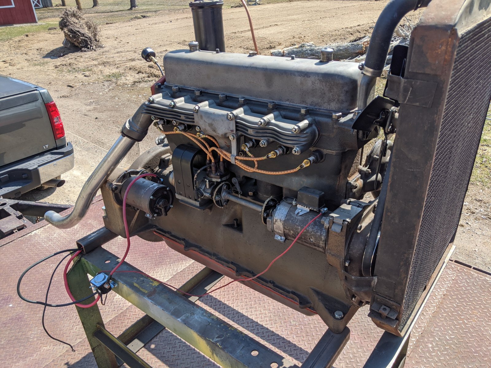

Thank you!
You have me as the 4 cylinder engine behind my radiator above is at 413 cubes at 4-11/16x6 right now.
4-3/4 is my limit at 425 cubes.
Big Mack engine! No wonder you ponder cranking. Me too. I don't happen to have enough belt pulley parts and a belt to spin...
I'd bet you'll rev your Mack engine a bit higher than my 1075 max...
I'm pushing just about 50 horse perhaps. Your Mack, a bit better!
For the Mopar fans? Burger?
I have two engines in 1928 (OT) 17-28 tractors 26038 and 26068 that are 340 cubic inch, Twin Cam, 16 valve @ 1000 rpm.
Company literature say the engines will make 40 hp. Grunt! A Twin Cam monster will come here yet at 641 cu. in.
5x6 is a big engine. Thanks Paul!
Keep posting pics if you would. Love your beautiful truck!

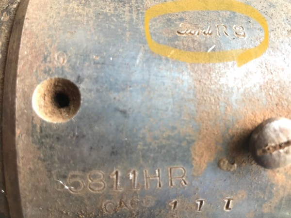

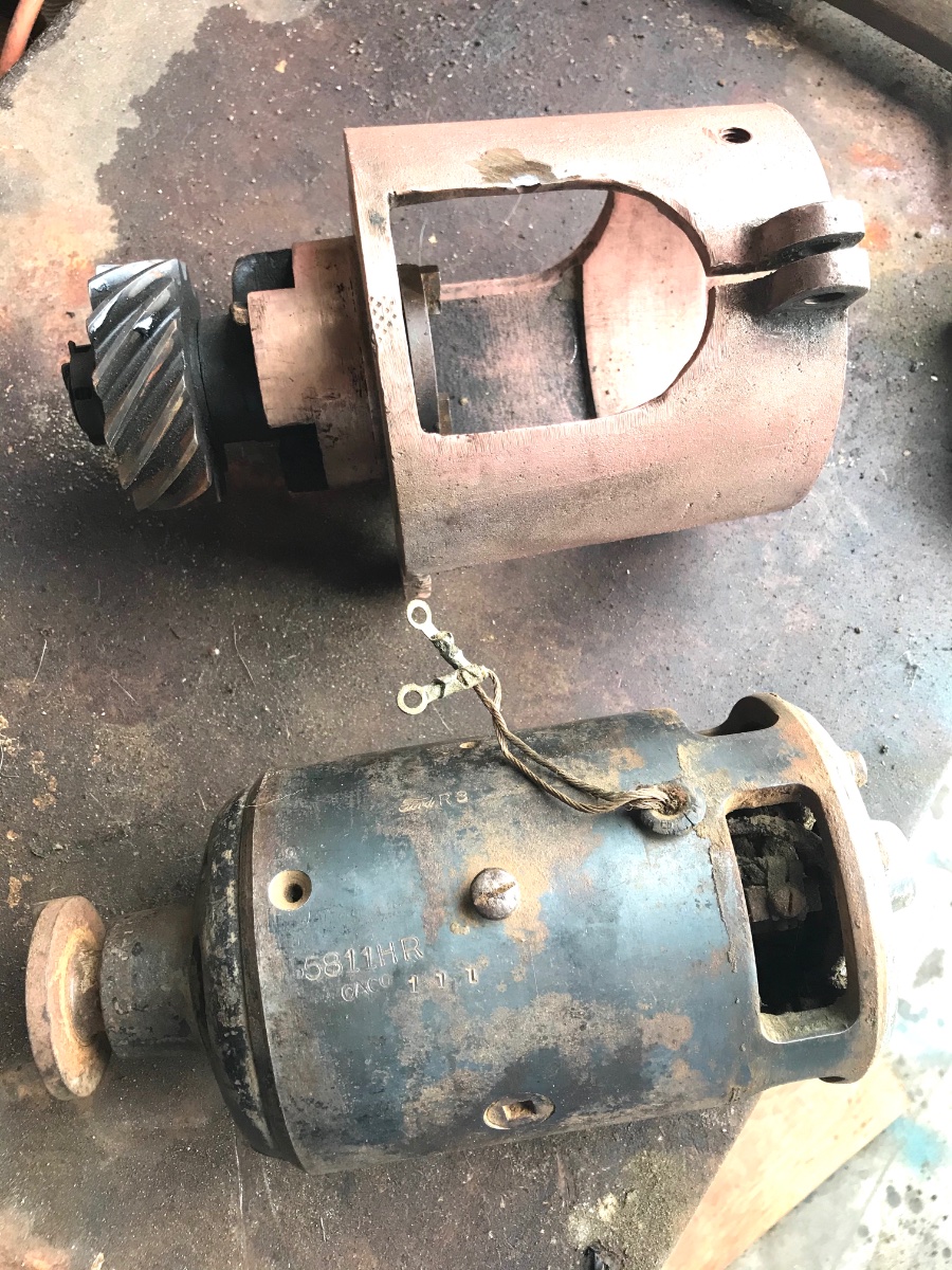

The FORD connection ———
There had to be a tie-in for my Mack somewhere to this forum ..........
As you know you run into just about everything during a full restoration, and I’ve been chasing parts, suppliers, component restorers.
The Mack Museum is a great source as they have records on every truck Mack has ever built, including build sheets, and usually prints of every component installed at the factory - (but no parts).
However, as you know, everything on these 100 year old vehicles isn’t stock.
While trying to work in advance of need, I’ve been chasing info on the generator. Mack has twice said they have no record of any electronics on my truck, but it surely has been designed in to the engine.
While trying to find information on the generator itself, I find this (!) -
I haven’t been able to find anything online searching for info on it. I am assuming it’s 6v.
So now the question to you - who knows anything about a Ford ‘R3’ generator ?
Any help would be appreciated.

The R3 looks to be late Model A or B with the drive end modified to use with the drive it has now. One wire from field goes to ground, the other goes to cutout for out put. The Model A/B had two approx 1/4 bolts to hold the bracket on and two 10-32 to hold the cutout on like the T on the other side.

Mark - Thanks for that.Mark Gregush wrote: ↑Thu Feb 06, 2020 12:33 pmThe R3 looks to be late Model A or B with the drive end modified to use with the drive it has now. One wire from field goes to ground, the other goes to cutout for out put. The Model A/B had two approx 1/4 bolts to hold the bracket on and two 10-32 to hold the cutout on like the T on the other side.
I’m chasing the possibility that it might be a 38/39 Ford Truck generator, minus the pulley and front bracket.

Could be earlier, but car too;
https://www.ebay.com/i/183520623249?chn ... D0QAvD_BwE

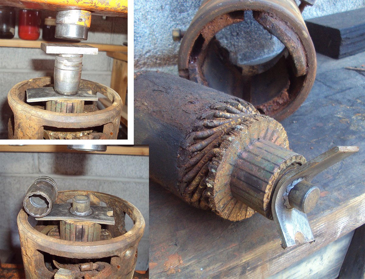

Correlations:
Very interesting!
Ignore this... On my front, there's been a lighting generator on this engine in the past also! Yet the late T genny mount holes do not line up to the mounting/adapter plate and fear I may have the uber-rare Robert Bosch lighting adapter yet no unobtanium generator to...
Interesting Mack truck details! Thank you!

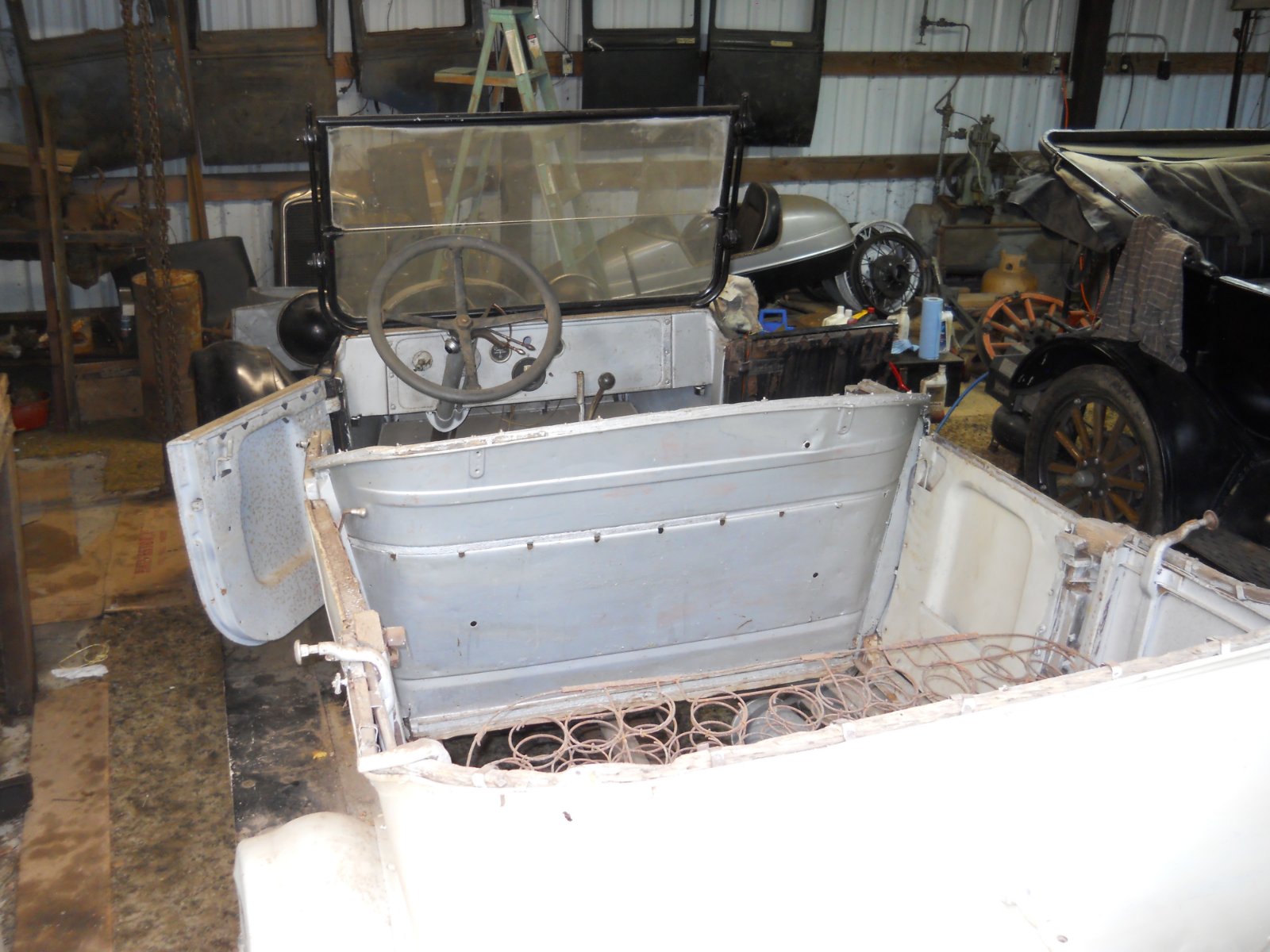

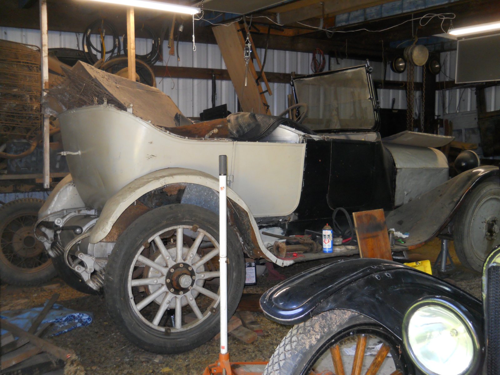

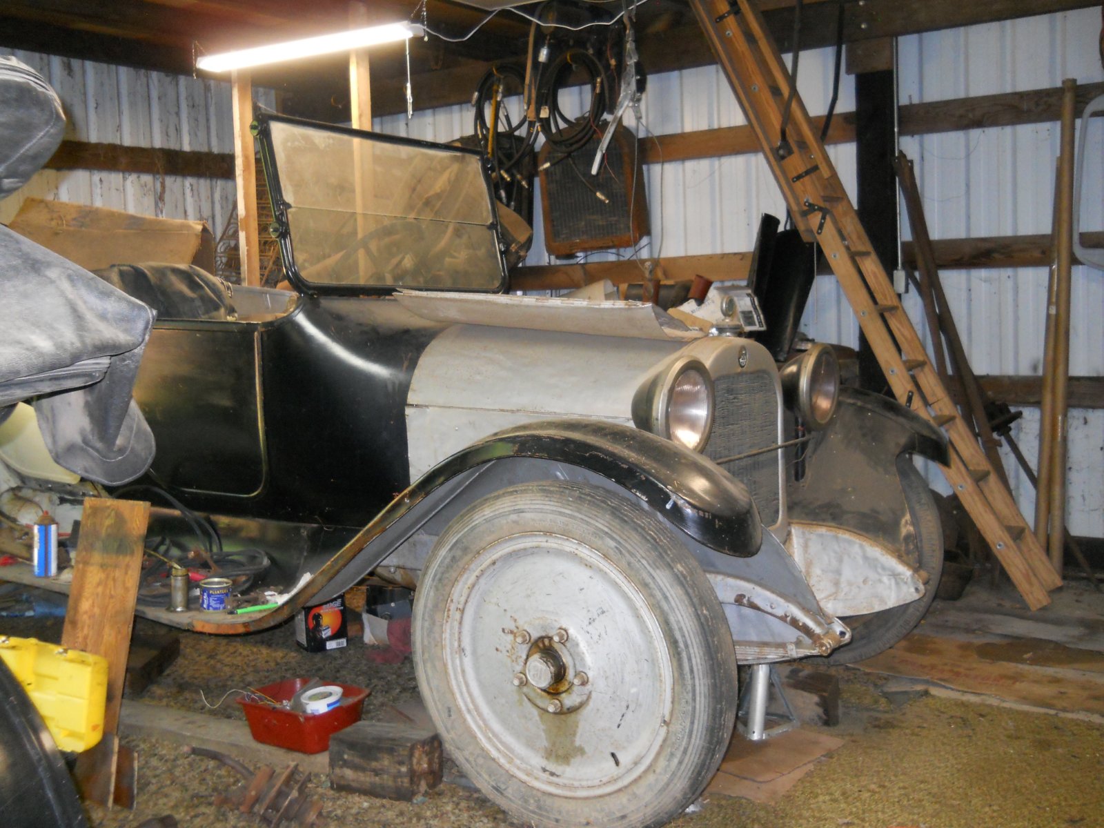

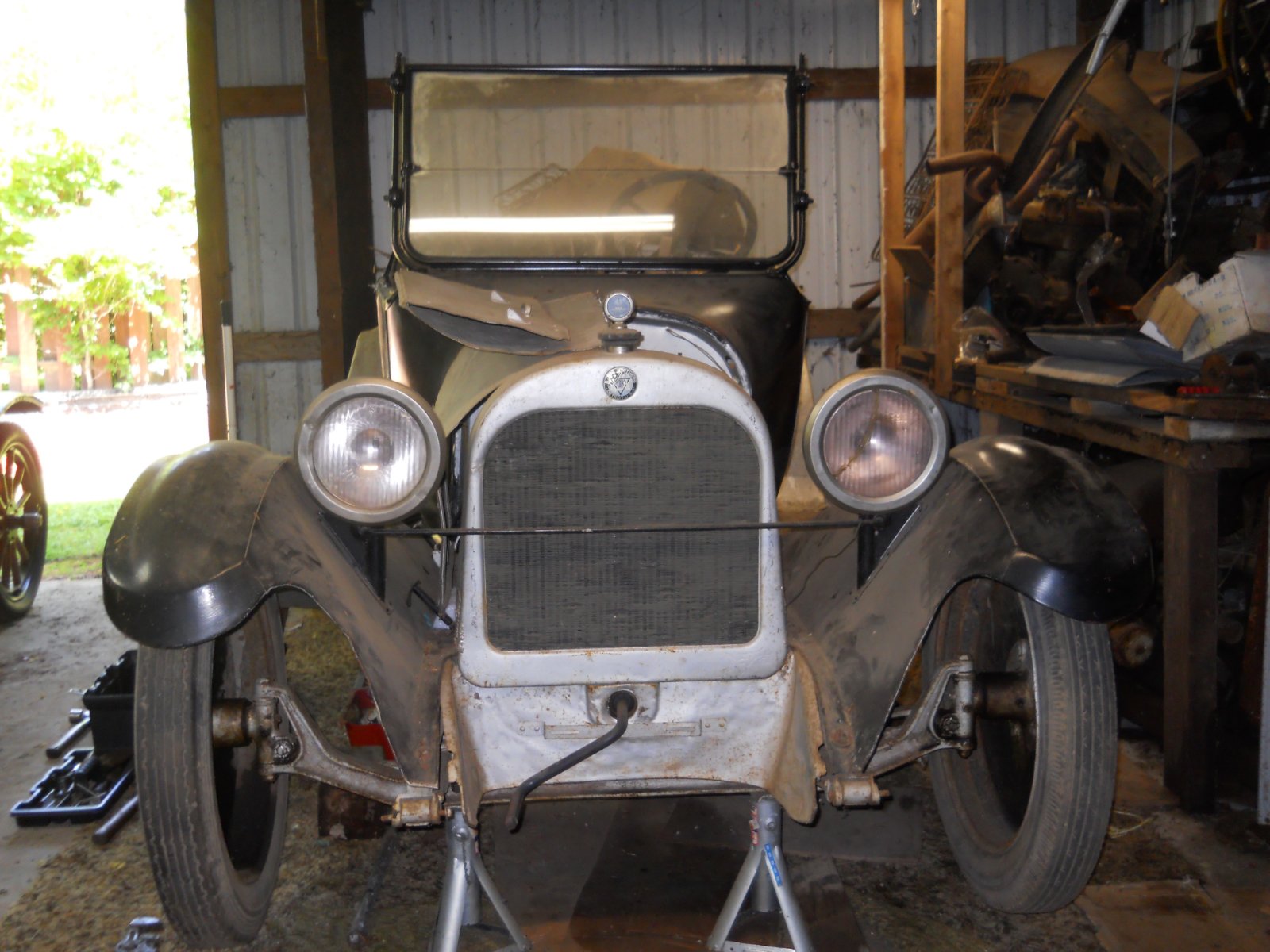

I love you guys sharing your projects , keep updating please. Rich, I went to an auction here in town and was thinking of you and your bike.
Topic author - Posts: 6895
That is a great looking '20. I wish mine were that far along. It also reminds me of our show last Summer. That is what I should be doing today.
Thanks for sharing those.

Well after working on this for so long, you really begin to question your sanity of starting on it. (Bought it 13 years ago Monday
And now it runs !
And now it runs !

That big 471 sure runs nice! Thanks Paul!
Like that ZF-4 mag too. Playing with U-4's and a ZR-4 out in the shop.

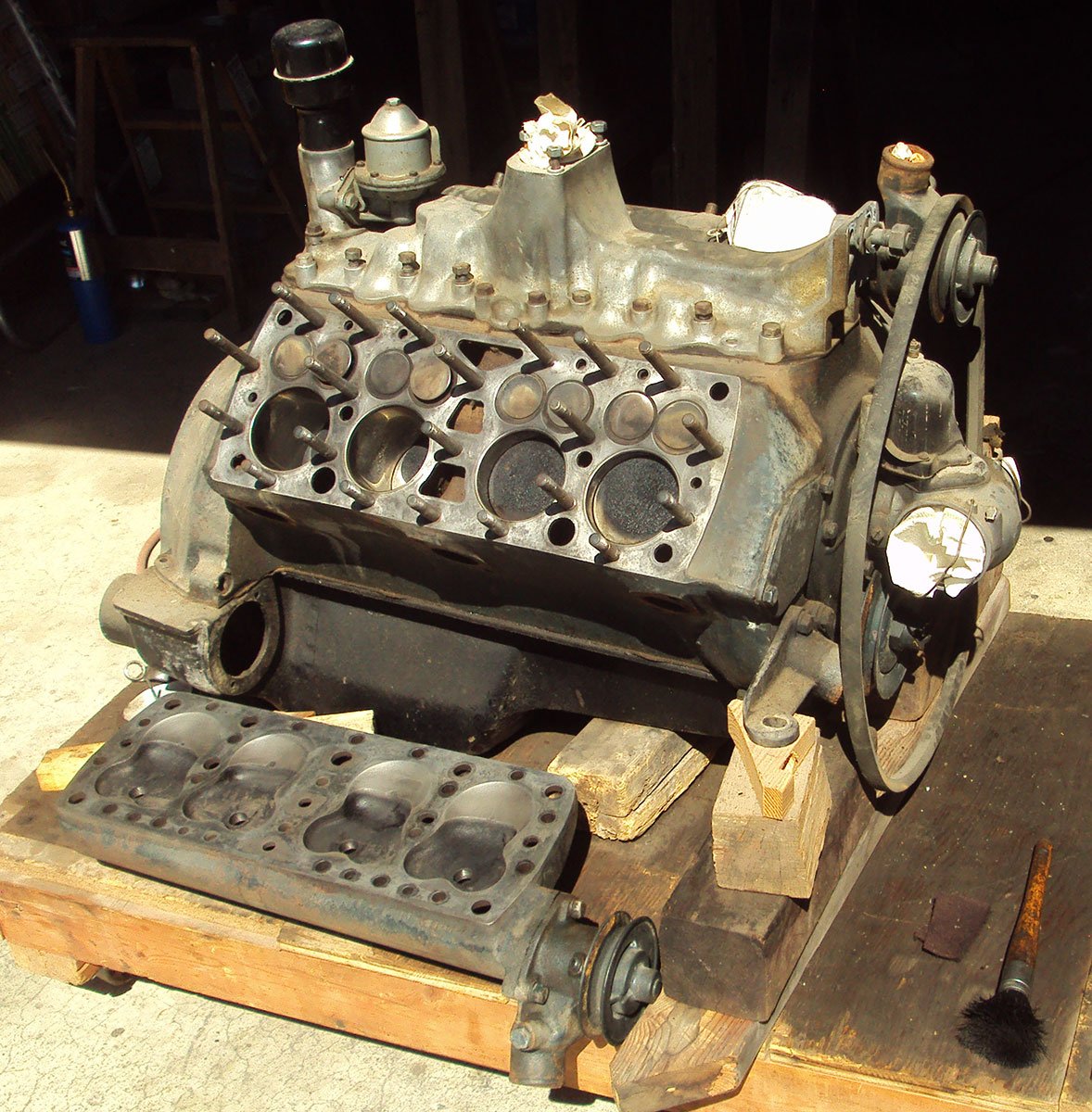

Just to keep the balance right in the universe I work on this Flathead a week or so every 4 or 5 years. I was given this '36 engine for my '35 Panel delivery a dozen or so years ago. The previous owner suggested I remove the heads to see if things were good inside. They were but the fiber gaskets needed to be scraped off before putting on new copper ones. Scraping around the 21 studs (42 altogether) kept me busy for 2 days. Maybe I'll get it in the chassis and running this Summer. (or nor)

I am kinda sidelining the Model T's for a while and taking on the task of getting this 1920 Dodge road worthy. Took me a better part of a day to work the multi plate clutch free. Got it running and have driven it a bit.

Better jump on that other head right away so you don’t forget how you did it !

There is something about working on a different project for a change. Like Mark's Dodge, the flathead Ford's quirks present some new challenges. I can return to the T's after a rest and a broader appreciation of them. A local guy bought a '23 Dodge after 50 years of Model 'A's. He went completely through it and decieded it was too slow and sold it. But the process was very good for him as a change and he's back to the Model A work now.
In the same vain I think it is healthy for the Model T Forum to have a "Time Out" section like this. I can't get excited about every subject but many do catch my imagination and enhance the pastime.
I've often questioned why this Forum is so successful. Certainly the moderators from Bruce to Chris and Jeff and their good choices have been one of the keys. The attitudes and energy participants put into this is extraordinary too. But beyond that I think the expertise of those who know Model T's and have other related interests adds much to the successfulness here
Somehow cleaning the transmission parts was terribly fulfilling. That was the next step and I was fortunate to find usable parts from the 2 transmissions I have. These sat out in the weather all these years and may in fact get tossed out when this car changes hands. Most of the interest I have had in this vehicle is from Hot Rodders who would put a more modern running gear in it. Ironically, those are the folks that I got the parts from.
For now it's just rewarding to be making some progress and enjoying the nice weather.

You probably already know this but Mac Van Pelt is the best resource on these transmissions in terms of parts, online reference, and even help on the phone. His self-published rebuild manual is excellent and saves a lot of missteps. Don't get your fingers pinched!:
http://www.vanpeltsales.com/FH_web/flat ... _trans.htm

Thanks Walter. I did look there. I have the "Green Book" and a Motors Manual that kept me from some of the trouble. The syncro and the second gear locking plunger would have been a disaster without them. Like the T you have to know some secrets.

I just text my Twin City tractor dealer/friend that I have more enjoyment ahead of me than I can shake a stick at.

After I got the information on where the engine number was (the guy that posted the info is from Australia and was posted between 11 and 12 our time) on one of the 3 spare engines I got with the car (along with a bunch of other parts) I was out in the ship at midnight looking for it. Found out it's Dec 1916 engine. Normally it's over the water inlet (wonder where they got that from?
), but the early engines was in a different location. Dodge used 3 point suspension for the engines, the front point being a ball shape that slides into the snout of the timing cover and pan and rides in a carrier on the front cross member.
The rear somewhat like the Model A. The engine less the bell housing and transmission are a big chunk of iron.

Now that’s nice.

How cool is that! Its come a long way! Great job on bringing back Mack!

Woohoo! Been waiting for an update Paul.

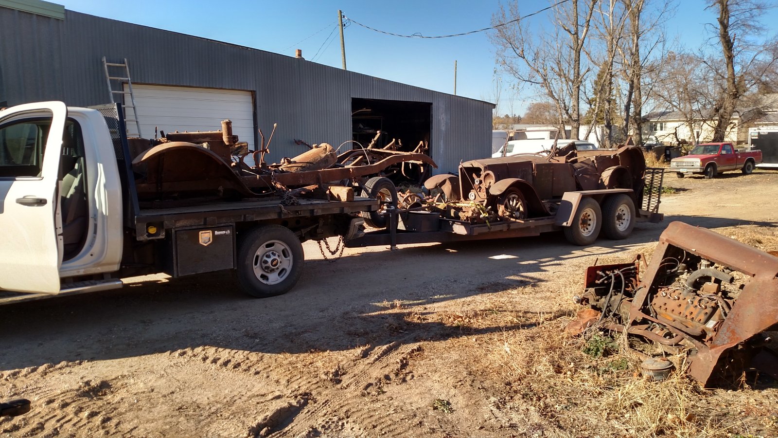

As found in the wild! 2016
Not really found but allowed to purchase. A pair of 1920 Cleveland six model forties. Both engines were rotted through the oil pans in the dirt. two more parts engines from 2 other states and four years and
I have a heartbeat! Overhead valve in 1920 wasn't that common.

How lucky are you? That is a great car. Have fun with it.
I hope to hear some more about it as time goes by.

Was the wire wheel in the foreground part of your haul? Are the other 3 hubs and wheel centers on the chassis? Acquiring a full set of hubs and wheel centers is 90% of the effort when it comes to converting a car to wire wheels. The rims are almost always toast, and don’t plan on using the spokes for anything more than patterns. If you have the hubs and centers, a set of wheels can be completed with ease

Funny! When I loaded this picture l actually thought of you because of the wheel in it! I'm pretty sure sure they survived. The owner is noKevin Pharis wrote: ↑Sun Jul 26, 2020 9:56 pmWas the wire wheel in the foreground part of your haul? Are the other 3 hubs and wheel centers on the chassis? Acquiring a full set of hubs and wheel centers is 90% of the effort when it comes to converting a car to wire wheels. The rims are almost always toast, and don’t plan on using the spokes for anything more than patterns. If you have the hubs and centers, a set of wheels can be completed with ease
Stranger to the site. He may chime in.

Looks like a Houk #5 wheel center and hub... the wheel center is not all that uncommon and of no particular value by itself, and an unidentified application hub has about equal value.
But if you have a car that you desired to convert to wire wheels... it is near unheard of to find a complete set of wheels and hubs that would directly mount to your specific application. So if that is a Cleveland chassis... you should keep an eye on it

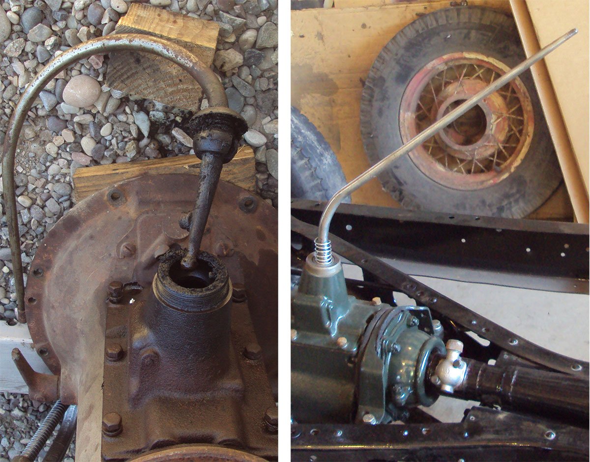

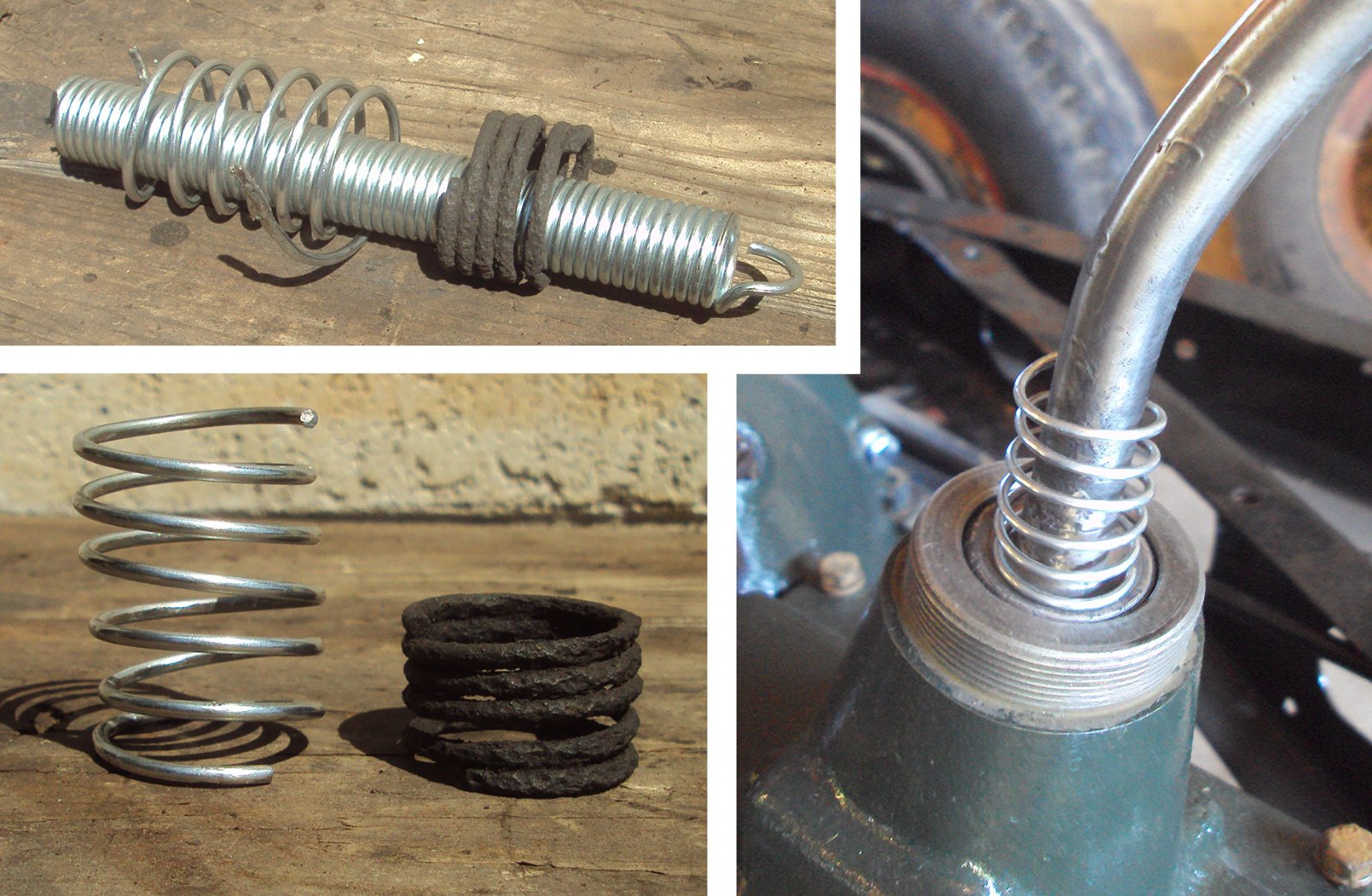

My gear shift lever spring for the '35 Ford had scummed to age and moisture. I'm sure I could buy a replacement or some spring that would work. Not wanting to leave the shop I thought I would see what I could devise. A few years ago I unwound a small coil spring with some pliers. It surprised me how easy it straightened out. I ended up making some odd shaped door springs for my Maxwell by doing that. The old spring was 1" O.D. I had an extension spring that was just a bit smaller wire diameter that the rust one. I thought it would be easy to enlarge it's 9/16" O.D. to 1" buy pressing it down a mandrel. It was not having any of that. After a couple of hours of trying to twist and turn in a dozen different ways I decided it wasn't going to happen. But grabbing one end with the spring around a shaft in the vise I was able to pull it out of it's coil into a not straight but a 4" circle. Then I rewound it around a 3/4" shaft. I wrapped it tight and it rebounded to about 1". The coils were not evenly spaced but I could fiddle around bending them so they came close to being equal. I would guess the spring looses some of it's properties by stressing it that way but it has ample tension to do what it needs to do. I was pleased I had kept at it.
Most of the work on the '35 trans and my "soaked" T trans has been mundane cleaning which has not been worth mentioning here. This however was something I thought was more interesting and perhaps useful to those who haven't tried it. Anything over 5/64ths wire diameter might be quite a challenge.
Also shown is my attempt to restore a badly bend up gear shift lever to somewhere close to original.

Rich,
I am wondering how you can still get your lever up ? Did you use just heat?

Ya, I'm getting old but I can still do a few things.
I straightened the upper 3/4 in a press but had to heat the lower part. It had been bent off to the left so I had to straighten it out and then put the bend back in the right direction.

I’ve seen shift levers bent like that before on transmissions used when converting old belt driven machinery to electric motor powered. The electric motor and automotive transmission would be high mounted, and the shift lever twisted down so one could reach it

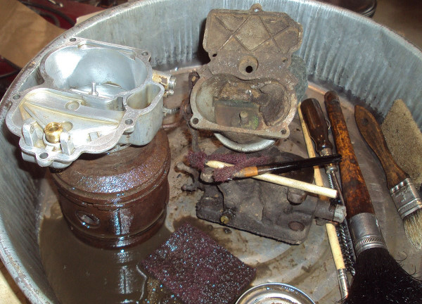

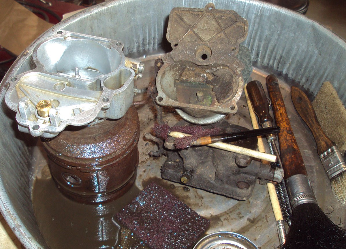

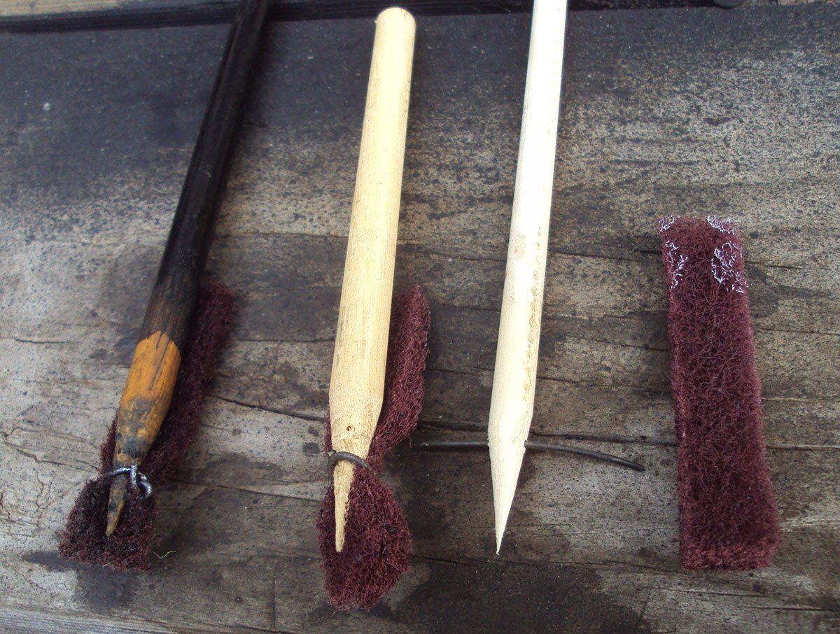

Trying to get into corners to clean can be difficult. Today I wired some Scotch-brite strips to some sharpened dowels. They allowed me to get where my fingers aren't sharp enough. I'll have to try it on brass next time.
The old 'T' piston gets the part up a bit and the rust/carbon is a good surface to work on.
Perhaps others will find these useful.

I wanted to clean up a spare generator for the '35. It was reluctant to come apart. After soaking it with penetrating oil and then soaking it in water it was still stuck. I thought maybe a gentle nudge in the press might push the armature through the case. I used some steel and a socket for spacers and put some pressure on. With no results I finally put all 12 tons to it. Still no movement. I added a little pressure each day and finally used a longer jack handle. I expected a BANG! if it ever let loose, but didn't expect the armature shaft to penetrate the 1/8" steel into the socket.
At this point the armature was showing some movement and did come out of it's shell. My next task is to remove the punctured plate from the shaft. The parts may clean up and work. Or not.
I thought some of you might enjoy this as it isn't that common at my shop.

That was really stuck!

It really was stuck Mark. That was last September.

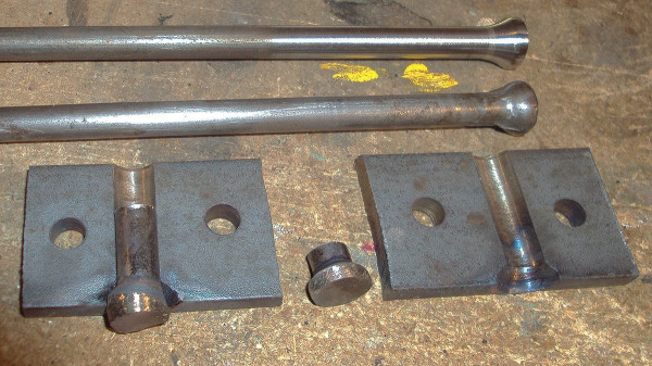

Fast forward to April. The nice weather plus a guy wanting me to sell him the Panel got me out and working on the brakes. I have nearly all the parts for the mechanical brakes. Yes I know they are horrible.
I was missing one front operating pin (rod). These have one cupped end. I tried to mush the end of a steel rod to make the cup with poor results. It would mush to one side as it was difficult to get the heat low in the drilled plates. My second plan was to silver solder some nuts to a threaded rod end. By adding flux to the threads as I screwed the nut on and putting a ring of silver solder around the rod I could hang the rod and heat the bottom end. You can see the silver solder came out that end so it flowed down the threads. Then I simply machined the cup to size. This would be a good technique for making bolts. Heavy or thick nuts would work for bolts that aren't available.

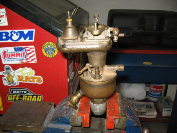

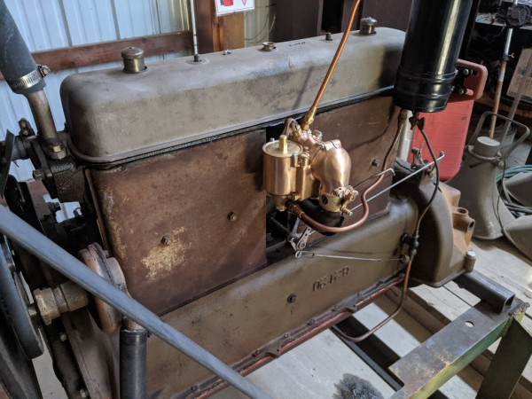

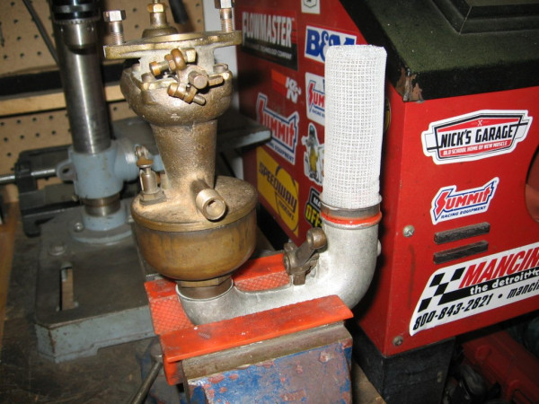

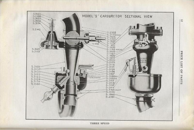

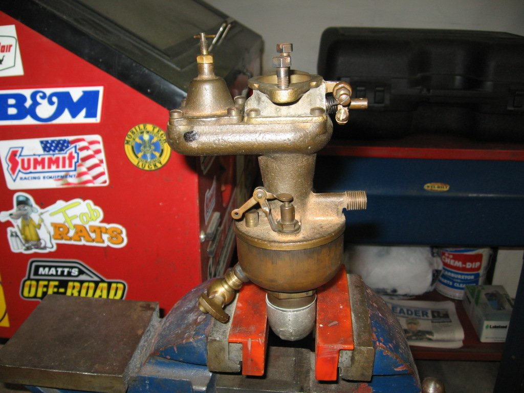

My Cleveland got it's original carb reinstalled. Some sketchy guy in Montana who will go unnamed rebuilt it.

Sketchy guy in Montana? I thought Richard Eagle lived in Idaho.
Any how I like both of them guys.

The guy in Montana knows a heck of a lot more about carburetors than I do.

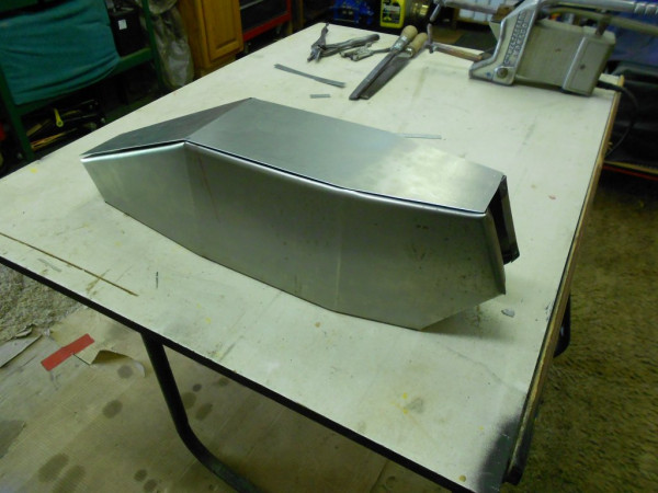

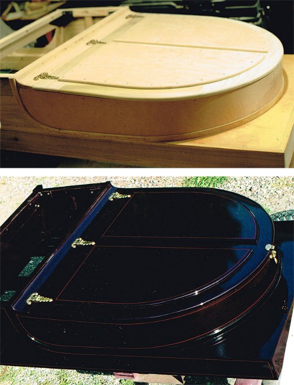

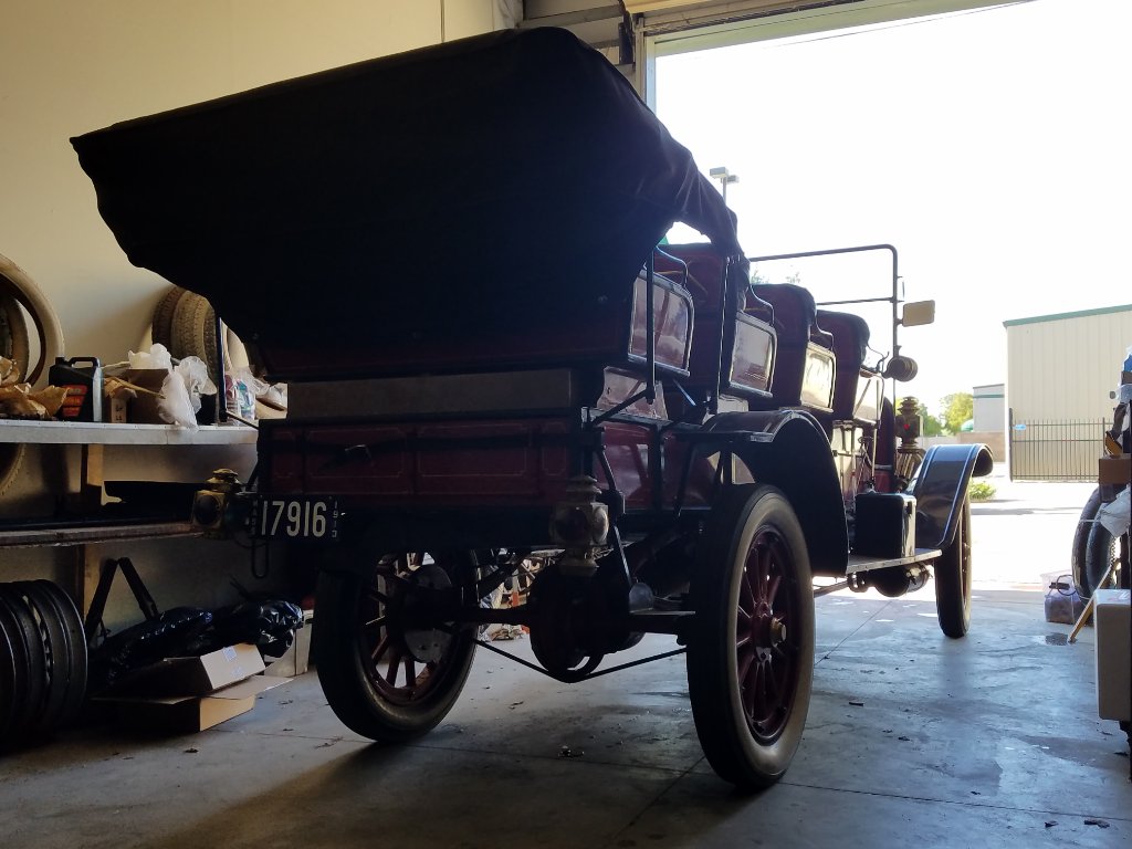

I found these pictures today. The Buick didn't have it's turtle deck when I got it. Therefore there was no hardware for it. A fellow in El Cajon was kind enough to take one of his hinges off and put it on a copy machine. Some of you may remember Jack Garrison. I was able to trace them out on sheet and make the three I needed for mine. The latch I made from looking at pictures. It is very close proportionately but I think a little large or out of scale. I think the hinges are a little fancy for a car but were probably standard hardware at the time. I have found similar versions of both the hinge and latch but not exact or the same size.

How do you keep the carb clean after polishing it ?

What a workhorse ! Very nice.

My non Ford vehicle project was a bicycle. A friend gave me a 1950's J C Higgins sears bike to play with. I rebuilt it into a fun look alike toy I have always wanted but out of my league. Les

Re: Exhaust manifolds burning out with that "alligator hide" look: I I used to see some of that on fairly clean vehicles. I assumed it was caused by lean burn emissions settings and AIR injection reactors. I think that may be a factor, but I notice some people had similar failures with earlier vehicles which did not have the emissions equipment, but had restricted exhaust problems that led to burned out manifolds. I recall that around that era, late 60s/early '70s, some Chevrolet vehicles, and probably other GM, had a double layered exhaust header pipe from the manifold(s) to the muffler or Y junction. In some cases, the inner pipe layer would erode or corrode and somehow get wadded up inside the outer layer of the pipe causing severe restriction in a pipe that looked perfectly good on the outside. That could explain some of the burned out manifold issues.

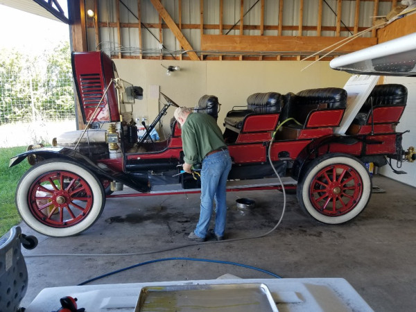

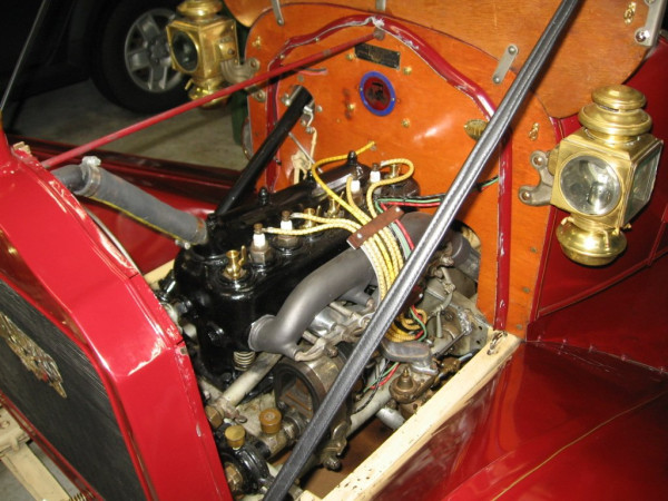

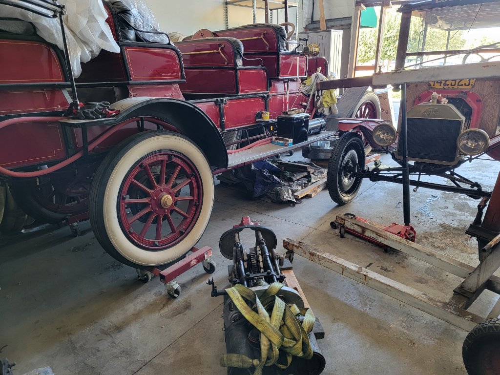

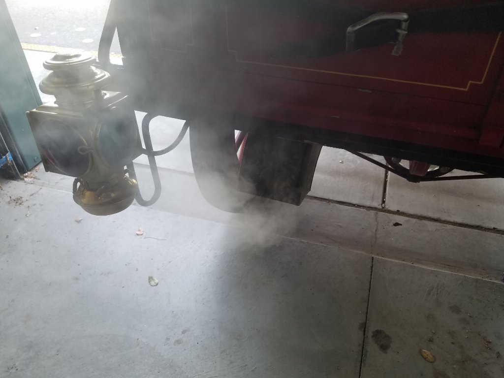

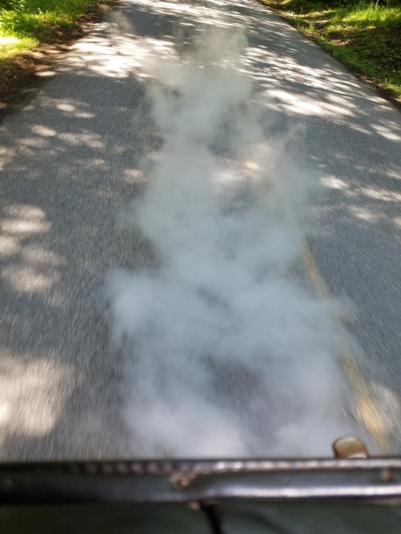

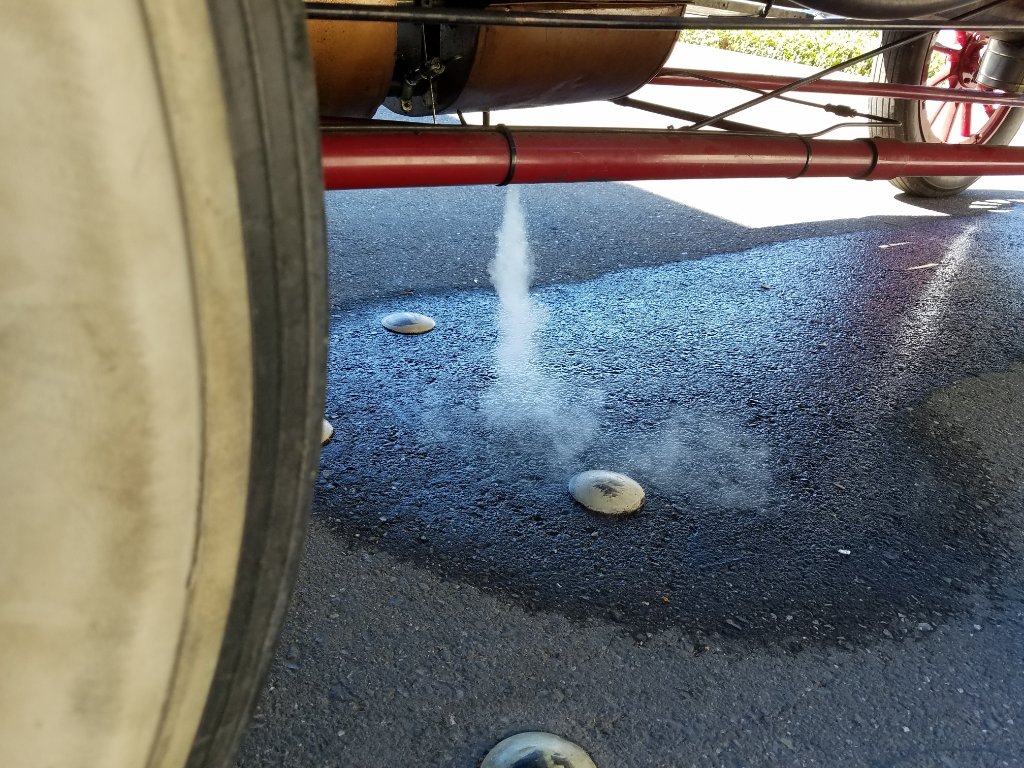

Dividing time between the Mountain Wagon and the Stanley sedan, but getting the engine back in the Mountain Wagon is getting to be a real priority

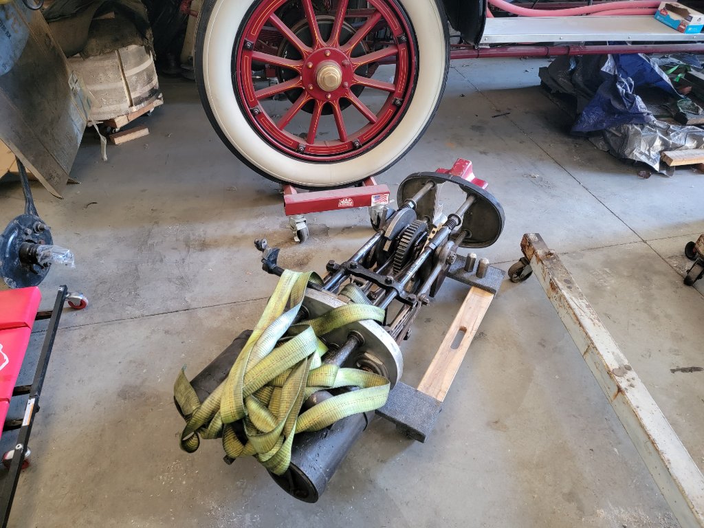

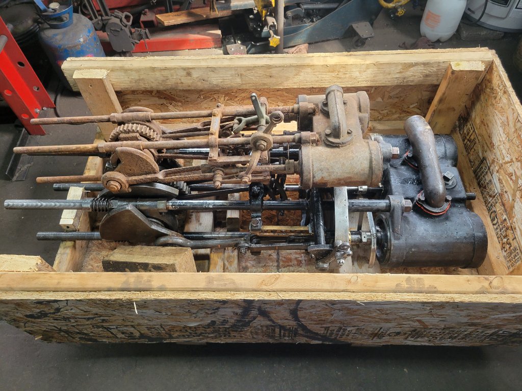

Dan - how about a little education on that engine ? Is that first pic 2 - 2 cylinder engines, with external cranks ?

Stanley steam enmgines....

The photo with the little rusty engine was staged by a friend; he placed his little 10 hp Stanley engine on the big 30 hp engine - we named them "Baby Bear" and "Papa Bear". The 30 hp engine was briefly passing through his garage in Pennsylvania on its way to the west coast and he wanted to take the opportunity to compare the two size extremes. The 20 hp size is, not surprisingly, half way between those two sizes. The big engine really is a moose. In my younger days I could lift a 20 hp engine, there's no way I can lift this 30.

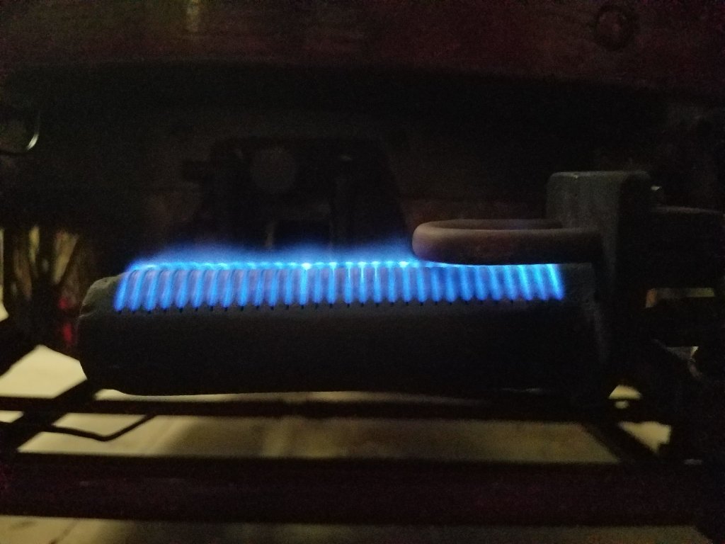

I know it's not much, but this is the sight when the car is steaming up. I don't have video I can post of it running.

playing with the pilot light, turned low and turned high

Dan - thanks for that. Way cool !
Don’t know that I fully understand your description, but understand your process building up steam.
That is a neat machine. Great that you’re keeping it operational !
A friend came over yesterday, our intention was to add gas, fix any fuel line leaks, and then try to start my 1912 Flanders 20 for the first time since I bought it. We didn't get very far - there are no leaks in the fuel line, but the OEM Flanders carb floods horribly. We took the carb apart to check the float action and level. The OEM cork float and needle appeared to move freely and the needle seals well against its seat (at least when doing the sucking on the fuel inlet test). We lowered the float level as far as we could while still allowing enough float travel to let the needle lift off the seat and reassembled the carb - no improvement. When I tried pushing on the float "tickler", it didn't feel like there was any resistance - the float wasn't pushing up against the tickler plunger when there was fuel in the bowl.
My current theory is that the float is rubbing/jamming against the inside of the float bowl, preventing it from rising and pushing the needle onto its seat. I'm going to disassemble the carb again and try to simulate the presence of the float bowl with some flexible plastic so that I can see if the float is getting jammed up when the float bowl is on. If it is, I'll sand the OD of the float down for clearance, then re-seal it with hot fuel-proof dope.
